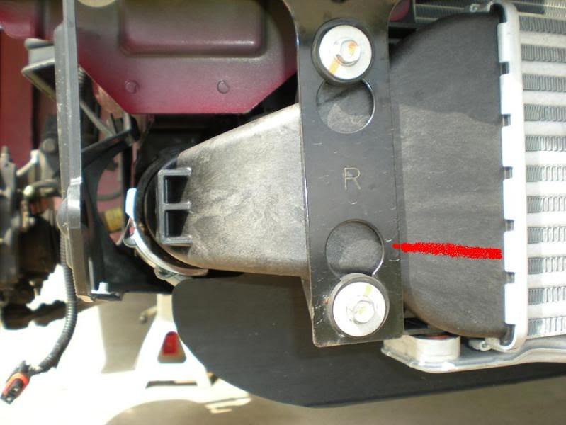

Originally Posted by Jbartock
ZZP is out till September??? I've been trying to get an answer from them over the last few days bc I've also just gone through the same problems.. I was sure it was cracked IC (stock ic) so while making the boost leak tester buddy was removing bumper and sure enough nice long hairline crack.. Want ZZP but they told you September I might just order different one now.. What you guys think best substitution?
Was it right about here?
crack was passanger side but high. From right to left of the upper bracket hole u see

Originally Posted by sprchrgdss
does a cracked ic really cause a maf code?
Yes, because of all the unmetered air being sucked in on the other side of the MAF.
