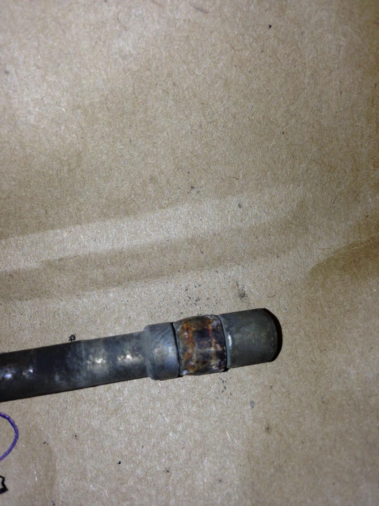

speaking of pins getting stuck
tese were my pins after just 35000 kilometers, they were just starting to rust, luckily i pulled them out just to lube them and shoved them back in. so lube those babies up
When you lube them. Don't use brake lube for the sliders. Use anti-seize. It will last much longer and prevent the pins from getting stuck. I pull my pins twice a year to clean and re-lube them.

use high temp anti seize
