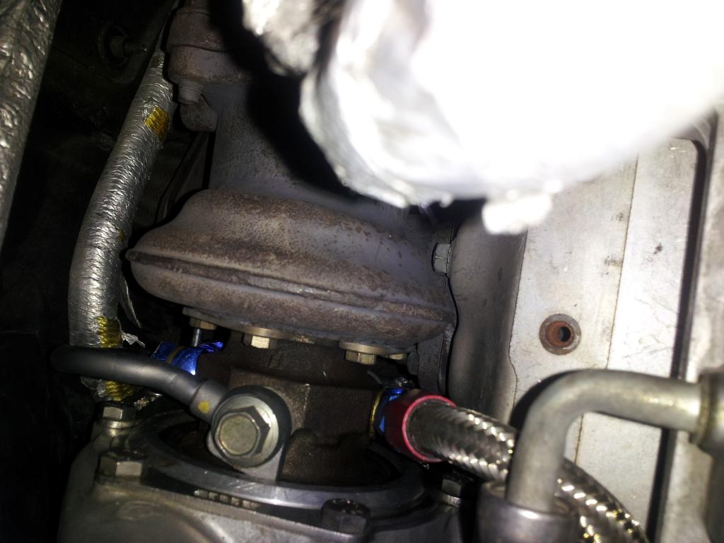

Originally Posted by Frogstofall
Maybe Cubaniche can post the info I sent him about making your own lines. The coolant lines are M14 x 1.5 banjo but the oil feed is some other thread pitch and I can't remember what.
DONE, thank to the info you sent me
Here we go:
Oil feed, I used these from Treadstone:
Line - I got the 36in 3AN version as this is what Bryan at BNR suggested so you dont flood the turbo with oil. This is a kit as Treadstone doesnt have the line on its own on the site and I never asked them to sell me the line alone...but you could ask them and see what they say.
Turbo Oil supply Feed Line- TREADSTONE PERFORMANCE
Banjo fittings - I got two of these in the 14mm size. They only offer a 3AN right now but just make sure that this is what you are getting when you order. If they start offering a 4AN version and thats what you get, it will not match the line hookup. You dont need new banjo bolts as the stock one on the block and the one BNR send with the turbo both fit perfectly in these bajo fittings from Treadstone.
Banjo Oil Feed Fitting - TREADSTONE PERFORMANCE
Ok, the water lines. Those were a bit more tricky:
I purchased these banjos w/bolt for the in/out water ports on the turbo itself. You want the 14mm fitting AND bolt. You need both as they fit perfectly on the turbo. The 17* angle was perfect for lifting the line away from the turbo so you can screw on the fitting that is on the line you will build.
Banjo 14mm Water Feed Fitting -6AN 17 degree- TREADSTONE PERFORMANCE
Water lines, continued. Now that you have the fittings for the turbo side of things you still need to make the lines themselves along as purchase a new banjo fitting and bolt for the line that comes from the engine block to turbo.
This is the banjo and bolt needed for the engine block feed:
Unisteer 8021550 UniSteer Banjo Fittings
Next you need the actual line and the fittings for the lines that screw onto the banjo fittings on the turbo. To make it work you need four of these:
JEGS Performance Products 100001 JEGS AN Hose End Fittings - Blue/Red
And the line:
JEGS Performance Products 100911 JEGS Pro-Flo 200 Series Braided Hose
I was able to get it done with the 6ft length even with an error in a cut and having to cut another piece off it was enough, but you may want a 8 or 10ft length just in case.
The last fitting you need, well that I did, based on what frogstofall had already done(you may choose to do it differently) is this hose fitting:
JEGS Performance Products 100581 JEGS AN Male to Hose Barb Adapters
This fitting will go into the hose that is connected to the hard line that comes from the front of the engine and around the side, where the intake is, that then connects to the turbo. this fitting slides into the stock hose and the other end will screw onto the line you just made to goes to the turbo. This replaces the hard line that goes from the rubber hose to the turbo.
This is a lot of info, but I hope you guys are able to follow
Here are a few pics. Disregard the hard line for the oil feed. The oil line was taking too long and I really really wanted to put the car back together. It was a bitch to replace the line afterwards cause the oil feedfrom the block is right under the exhaust mani. Here you go:
Pic of the new banjo bolt and fitting on the block for the water feed:
The water return line from turbo to hose:
What it looks like with the new fittings on the water inlet/outlet
