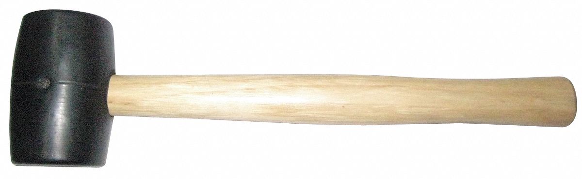

Old Oct 15, 2012 | 06:44 PM
chris88z24's Avatar
Joined: 06-03-07
Posts: 14,142
Likes: 71
From: NY
Old Oct 15, 2012 | 06:48 PM
09CobaltSS1's Avatar
Joined: 04-12-09
Posts: 4,869
Likes: 16
From: Connecticut
^^Who's the unfortunate soul who gets to precariously hold the breaker bar with a 10" extention and swivle head while your half in the bag buddy who you paid in beers swings a hail marry with a mallet?
