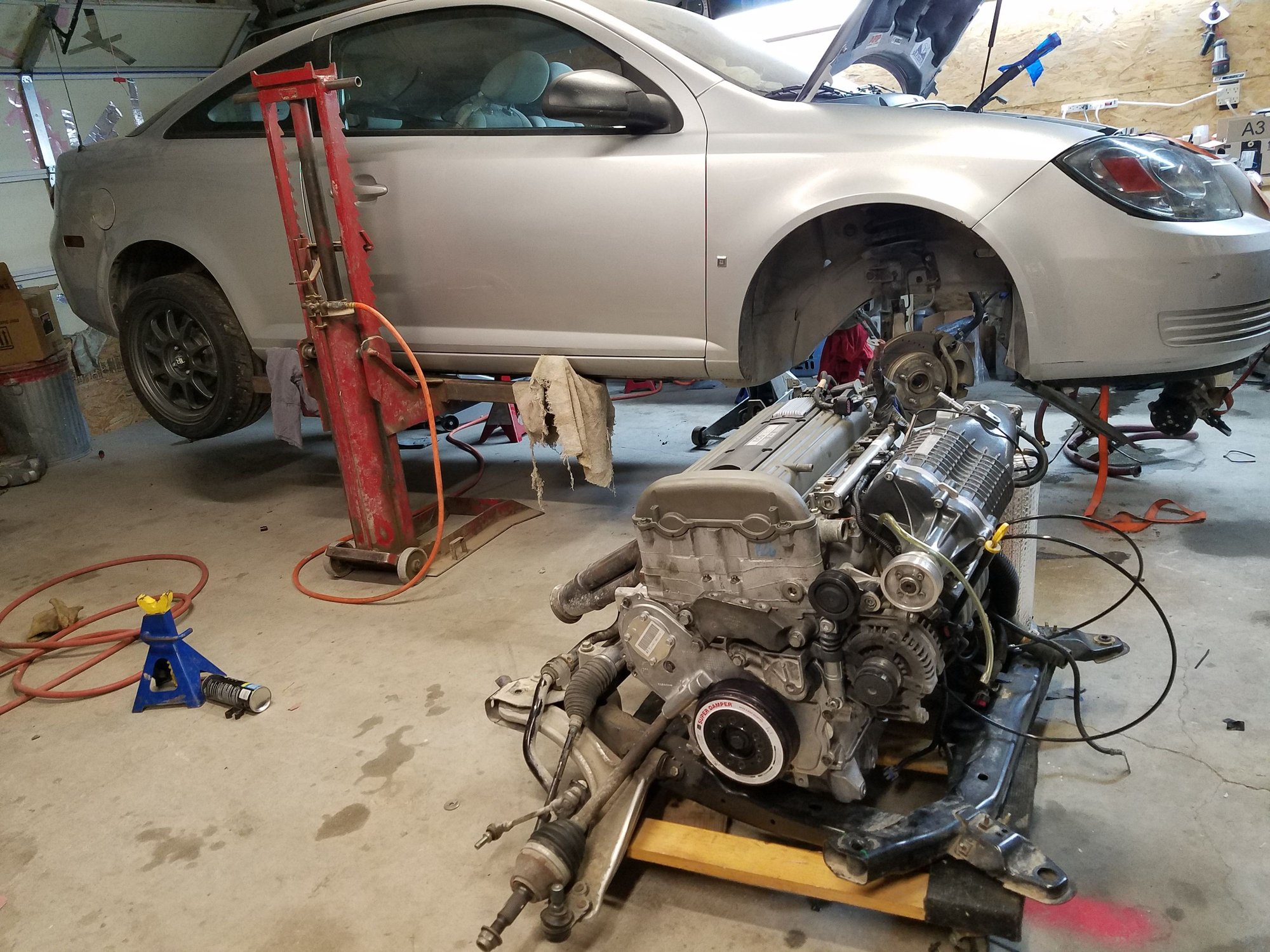

Any easier pulling out the top or should I drop the k member. I have no lift.
Old Sep 6, 2017 | 12:28 PM
exninja's Avatar
Joined: 02-20-09
Posts: 6,268
Likes: 419
From: UT
Some say the top is easier but I think they're loco. Put the rear wheels up on other wheels (4-6" extra lift), then lift the body from around the center over the engine. Worked great for me.
Old Sep 6, 2017 | 12:30 PM
jdbaugh1's Avatar
Joined: 02-03-16
Posts: 6,435
Likes: 358
From: Kansas
I think it is easier to drop from the bottom because you can leave most of it together and remove all of the components once it is out in the open and easy to work on.
