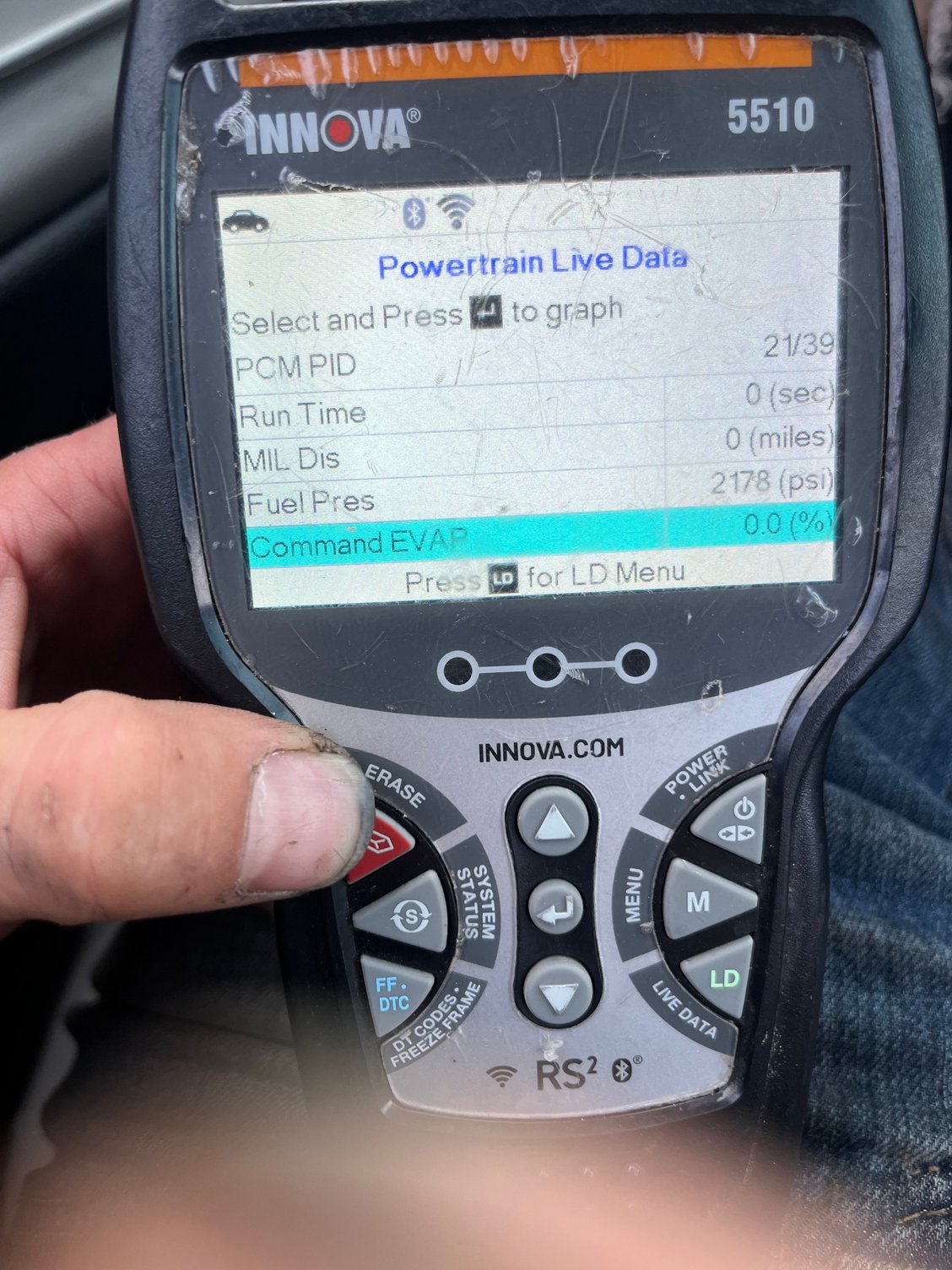

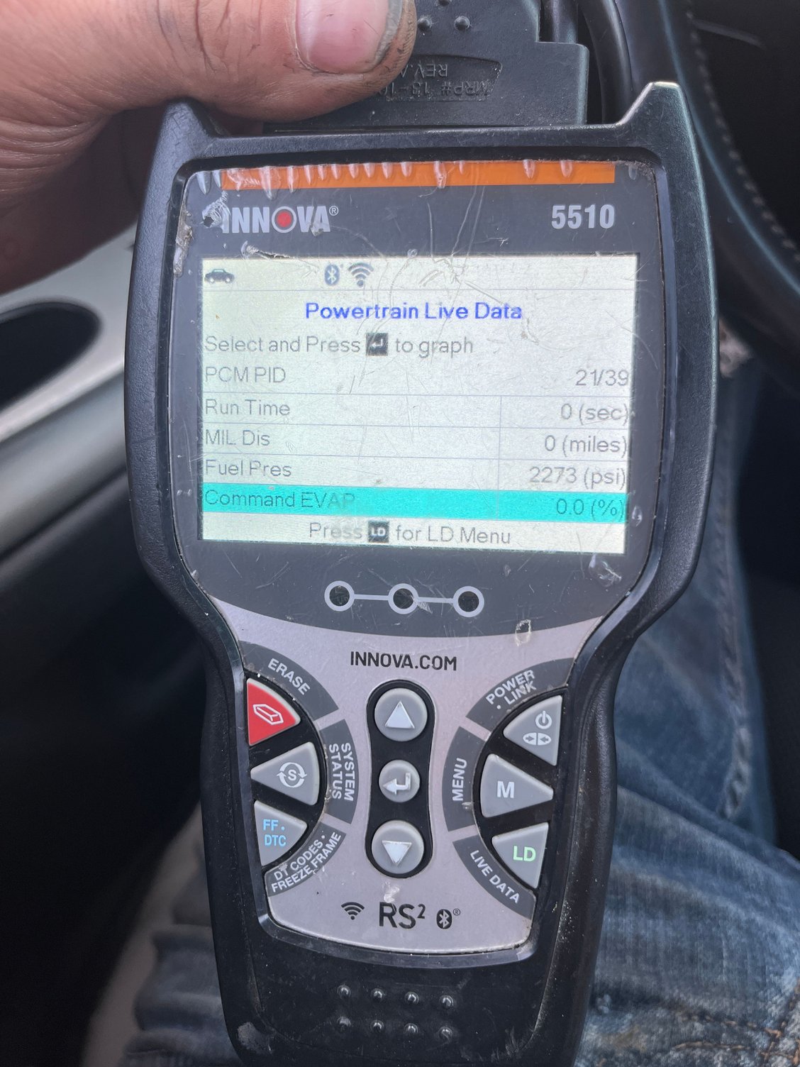

I did have the scanner hooked up after the oil change watching live data. I’m pretty sure it’s something in the hpfp. I let the car warm up and cleared the computer and at idle the fuel trims looked great. Took it for a short drive and short term and long term both went negative hard. I shut the car off and let it sit for ten minutes. Turned the key in the on position to see what the fuel pressure is. I don’t think it should be reading over 2,000 psi with with a he engine off and key in the on position I watched the pressure climb a little over 2,300 psi

It climbing fairly high on shutoff when warm is pretty normal, all the heat of the cylinder is running back into the injector and fuel rail which will put alot of pressure into the rail. What is your fuel rail pressure at idle? it should be between 500 and 800 usually depending on how warm it is. Sometimes ive seen 450s to 850s pop up and be normal. HPFP from gm isn't super cheap but id personally get it from rock auto or zzp if I didn't already work at a dealer. You can get one from zzp for 200 or get a bosch one off of rockauto for 175 plus shipping, thats who makes the pump for gm. Depending on how many miles you got, id grab a roller too. I came up with 235 tax and shipping for the pump and roller off rockauto.
