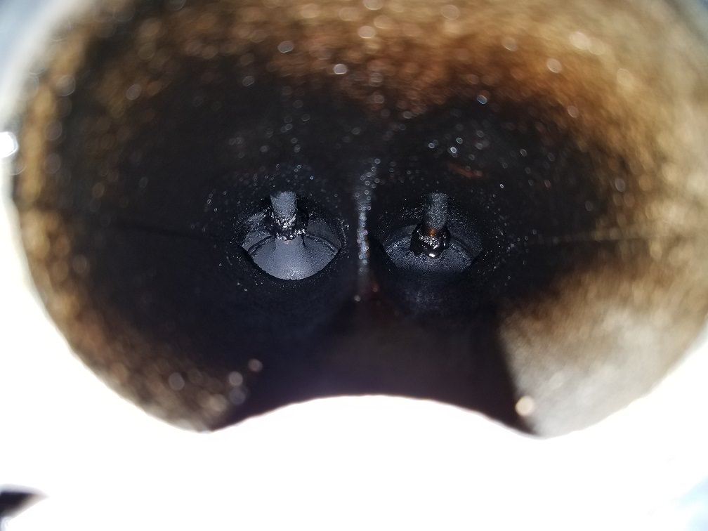

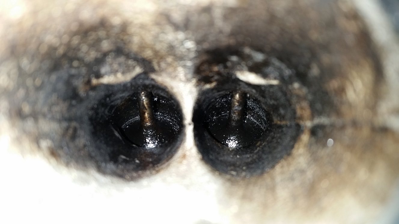

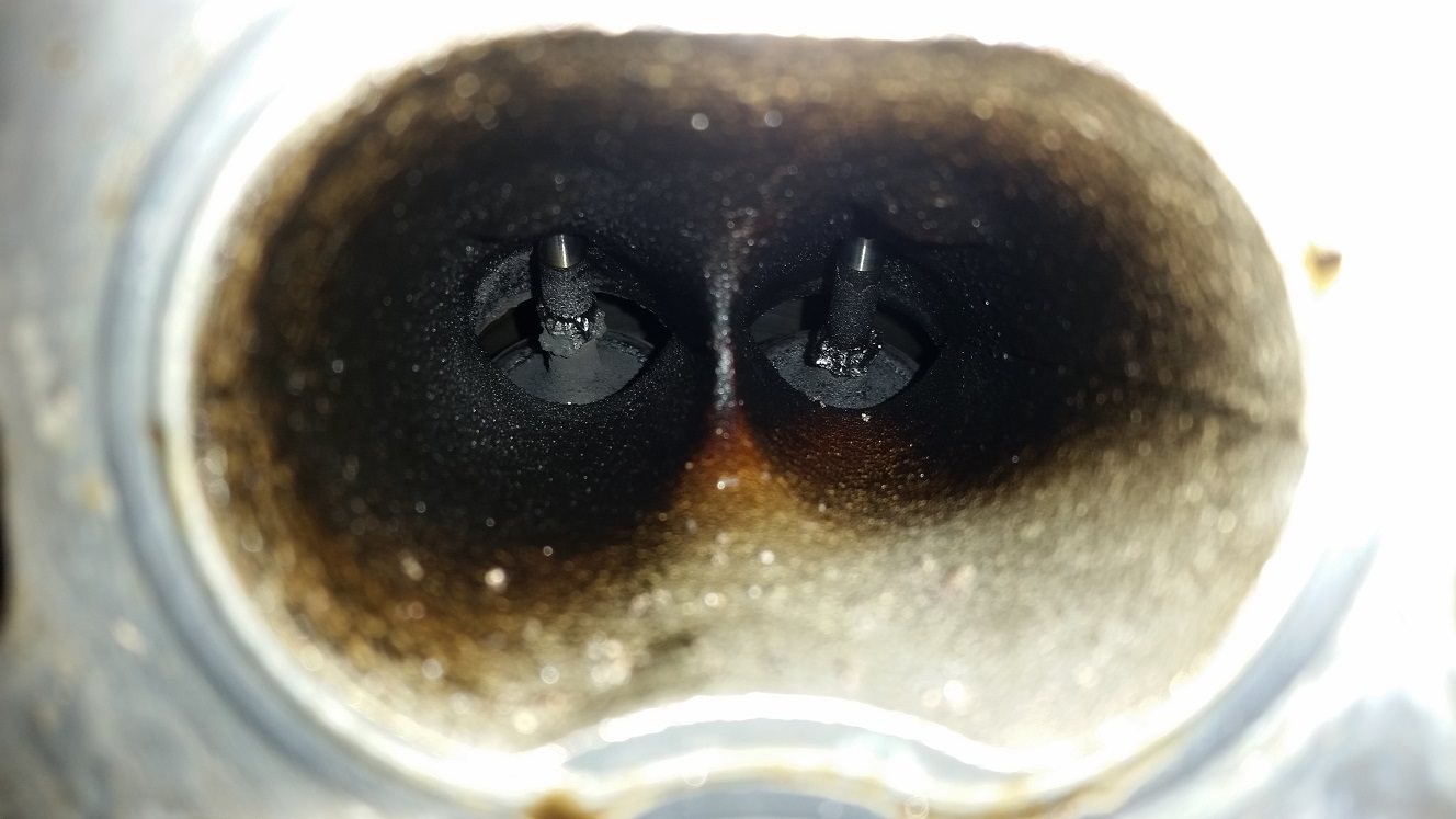

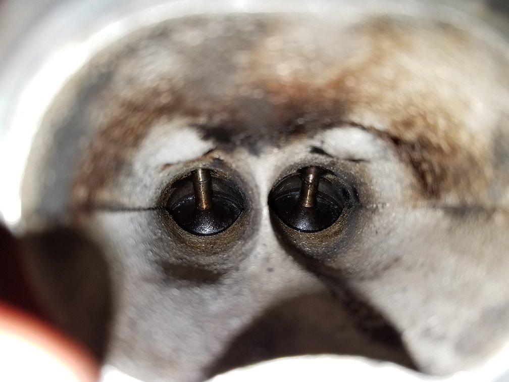

At about 95,300 miles now and time to clean the valves again. I'll repost original images in the thread since the links are no good.
When I first took on the valves at 72,818 miles. 53k had no air/oil separator and the rest was with Powell's version 2 (no PCV mod)
My lousy attempt at cleaning
What they look like after 23k more miles
My better attempt at cleaning
Haven't driven it yet. I'll put it back together tomorrow. I used carburetor cleaner this time with picks and cotton swabs. The carb cleaner melted the carbon off. I didn't let the ports soak extremely long, maybe 5 minutes each time. I soaked them at least 3-4 times. I'm happy I got them this clean, but I'm disturbed by how much oil has accumulated even with the air/oil separator. I got cylinder 4 misfires the other morning with high RPM high load. The spark plug looked great and I think this carbon was the reason. It was bad on that cylinder, too. I'll upgrade to Powell's newest version of the air/oil separator if it'll prevent this. It's saddening to have this as regular maintenance.
