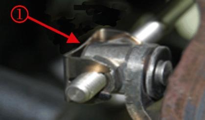

This is GMs remedy for wastegate coming loose. All new k04 turbos now come with this retaining clip. The wastegate system on the EFR looks pretty much identical to the k04I think you can get the kit from gm. The kit # is WPC562. It is related to TSB# pip4820.
Hmmm, interesting. I'll look into getting that clip but that is not where my wastgate came loose. It was from the other end that connects to the Compressor housing. I'm going to take a pic for before taking care of it.
Interesting...Wonder if there is a torque spec for those bolts.
@ Fastgti, I have a 2010 model that was built in late 09 and it didn't have the clip. I just had the turbo replaced under warranty last week and it came with the clip already installed. Nuts came loose on my original turbo and I just ended up using locktite and "double-nutted" it lol
