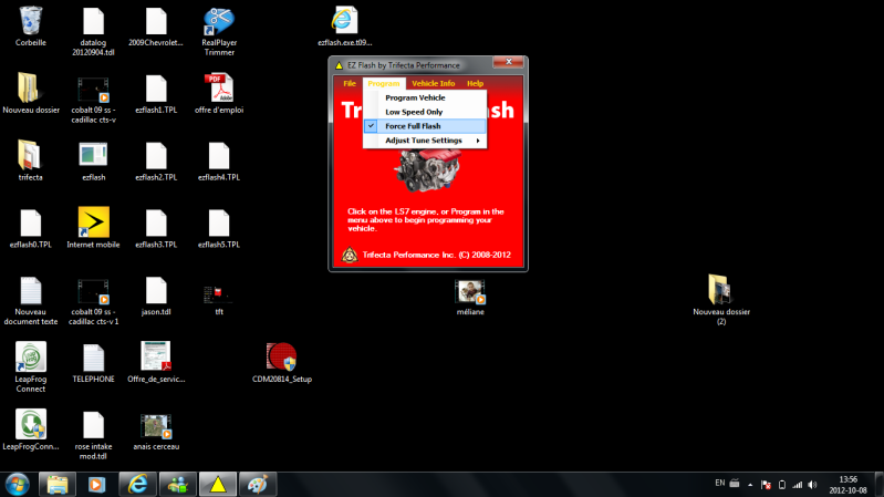

do you have your TFT file (TRT). you have stock and custom tune on this file
open ezcable
select prgramm/ force full flash
open ezcable
yes i have this im going to flash it in the morning before dropping it off, and im going with a local tuner here on long island, uses hpt and tunes everything under the sun ( even travels around the world to tune ) but im pretty sure he never tuned a sstc, but has tuned turdo lsj's, so after seeing his results from other cars im interested to see what he can do with my car
