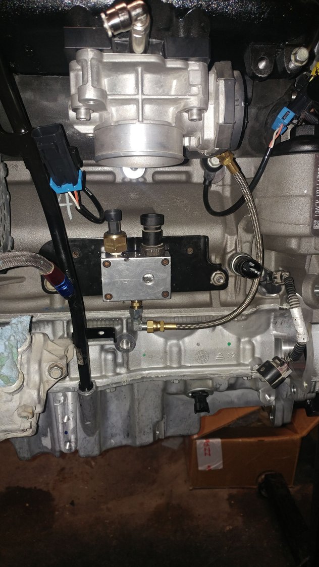

Here is what I did
Just need a few things to make it clean. Smaller line, oil galley fitting from zzp that goes to an4 love it

Ah! Thank you for the visual Tom and cw for the explanation. I was wondering this myself, makes a lot of sense now that I actually see it. Need to do the same myself at some point. Wish I'd of done so prior to installing the motor.
