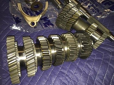

I'm really anxious to build one of those F35 quaife 6 speed kits, fit with a brace you can't go wrong. 2800 is a bit steep but you get the entire gearset all brand new. The gears are much more of a strait cut design too with huge teeth and Quaife quality. Sad thing is, if the first batch would've sold a bunch, I'm sure we would have more decisions on specific ratios and possibly dog gears but I digress.
63nova, the quaife 6 speed conversion has the best 1st gear ratio on the market for the F35. Runs out even further than the F40 depending on the gear ratio used. I don't understand why you wouldn't want to save your pennies for this work of art.
The only thing I don't like about it is the ratios are indeed really really close after 2nd gear I believe. But this is another reason it's a better design because Quaife achieved similar top speed(compared to f35) but with 6 gears so each gear endures less load relatively.
