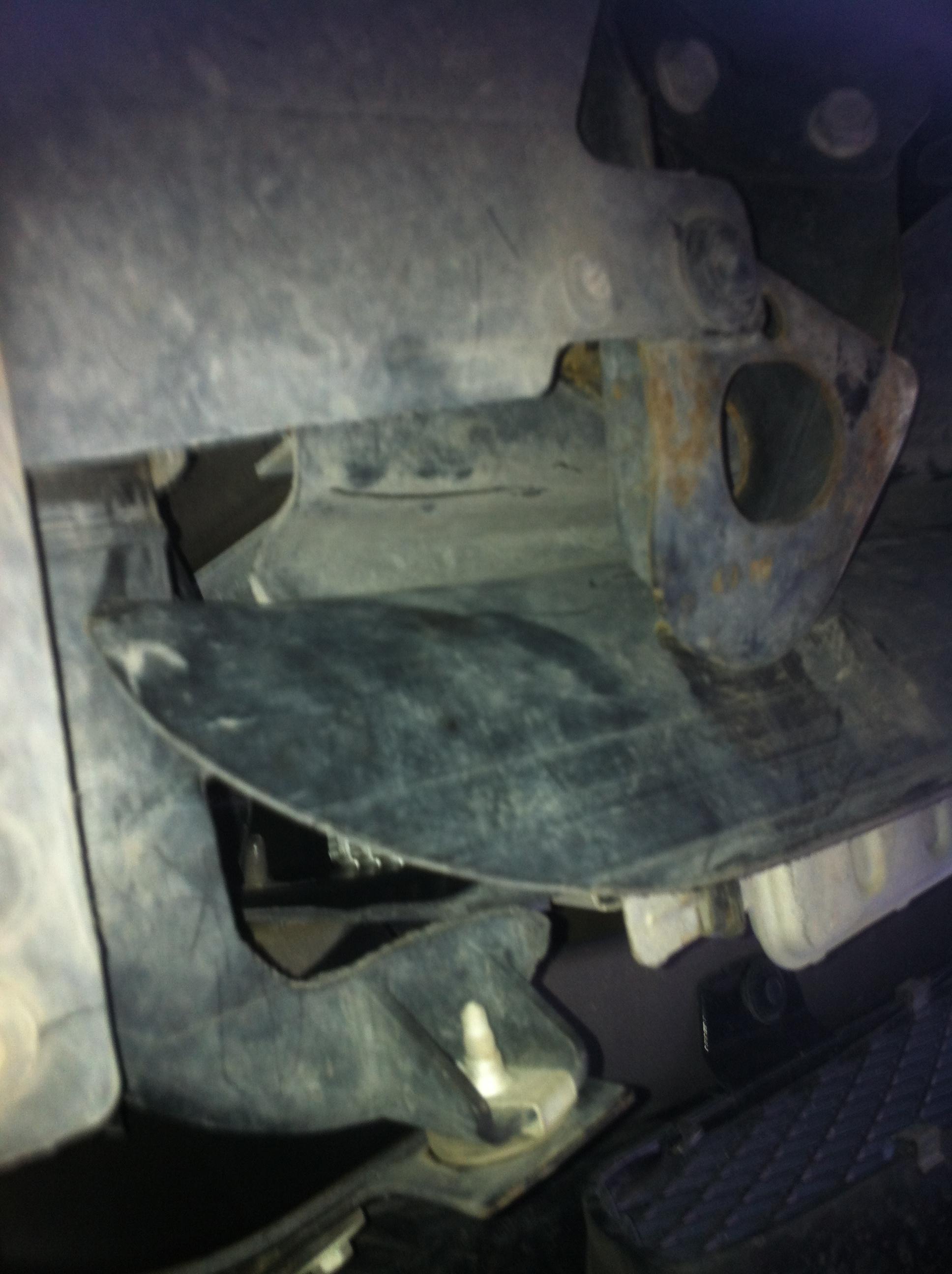

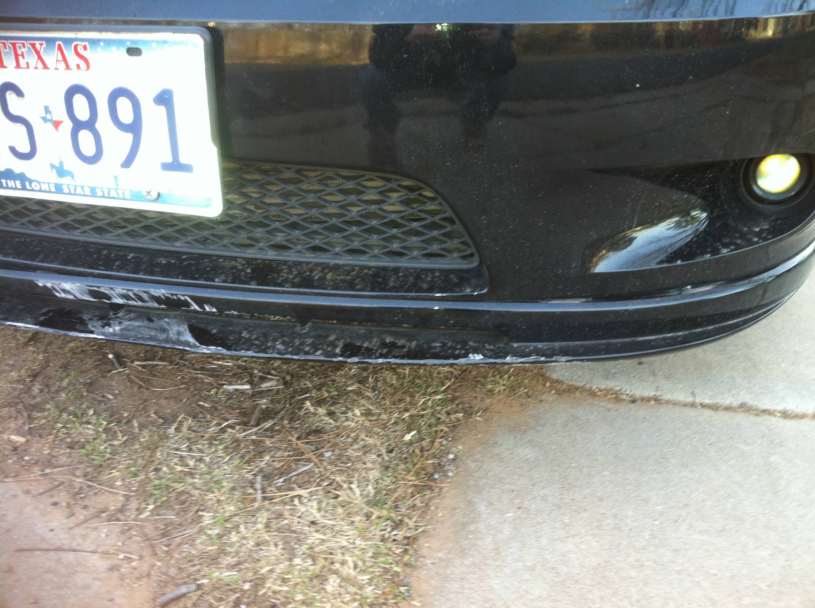

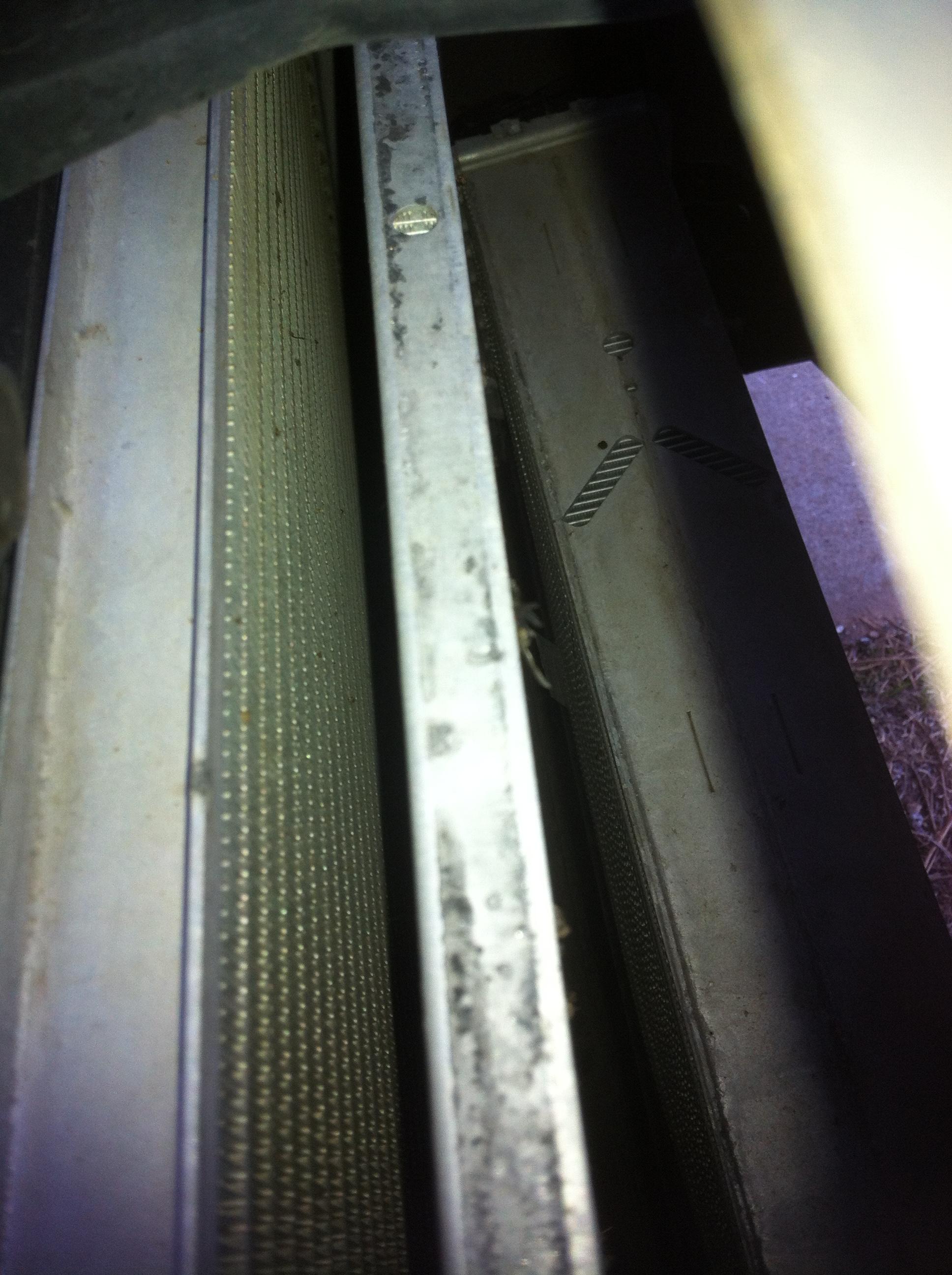

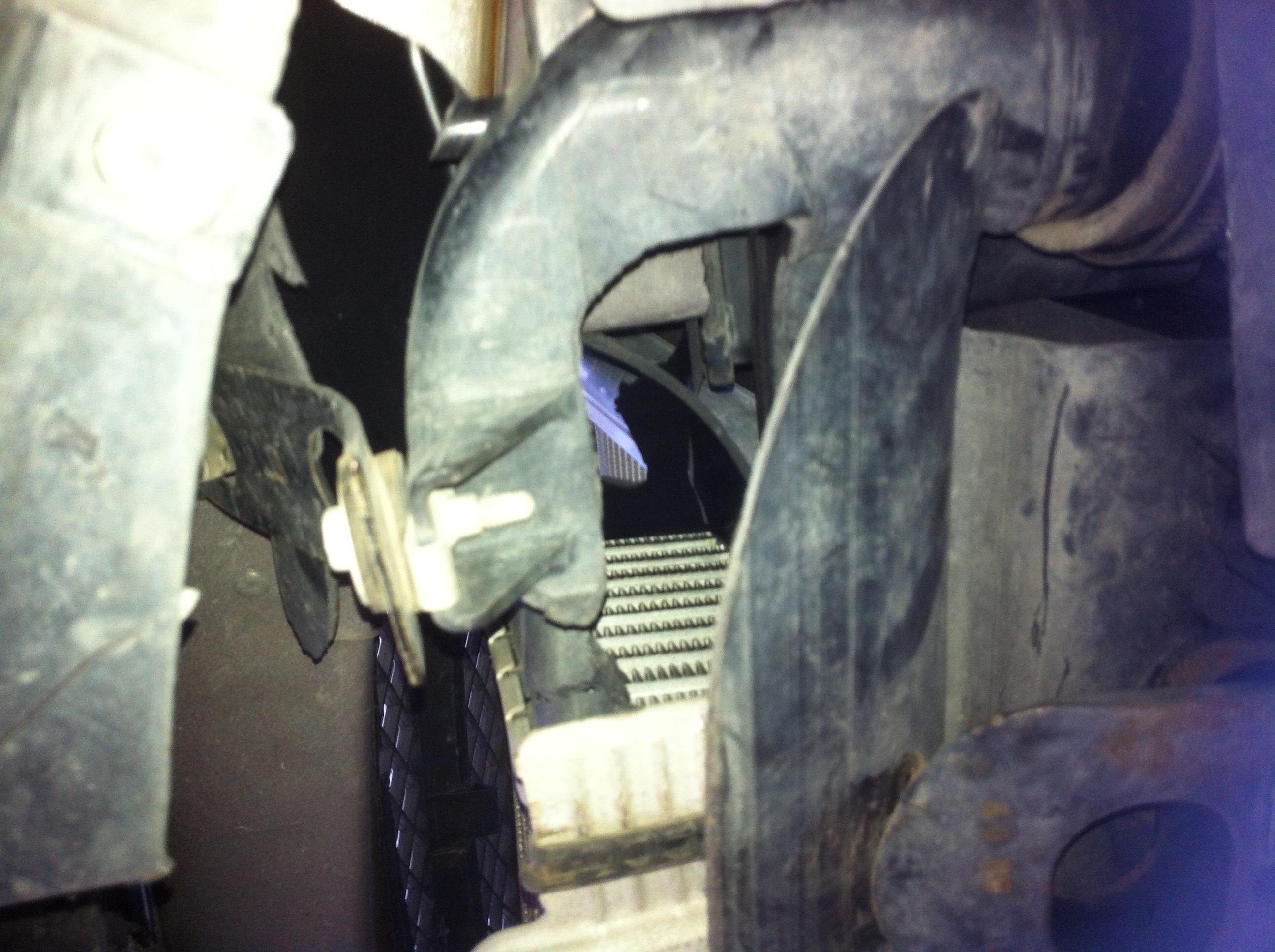

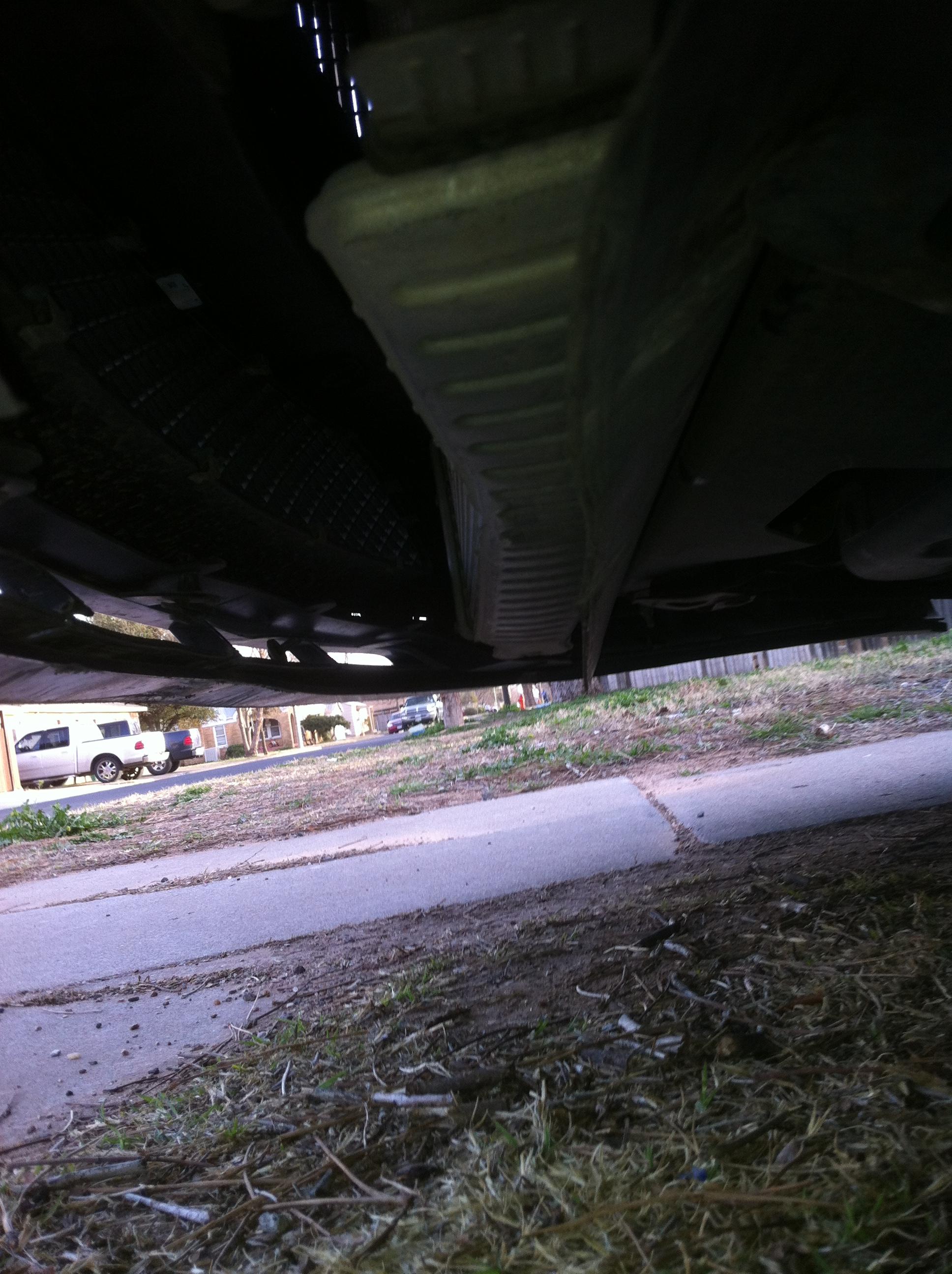

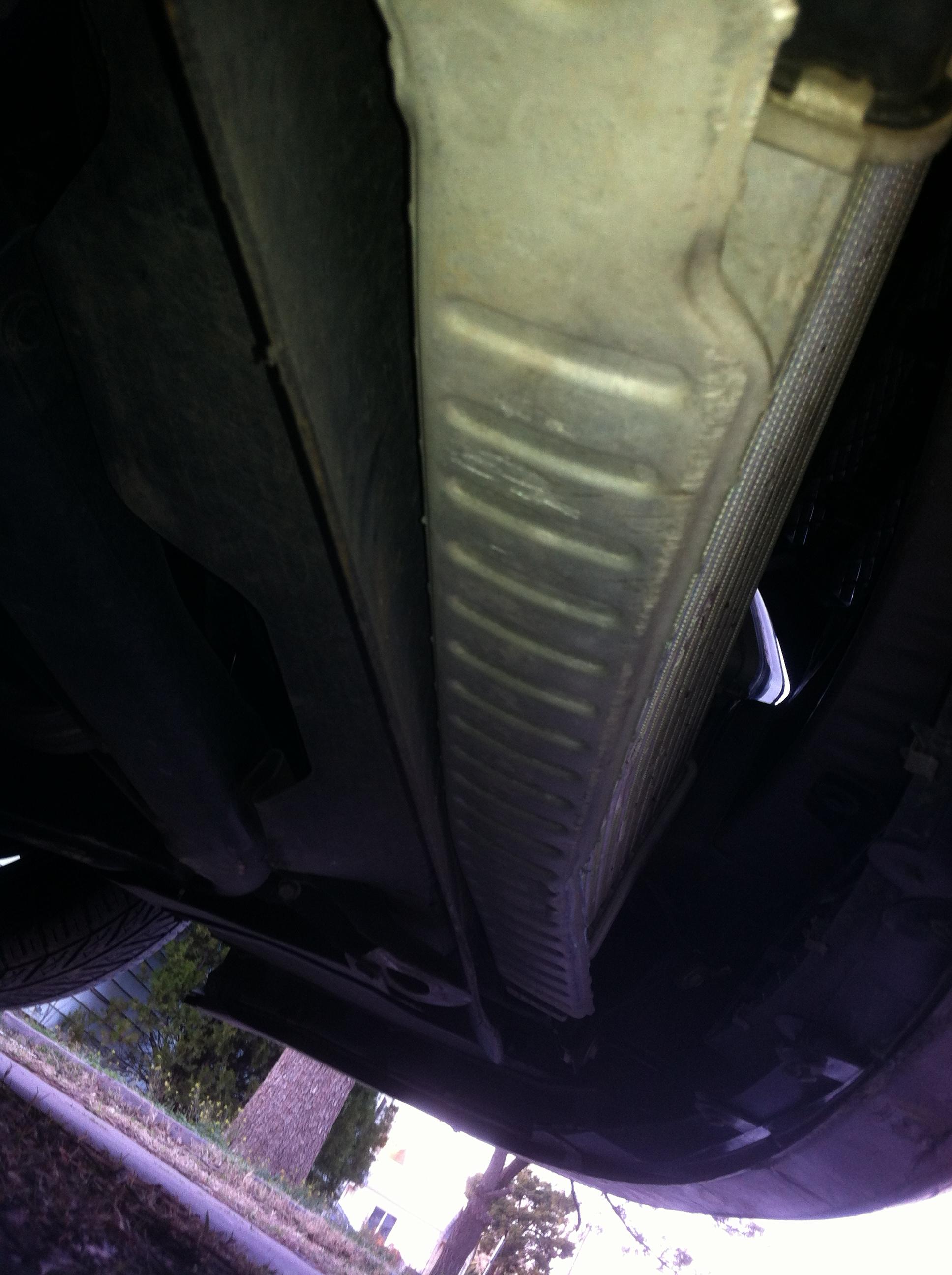

Hi everyone, I've had an interesting day to say the least.. Started well with finding I am to be flown in to have a 2nd interview with a company I really want to work for. After I got the news I decided to get my suit dry cleaned. When I was leaving I decided to go around a car going a little into the grass around the line that was waiting for stuff. I didn't notice this one big rock about 6inch or so, maybe a little more that was sitting right where I turned to exit. I went up the rock at maybe 5mph max and the car shut off. I tried to start my car and back up, but the vehicle wouldn't start. It would get the engine running then die right when it would try to level out. I got the car towed and have been looking at it and trying to decide what to do. From what I can tell, only the side plastic "tank" pieces seemed to be completely busted and the bottom single piece of metal on the bottom of the inter cooler is damaged. If I bought new tank pieces, would that bottom metal piece attach back into the tank and hold it back in place? The inter cooler is a little bent like a v but with an angle of maybe 165ish, and maybe a little crooked on its mounting now. (looks close to the radiator on the right hand side)
I couldn't take the best photos with my roommates phone. I plan on taking the bumper off this weekend and taking a better look at everything and take a few more photos.
I've looked at ZZP ( Can't find theirs with just the inter cooler an no charge piping, its the most expensive one by far... ), Hahn(), and the stock GM inter cooler prices ($424.99 for inter cooler, about $155 for each inlet, gm also needs the separate tank pieces for inlets) and I think I should be fine on installing this if it is indeed needing a replace.
Side note, I currently have charge pipes installed but they could use a nice paint job, which I plan on doing while working on everything else.

There is no "possibly" there... that thing is fucked. Pickup a bolt-in ZZP replacement. I got mine used for $250.

Yup, new intercooler is needed. When i smashed my stock ic i got the turbo xs intercooler next day aired to me from ttr. Great intercooler and fantastic company!

what is the piece of stamped metal at the bottom of the intercooler held in with one bolt on one side and plastic on the other? and what is its purpose?
Old Apr 14, 2012 | 01:43 AM
SSlobalt's Avatar
Joined: 06-22-09
Posts: 5,989
From: Kathmandu
It is a moisture accumulator. Is yours hanging right now?
Old Apr 14, 2012 | 02:04 AM
Boosted4's Avatar
Joined: 05-31-10
Posts: 901
From: The Big Easy
Mine was hanging down randomly one day, so I removed it before it caused me to bust the intercooler. I used JB Qwik to fill the holes and never had any issues until I eventually got an aftermarket one.

That radiator looks a little crooked too. I'd check for some leaks.
Old Apr 15, 2012 | 06:26 PM
FasterIsBetter's Avatar
Joined: 05-15-10
Posts: 3,994
From: South Charleston, WV
Yeah, for sure. Looks like he either broke or bent the upper mounts on the radiator as it seems to be completely out of the radiator subframe mounts.
