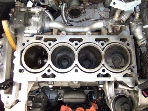

But the girdle is a totally different thing than the subject at hand - it reinforces the tops of the sleeves;
This is what our blocks look like on the deck face (when the head and the head gasket is not in place);
This is what one of our blocks look like on the deck face with a block girdle installed;
(Notice the extra coolant passages around the bores on the ungirdled block's deck face, versus the girdled block.)
IIRC the LDK block offers reinforcement at the bottom of the sleeves...
Old Feb 26, 2016 | 11:04 AM
The first picture you posted is an ldk block.
The lnf has an open deck block, support at the top of the sleeves is what matters, not the bottom.
you are correct;
I was just trying to demonstrate the difference between a girdled, and non-girdled block;
To those who care, here, I found a picture (that is hosted by here of all places) of a legit LNF block to demonstrate how much less reinforcement it has at the tops of the cylinder sleeves;
