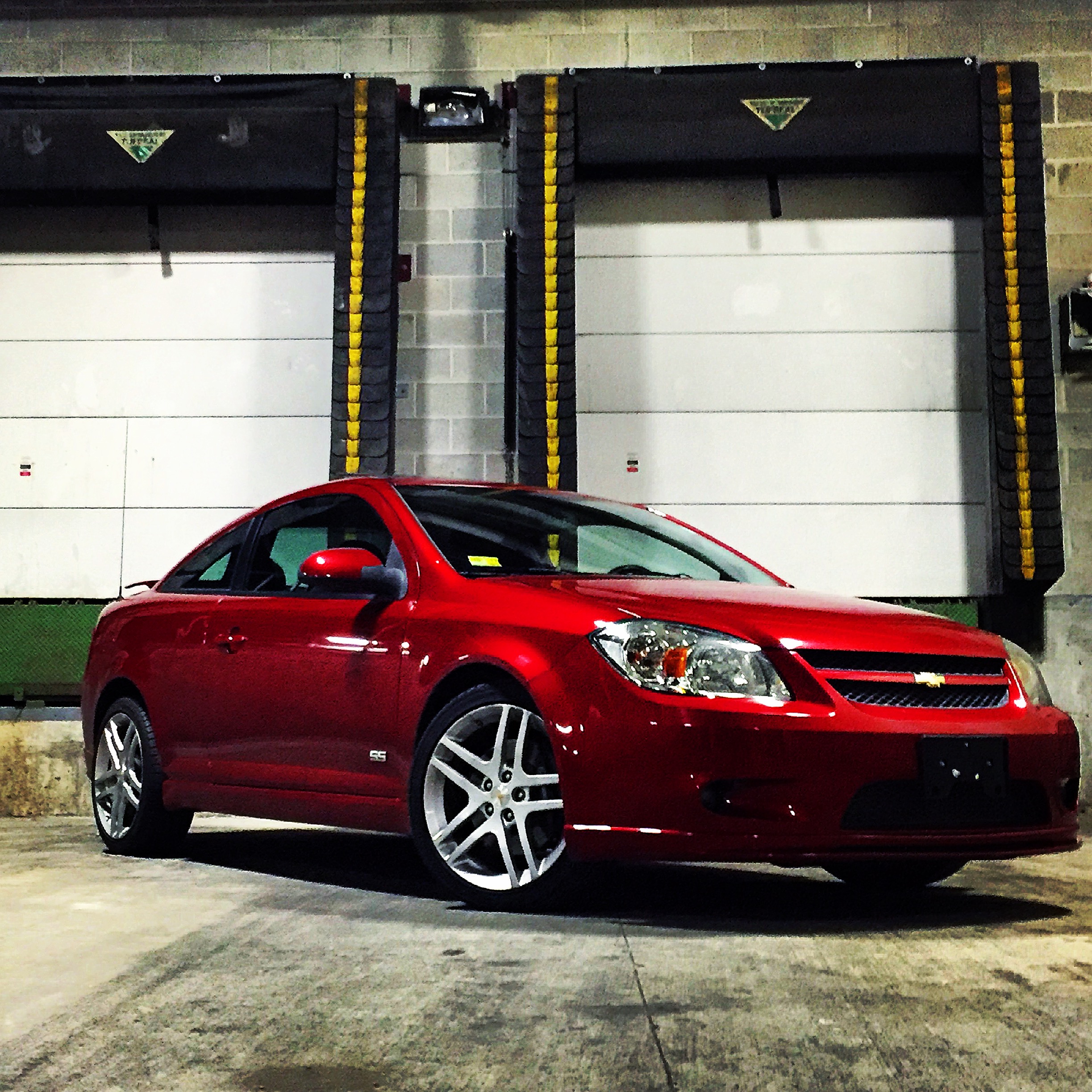

Road to 350hp advice?
Hi guys, I have a 2010 LNF and I'm hoping to get around 350 hp on pump gas, but expecting more like 320/330. So far all I have is a 3" ZZP catless DP but now with tax season coming, I'm trying to figure out the next steps I need to take.
A tune is going to be happening after I have all my necessary supporting mods in place. A friend of mine referred me to a shop in Mass (I'm out of RI) that will put me on a dyno until Im happy for about $500 and 150 for any adjustments down the line. Im hoping for 21-23psi out of the ko4 but maybe a zfr kit will be in order next year.
I'm getting a K&N drop in this week, but keeping the factory airbox and intake pipe for now, but a CAI will happen before the summer
I'll be upgrading the intercooler soon, but I'm not sure who to go with. I'm stuck between a Hahn Racing (with red lettering to match the crystal red paint) or ZZP.
Along with inter cooling, I'm debating if charge pipes are a necessity or just an appearance mod. I already have T-Bolt clamps on the stock pipes (previous owner) so hopefully the stock pipes wont blow off at full boost. Also, regardless if they're needed or not, i will at least have an upper installed before the summer is over (most likely Injen).
Thanks for any advice, and if anyone has any of the parts for sale, feel free to mention it! Ive been checking classifieds daily to find a deal haha
