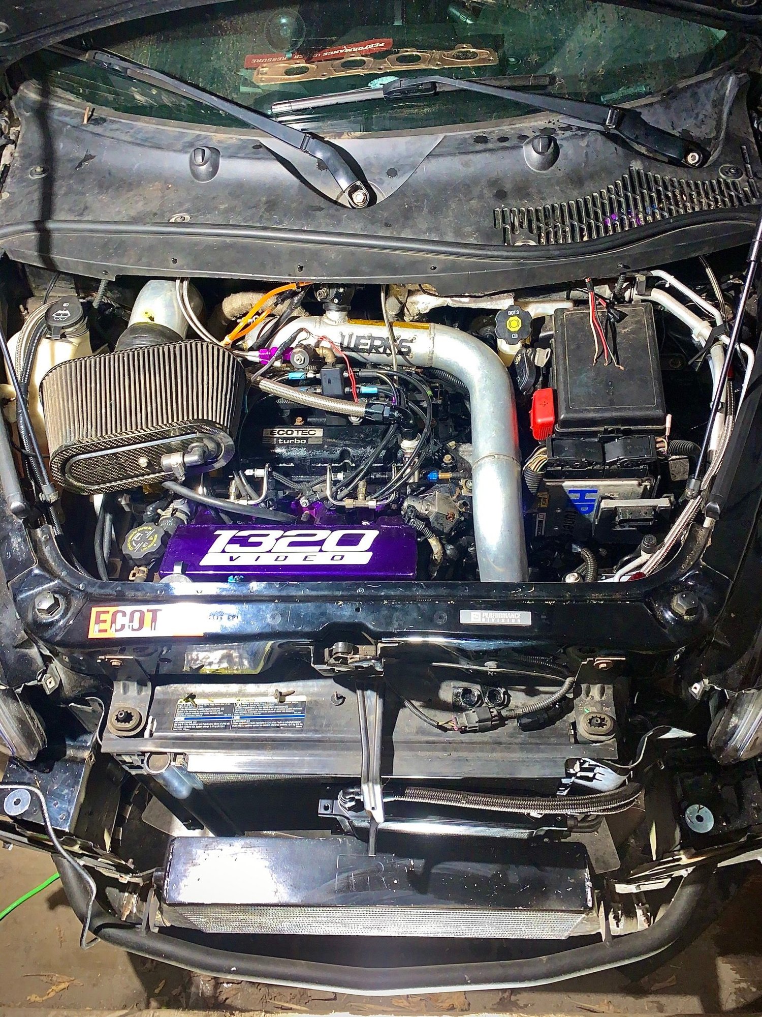

Got about half of the stuff i need

Got a little more done. Just waiting on my fuel cell

Chassis mounting the splitter next weekend
Still need some straps for the fuel cell and a battery box
All done except wiring
