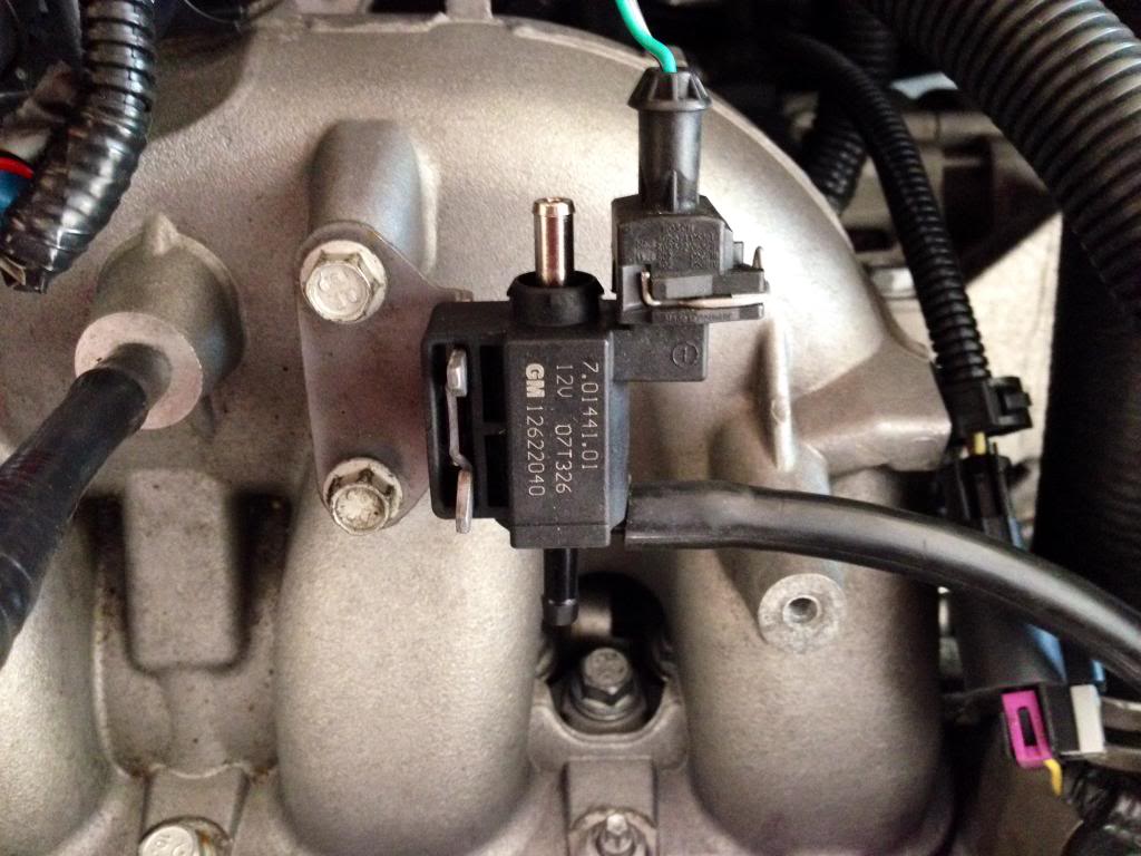

Was just looking at connections of the charge pipe and glance over to see this. What goes here?? I have had this car for almost 3 weeks now and it runs fine, which is just kinda odd lol

The one with the hose goes to bpv, the top in pic goes to vacuum tank and bottom in pic goes to lower charge pipe. Is there a block off plate on ur bpv and u running a bov? Cause ur bpv wouldn't work like it is now
That's the bpv solenoid btw

I'm running bov, that's all I really know lol. Like idk if I have a block plate
