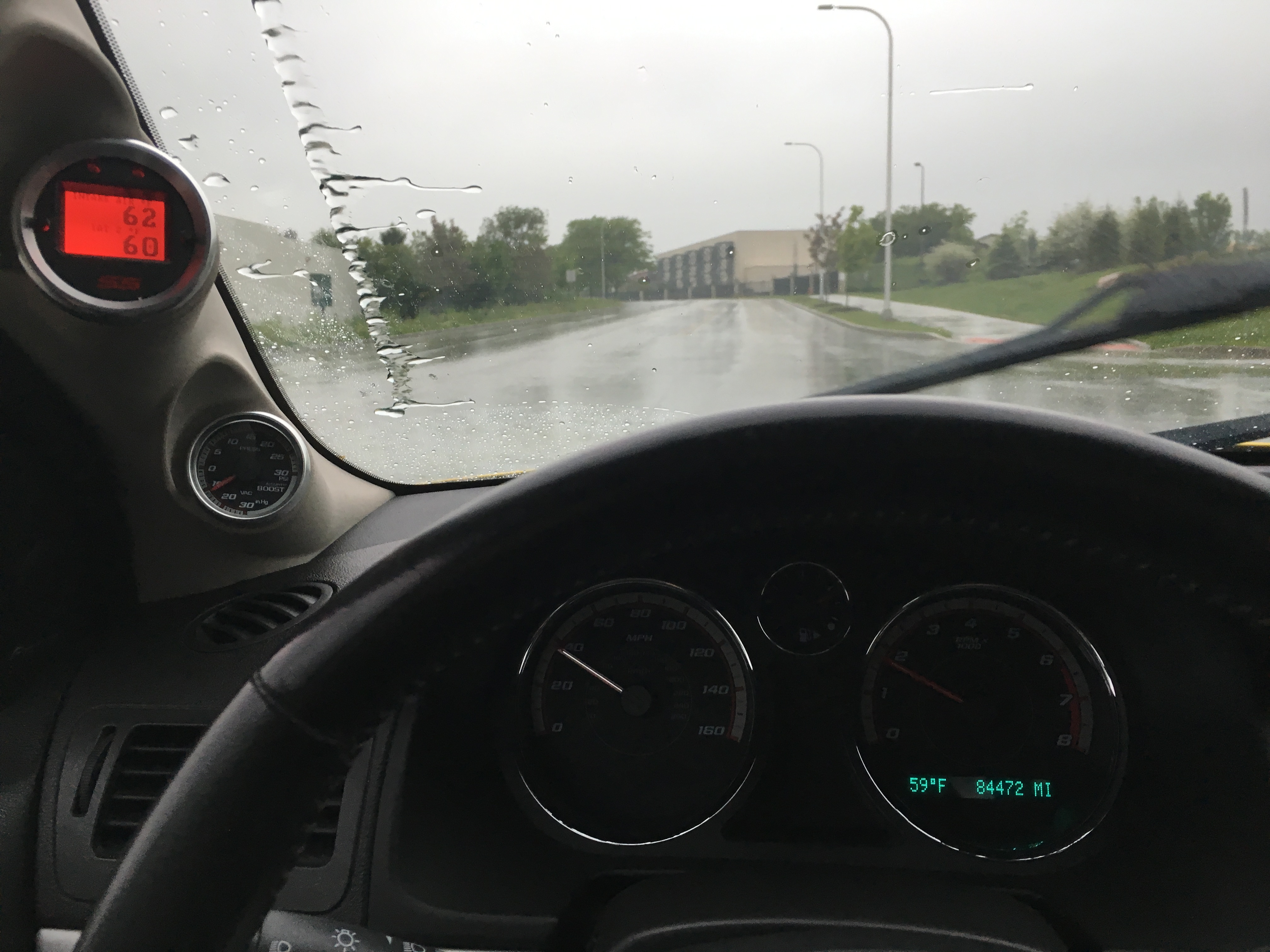

So, hard to make out, but snapped a pic as best I could with my phone. This is on a side street doing 35mph after doing 70 down the highway for 20 minutes. Engine was at 183, ambient is 59, IAT1 is 62, and IAT2 is 60.
Edit: Had to turn lights off to make the camera be able to see the dash.

One of the datalogs from the track:
Ambient of 60F, IAT is 124F at the staging lanes, and IAT2 was 73F. IAT does not drop back into the 70s until 103+ mph when I'm crossing the line. The IAT then stays about the same as IAT2 until I slow down and come to the staging lane again (within 5 minutes) and IAT is now back to 105F. After about 30 minutes in the pit area, I fired it up again and IAT was now 140F (ambient is 60F). It dropped down to 120F at the staging lane, and rinse/repeat/recycle.
On the street, the IAT and IAT2 are about the same as long as I am moving. As soon as I slow down and idle, the IAT spikes up. During my commute home, with an ambient of about 62F, IAT rose to 91F just idling in my driveway before I shut the car off.
With the stock airbox, my IAT and IAT2 are very closely matched even after the same commute idling in the same driveway.
