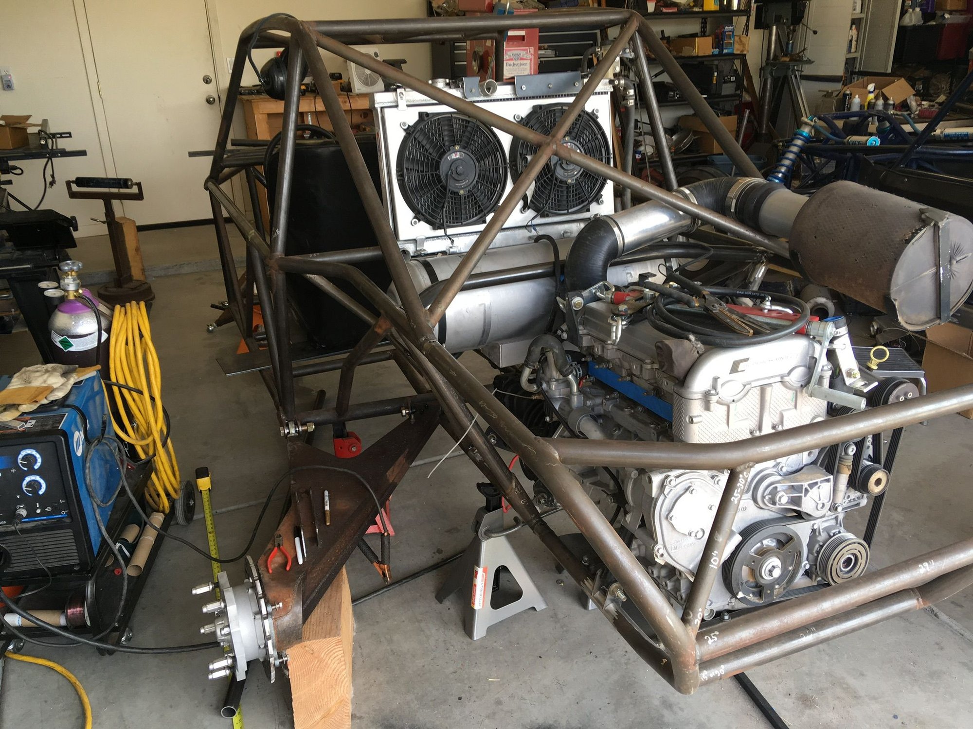

I’ve been reading as much as I can find on the all Forums with regards to LSJ Ecotec engines. I was hoping to rebuild my engine since it’s low on compression and I have huge blow-by. With a a healthy LSJ does the PVC system produce so much oil you need to have a Catch-can? If so which system would be best, I see ZZP offers a breather for the oil cap or other offer a -10 oil cap were you can install it to a Catch-can? I was hoping you could answer some questions about the best place to get a LSJ Head Ported and Polished and angle grinded? Which shop would sell the best camshaft for a LSJ platform(I was looking at the ZZP stage2 cam)? Which pistons would you say are best? Would I benefit from getting a size bigger Exhaust valves installed in my head??My application is a rear engine open air caged Baja Bug that will have fresh air moving over it to keep it cool..

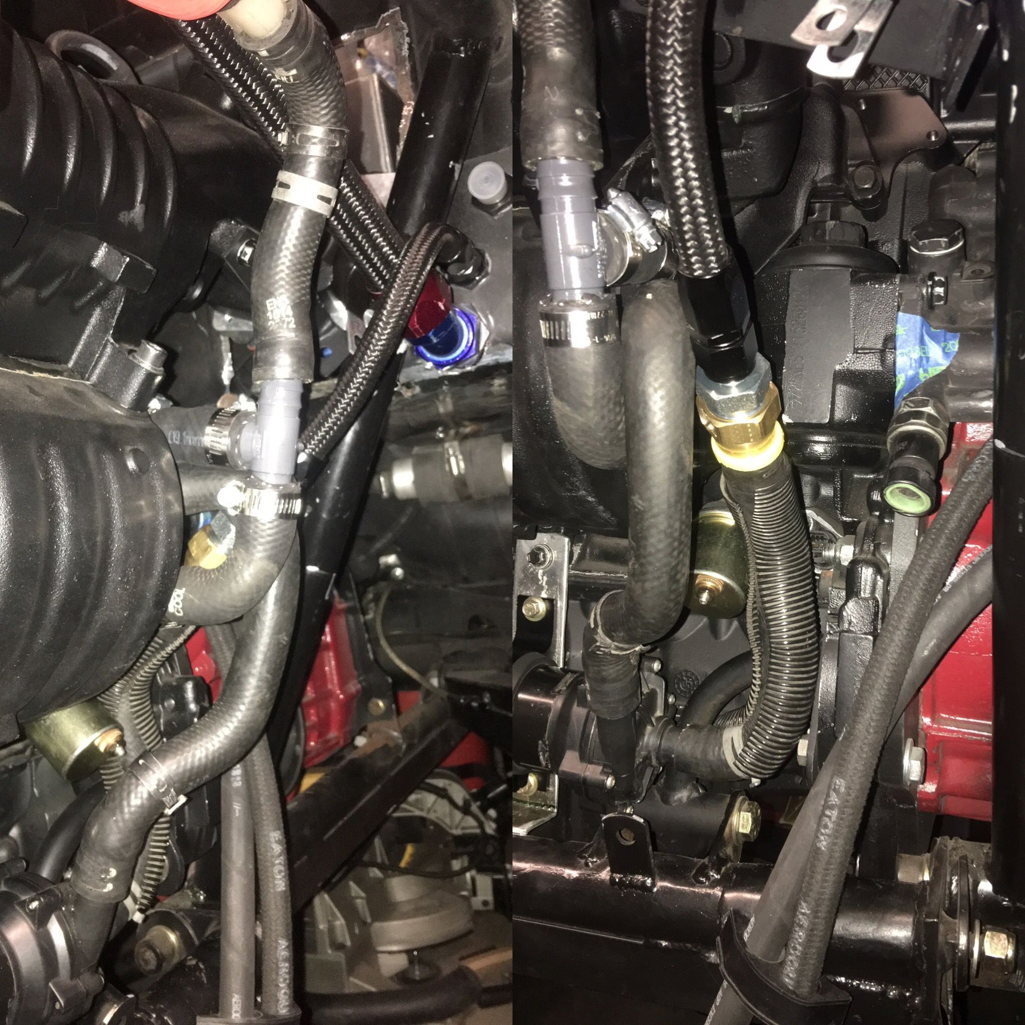

Running plumbing through fire wall with -8 and -16 AN fittings and hose
The CBM Harness layout on engine using MEDI4b
Pulley layout, i need to I stall an ilder pulley under ALT to get it to contact it and then run around power steering pump
Kennedy Flywheel 8 bolt
LS1 Throttle body
V-8 paper enclosed air filter inside the cab
My LSJ Baja Bug
Hello I’m using a LSJ Ecotec engine in my Baja Bug. It has a stand alone harness and ECU is using the MEFI4b. I have a;
Return style fuel rail,—•
42lbs Green top injectors—•
58psi fuel pressure on Regulator set with boost hose off,—•
It has a LS1 throttle body, 75mm—•
Spark plugs a step Colder(32 gap)–•
It has a 2.9 pulley on the Supercharger,—•
It has a huge V-8closed intake(Donaldson paper)air cleaner filter,—•
I’m running a power steering pump on engine,—•
I have a huge CBR 3 line Radiator up front with 2-12” fans programmed to turn on at 180* from ECU,—•
Heat Exchanger is located up front stock HC is using -8 AN fittings and hose,—•
Dual pass for Heat Exchanger,—•
I have 100ppm pre-filter and a 20ppm Filter post fuel pump,—•
It’s based on Open-Loop system my MAP sensor is located on the boost tube off of intake manifold,—•
3” headers to 2.5 muffler,—•
Once we got engine running it was running really rich, so we reset IAC, and TPS sensors and it ran at 850rpm and TPS angle was about .2%. I was trying to figure what else to do to adjust fuel enrichment but no luck. I took it to the Dyno Shop here in Santee and they did a compression test and #1-65 #2-60 #3-120 #4-90 and they they said there was to much blow by coming out of the breather filter so they didn't want to do any work on it. I'm not 100% sure that the blow by is all the pistons since I have a remote oil cooler that holds a quart of oil and about 5' of -8 lines so I have about 8 quarts total inside. I was going to do a leak down test and verify it is the pistons before I begin tear down. I've tried to look for a good used LSJ engine but everything has way to many miles or not a true 8 bolt crank.
I've looking into getting a new LSJ head with 82lbs valve spring new keepers and a stage 2 cam, ported head as well and some JE, Diamonds or Weisco 9-5-1 forged pistons.
ZZP parts list;
Pistons Forged,
Balance bar neutral,
82lbs valve springs,
Stage 2 cam,
LSJ Head port and polished,
ARP head studs,
Valve cover new gaskets,
Connecting Rod bolts,
LSJ Head gasket,
I’ve got a few questions with pistons and stage2 cam for my Supercharged engine. Would it be best for me to tear down engine and physically view piston before ordering them, the engine runs and I can drive it but after about 20 mins of driving the plugs get fouled and engine turns off. And I was wondering how much oils comes out of a healthy LSJ engine from breather filter, mine just spews oil out.
It's been a long road(5.5 years building car) but I quess I'll be doing a engine rebuild.
Question what would you think a LSJ ecotec with
Forged pistons 9-5-1—•Not sure best brand ??
Neutral balance bar replaced with smooth ones—•ZZP
Ported head—•Not sure best brand??
82lbs valve spring—•ZZP
Stage2 camshaft—•Not sure best Brand?
LS1 Throttle body—•
42lbs injectors or maybe upgrade to 60lbs injectors—•
2.9 pulley—•
Dual pass on HC return—•
What would this engine make around 340HP?

on your oil cooler setup your -8 lines are to small you need to run -10 as that is the factory size
I’ll need to redo my lines then in order to keep oil flowing

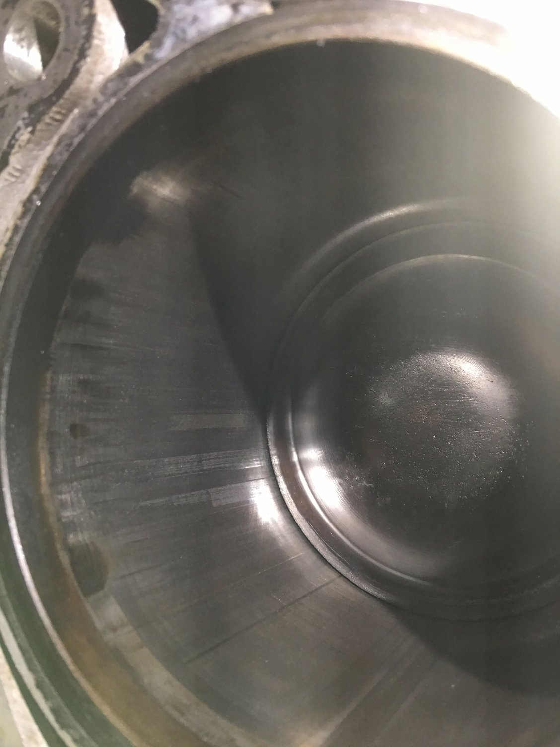

New or used lower block
anyone know of someone selling a good used LSJ lower block with good cylinders and maybe forged pistons... I just removed the head and the cylinders are no good.. Cylinder toast
Look at block after head removed
Haven’t takin out piston so not sure what caused this flatness of cylinder
Head seems fine haven’t had a chance to inspect it
She wasn’t happy I took Her Top OFF...

The block can be resleeved but if you need a block, talk to mongorat427.
From the info I've read it would be around 1000$ once you ship it and then get the service and new cylinders correct??
Who would everyone use to get this preformed and what sleeves?
I was reading that most would object to using Dalton is this correct?
Darton is a no-go. Lots of bad stories from their sleeves on Ecotecs.
Cheapest/easiest would be to get a newer block.

you can get sleeves other then darton
Old May 22, 2018 | 09:10 AM
get this guys sleeves^^^
I’ve read that you had or still have a line of sleeves you install, do you still offer this service??
How much is it to resleeve an LSJ engine and redeck it and a General shipping price??
im looking for any avenues to try and safe this engine...
thxs for your time
