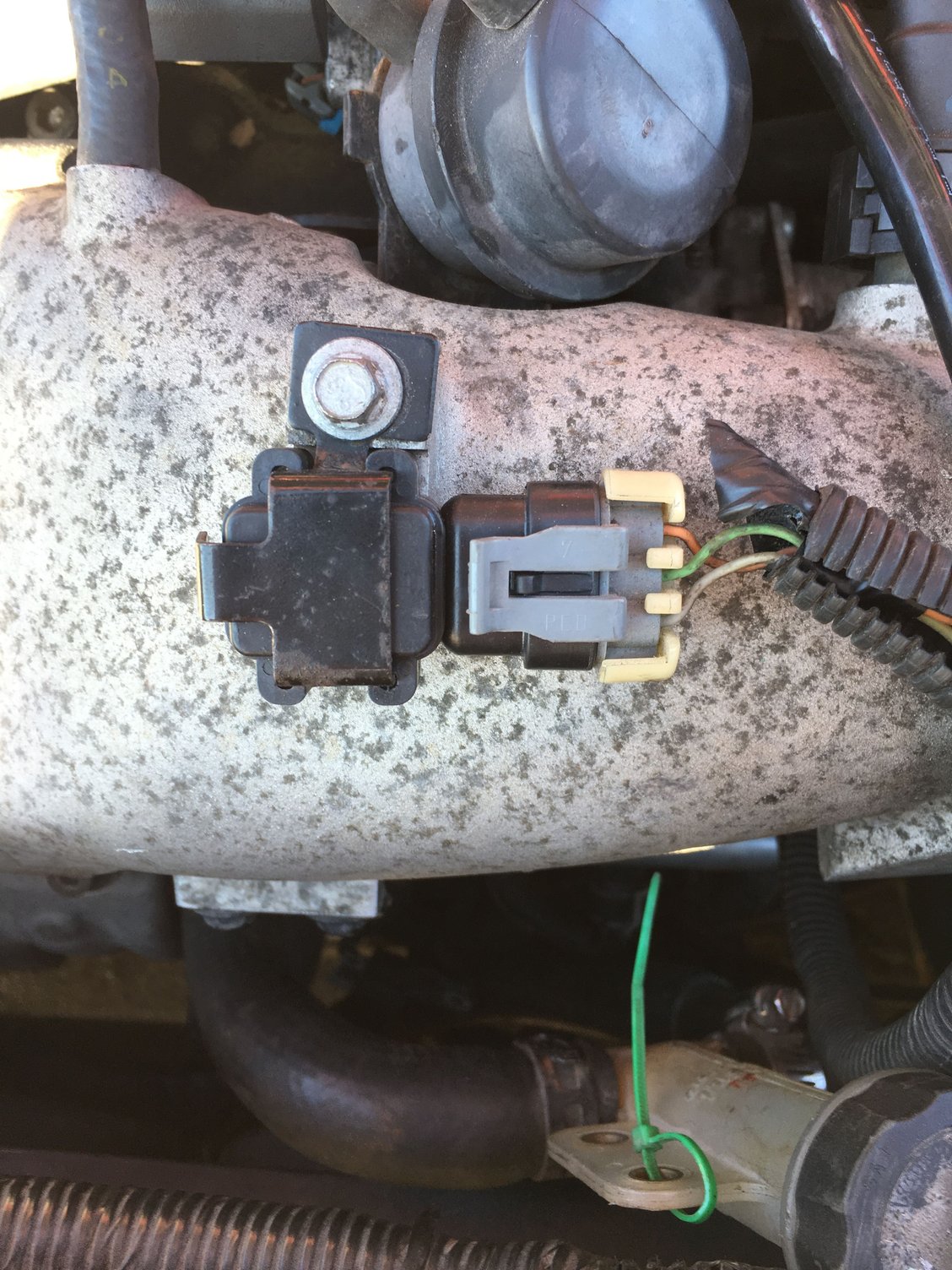

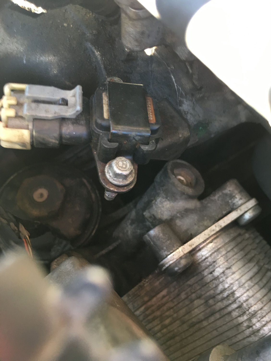

Also can someone please tell me what the sensor on top of the super charger is?? I thought is was the map sensor because when I went and asked for a map sensor from o Reilly’s it looked the exact same as the one on top of the supercharger. Even had the orange rubber on the nipple of it and everything. I didn’t put the wrong sensor in the wrong spot did I? Please help.. I have been working on this car way to much in the past 2 weeks my brain is getting scrambled

This is the one I replaced that’s on top of the supercharger

And this is one that is in between the radiator and the super charger on the left side by the pullys like under the fuel rail kinda

Supercharger inlet pressure sensor
barometric pressure
Map sensor
In order of the pictures
