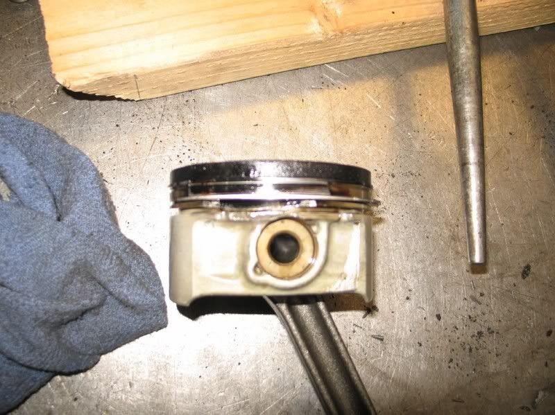

lol i had this same problem..check my engine build in my sig because of what happened...it will run fine for about a week..but u will have white smoke coming out of the oil cap..then it will start smoking like crazy from the exhaust..head gasket crapped on u and if u keep driving it say bye bye to ur ring land...to give u a visual
