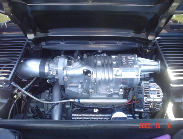

Here is the M112 converted from a M90.. Makes big power..
I am in the process of reading the other thread now.
