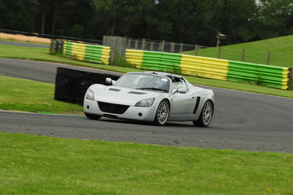

UKchilll what kind of car is that?

Opel speedster

oh nice... pretty damn sweet

We call the opel speedster a vx220 in the uk
Built buy lotus for GM
Came standard with a 2.2 ecotec NA
And later 2.0 turbo
Mines had a bit of work
Taking a 2.0 new Saab b207 engine and swapping the crank for a 2.2 adding forged Pistons, rods stage 2 Zzp cams and uprated valve springs
And a Harrop SC
Charge cooled
And soon to be WI
Currently running around 360hp and 400 NM
And it runs on standard pump fuel with a 3.1 pulley
And the car is fibreglass and weighs a little over 800kg

Few pics

I would love to have my setup in your car! Those things are so cool. Nice job on it!

There's no chance you could cool that power in a mid engine car like this
It's hard enough to keep it cool already

Get a porsche wing with the intakes
Car looks awesome, I do love those.
