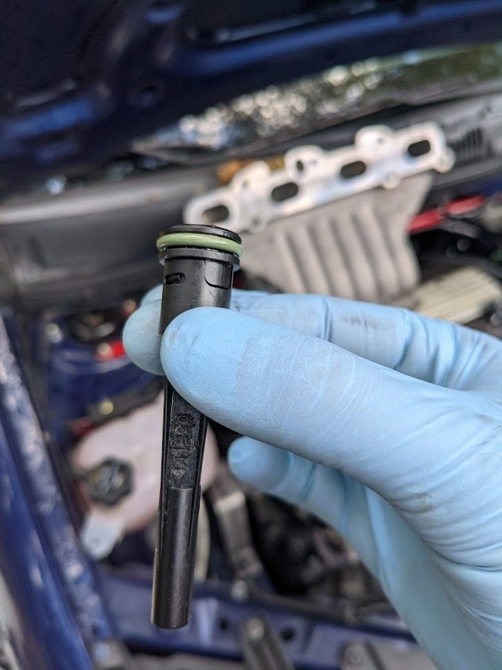

I pulled the supercharger and intake manifold. As I was certain it was a bad PCV.
PCV is new, and seems to be flowing 1-way.
Pics.
The gasket (i'm guessing an OTTP) doesn't seem to line up quite right. I know there was an updated gasket from a TSB but can't find what changed.
Also, I have a SAAB valve cover...
PCV
Seated in Intake Manifold correctly

OTTP and ZZP just supply OEM intake gaskets - they don't have their own versions.
The entire engine is out of a Saab. There's a few differences here and there, but the LSJ is essentially a Saab B207 engine. GM owned Saab, in case you didn't know.
