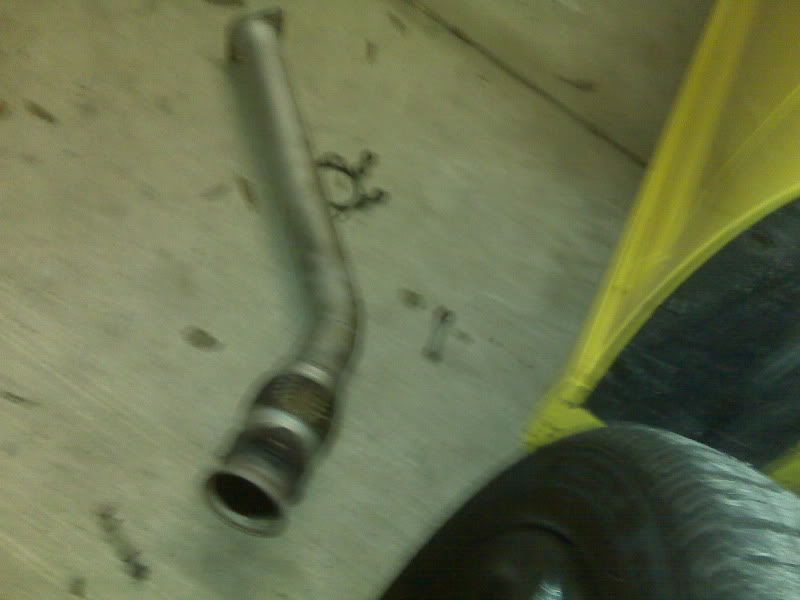

downpipe off

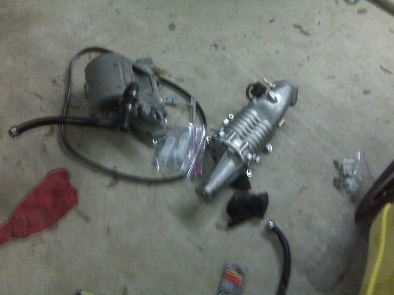

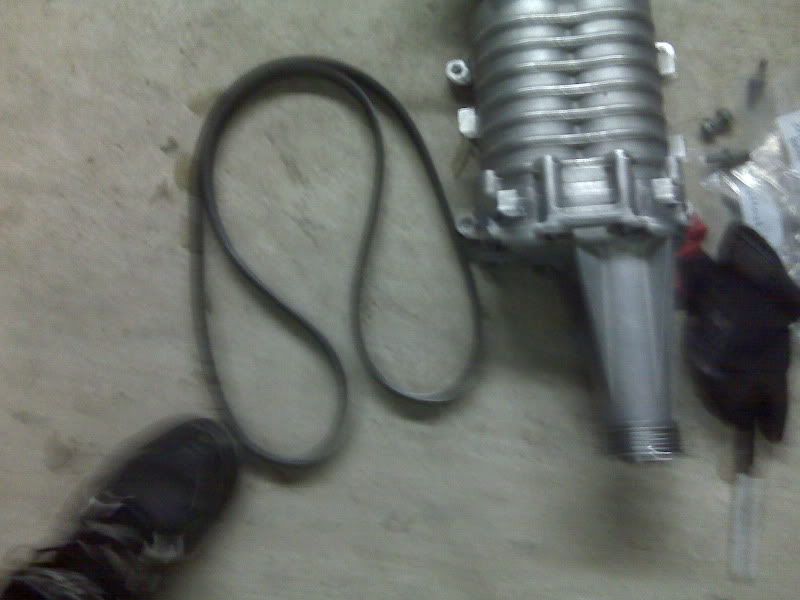

sc and belt
http://i58.photobucket.com/albums/g2...t/IMG00449.jpg
intake mani off
http://i58.photobucket.com/albums/g2...t/IMG00452.jpg
ic pump and bracket off
http://i58.photobucket.com/albums/g2...t/IMG00454.jpg
http://i58.photobucket.com/albums/g2...t/IMG00451.jpg

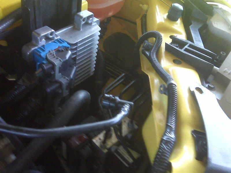

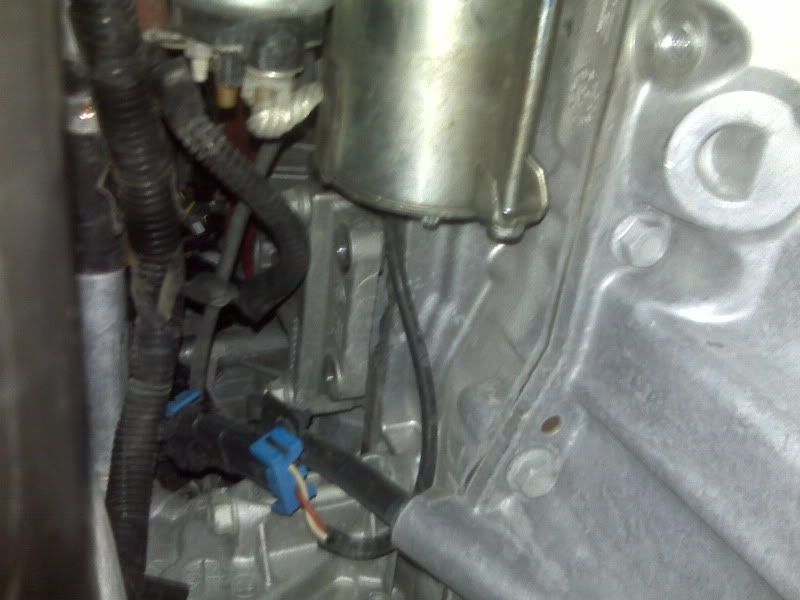

IC PUMP HARNESS PLUG WHATEVER YOU WANT TO CALL IT. FOR THOSE WHO HAVE DONE THE SWAP WHAT DO I DO WITH IT? TAPE IT OFF? CUT IT? ETC LET ME KNOW THANKS
http://i58.photobucket.com/albums/g2...t/IMG00455.jpg

the ic pump wire you can cut off and tape if you want and give the pigtail to them.
or leave it, whatever works.

the i/c plug i just left it there in case i ever went back s/c but its not needed and will not have any effect on the tune or cel. so in other words do what YOU want with it. :)

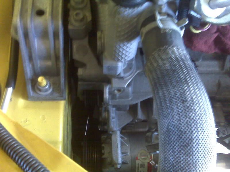

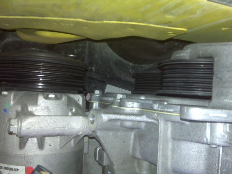

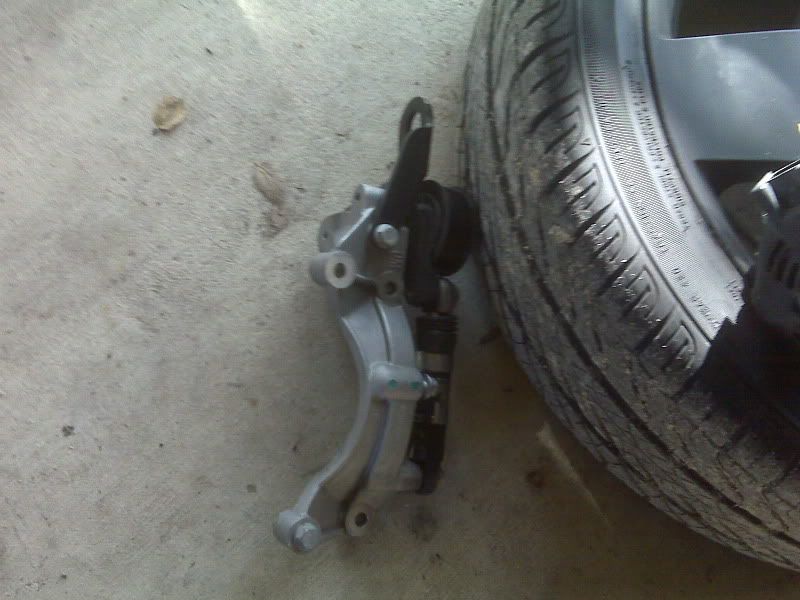

DOES ALL THIS STAYS LIKE THAT AND ALL I DO IS ADD THE NEW 2.2 ALT WITH TENSIONER AND BELT?
http://i58.photobucket.com/albums/g2...t/IMG00465.jpg
tensioner im pretty sure i wont need.
http://i58.photobucket.com/albums/g2...t/IMG00456.jpg

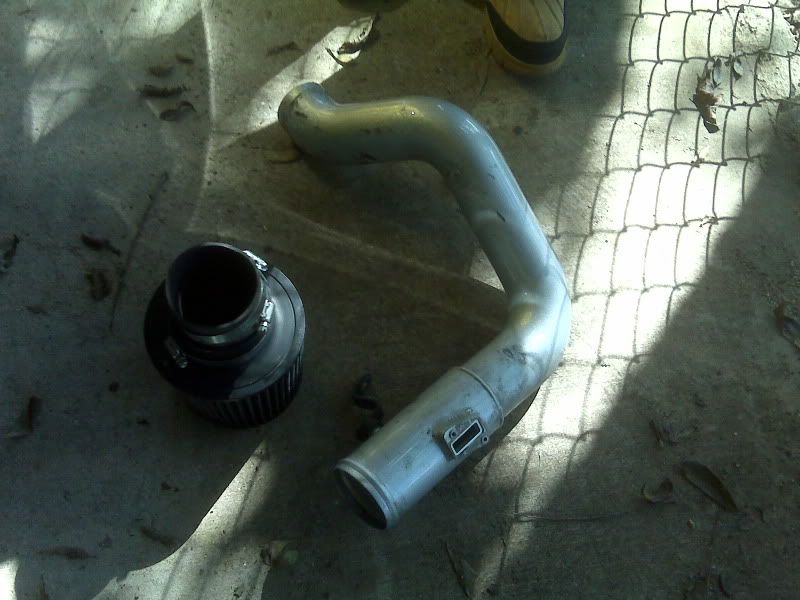

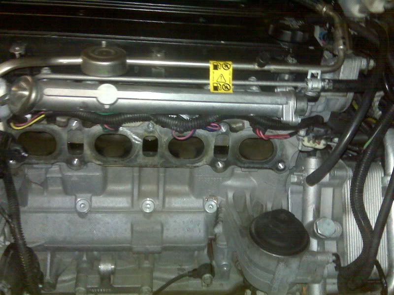

Intake
http://i58.photobucket.com/albums/g2...t/IMG00457.jpg
no more intake lol
http://i58.photobucket.com/albums/g2...t/IMG00458.jpg

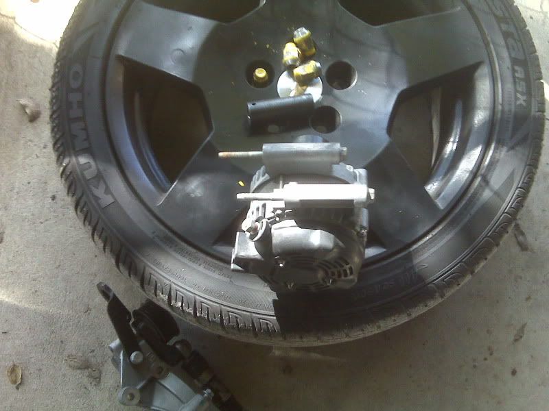

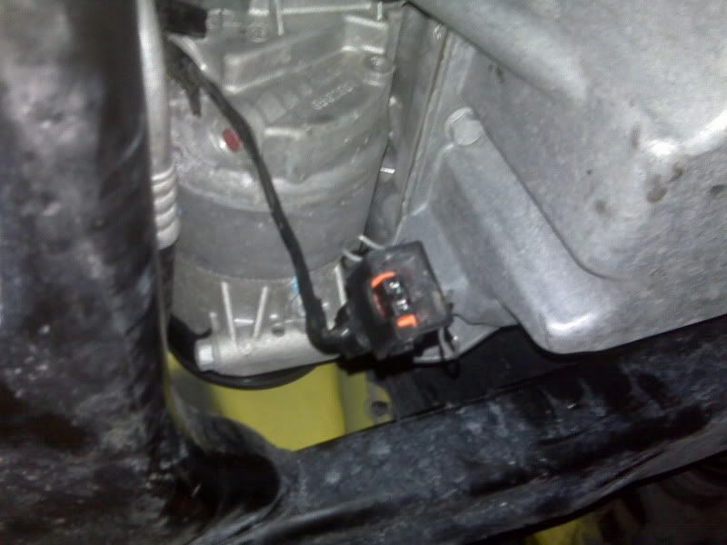

no alt or anything
http://i58.photobucket.com/albums/g2...t/IMG00459.jpg
alt off
http://i58.photobucket.com/albums/g2...t/IMG00461.jpg

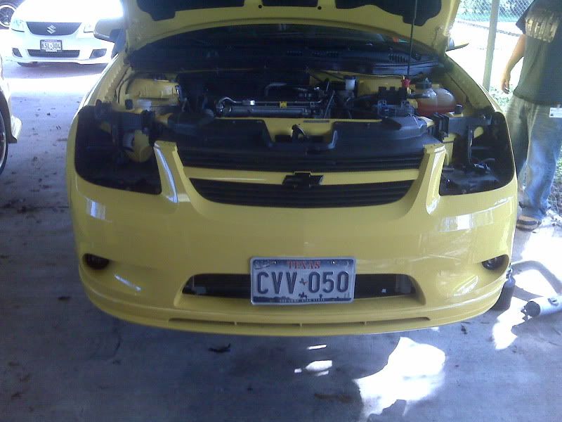

front look
http://i58.photobucket.com/albums/g2...t/IMG00462.jpg
engine bay
http://i58.photobucket.com/albums/g2...t/IMG00463.jpg

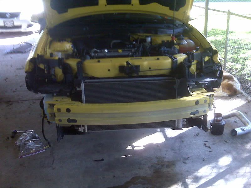

bumper off
http://i58.photobucket.com/albums/g2...t/IMG00464.jpg

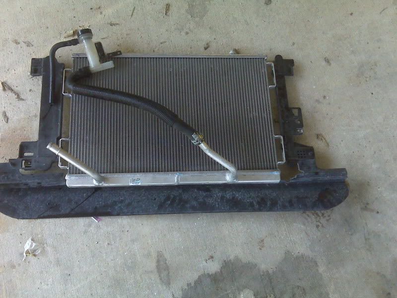

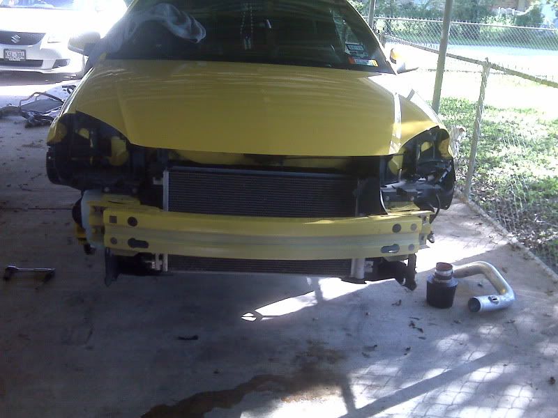

stock h.e off
http://i58.photobucket.com/albums/g2...t/IMG00467.jpg
off for now the wait begins
http://i58.photobucket.com/albums/g2...t/IMG00469.jpg

yes u r going to need a 2.2/2.4 alternator and idler pulley...ur alternator cant spin clockwise, its not reversable like ours is :p and ur idler pulley needs to be smooth not ribed, since u wont be running a belt with ribs on both sides any more
rico Nov 22, 2009 04:42 PM
ill be getting a 2.2/2.4 tensioner with the kit:)and belt i guess all i need is the alt:) good stuff ill just sell mines and get a 2.2 one:) thx for the heads up

not now, but when your all done you gotta have that air dam in place for proper rad cooling. ;) (i never took mine off just slipped the h/e out)
its gonna be a whole new beast when your done lol trust me you will love it!
rico Nov 22, 2009 05:50 PM
huh u lost me ahah. are you talking about the intercooler ? lol and yess I cant wait lol should be very fun
hungryhip-ccp Nov 22, 2009 05:53 PM
the black thing around the h/e with the flap on the bottom, you actually have to have that or the car will work much harder to keep cool
you didnt have to take it off just lift up on the h/e so the plastic nubs pop out the groove and the slide it out much much easier, lol
yeah my bad h/e= heat exchanger= intercooler
rico Nov 22, 2009 05:54 PM
oh wow I didnt know that. thx for saying something before the guy comes and pics up the sc kit. saved me one there bro.
eh wont be all that hard to put it back on just bolt it on and done lol its all good
hungryhip-ccp Nov 22, 2009 05:57 PM
ya, i didnt know if you removed it to modify it or something (cause i had to trim mine for piping)
so i figured id mention something cause i know a guy who had cut his off cause it was scraping all the time and his car would have the fans on high like all the time after that
it never actually over heated but it would be 220 with fans on high sometimes, my fan never kicks on car stays at 180-190
rico Nov 22, 2009 06:00 PM
oh okay lol thx. yeah my car never goes over 190 lol hopefully it stays like that... but eh maybe since i took it off there is trimming needed or something lol then i have a reason to have taken it off lol
