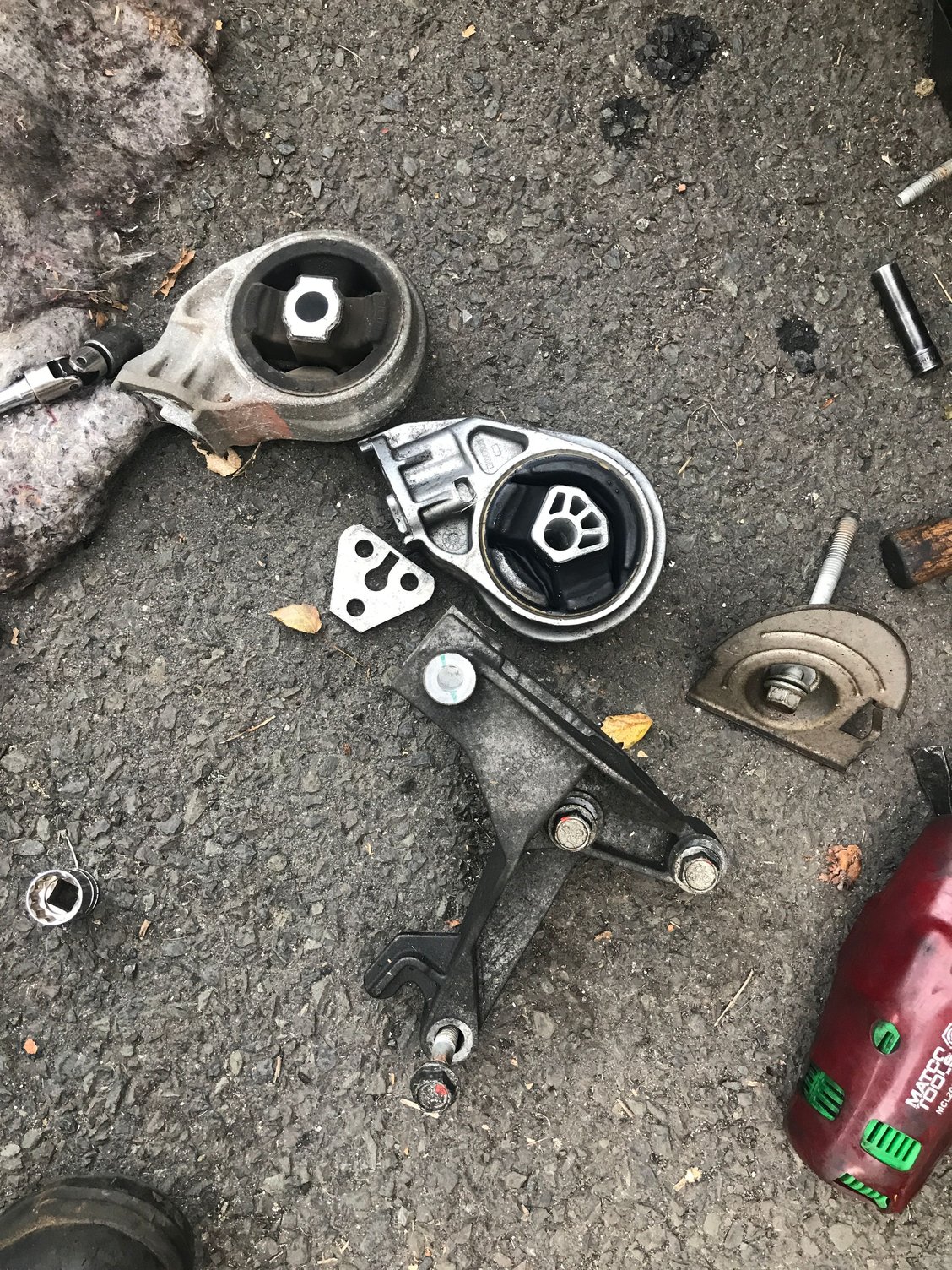

Most of the stuff is on. Doing rear mounts and front. Almost done. Lnf axles are in. New intermediate shaft. All anti seize up.

Upgraded Powell mount from my cobalt.

The last mount I needed to upgrade. All of them are in and torqued in sequence how it should. Kinda pissed I had to remove the fuse box but it only took an extra 3 mins lol.
