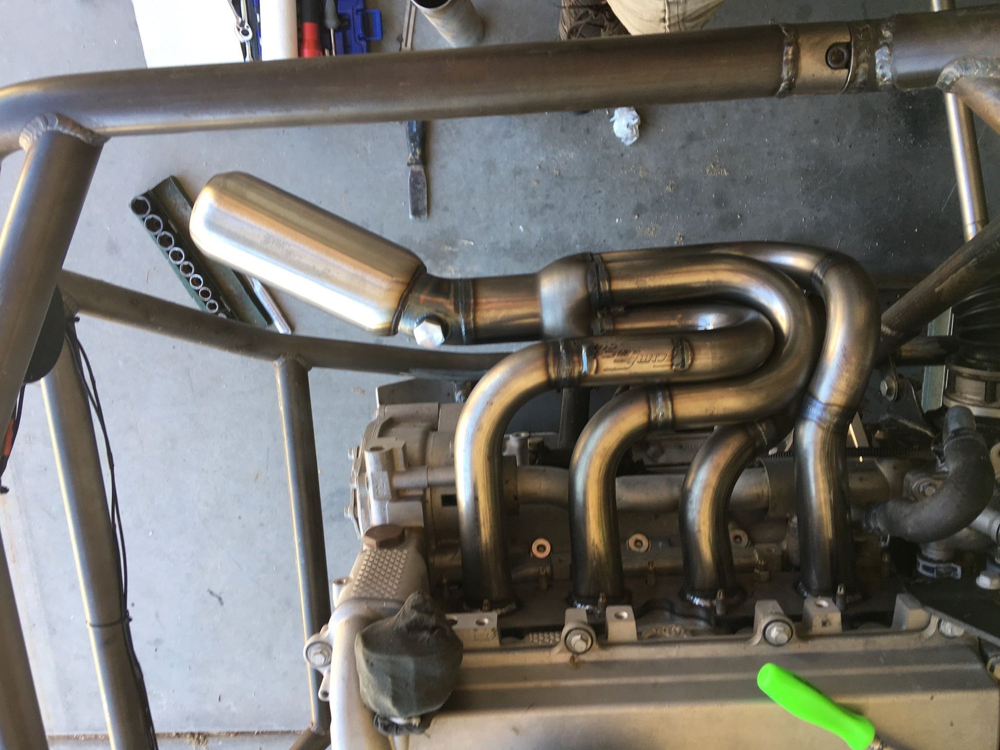

Will this Aluminum O2 bung plug melt or seize?
Old Aug 22, 2019 | 03:09 PM
Stumpalump's Avatar
Joined: 12-04-12
Posts: 379
Likes: 11
From: Arizona
Should I order a steel bung plug or will this aluminum one hold up?
Old Aug 22, 2019 | 03:52 PM
Just put some graphite lube on it or some high temp anti-seize.
Old Aug 22, 2019 | 04:39 PM
Sharkey's Avatar
Joined: 10-27-07
Posts: 5,681
Likes: 266
From: Abbotsford BC
id put a steel one in there myself. looks like its a stainless header, aluminum and stainless are bad enough for seizing without adding 1000+ degrees of heat.
