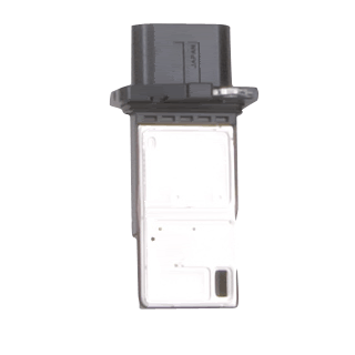

Where is the IAT sensor
On the intake but what does it look like
