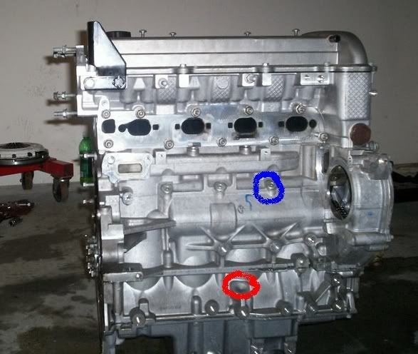

is there any place on the back of a 2.2block to put a sending unit in for oil pressure i know there is 3 under the intake manifold but didn't know if there was on the back side of the engine

any of those large galley plugs work
dont use any in the head

Really you should go with the one under the intake manifold, less chance of cooking your sensor with the engine heat.

i know that but is there any on the back side of the engine

Yes there are three on the back as well but its right under the exhaust manifold and so close the the location of where a turbo would sit

ok well think you if anybody had any pic of that that would be great

ignore the one marked in red. any of the 3 you see where the blue circle is will work

you wouldn't know what type or size wrench it takes to take the plug out

no wrench can get it. pretty sure it's a torx bit if i remember correctly

Torx or allen

i dont know. sorry. but those are the ones u want to use. i think this torx.

i used the one right below the evap thing on the head i belive.. to lazy to take mani off haha

This, and not to mention coolant line...
