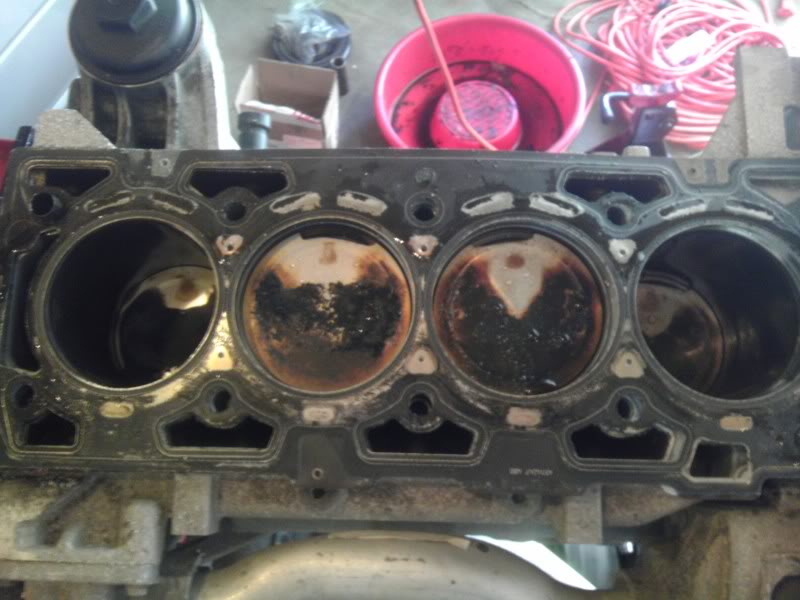

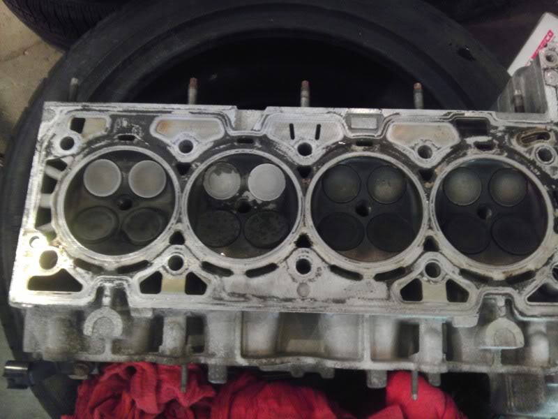

Old Aug 27, 2012 | 04:34 PM
BankerBalt's Avatar
Joined: 10-10-10
Posts: 1,848
From: Eagan, MN
This is what happened to mine running 210 whp stock

Bottom line, if he wants the power around 300 HP the engine components would eventually fail due to fatigue.
