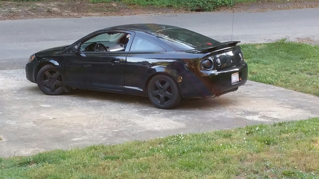

Ok I bought the car a few months ago rebuilt the engine and threw it all back together it had aftermarket headers cat back exhuast with Flowmaster muffler, injen ram intake and I believe that is it, I have not done these upgrades they were already there, we'll I feel like the car falls on its face, I need some power and I need to know what direction to take I do not have the money saved at the moment so if there's some small cheap things I can start with while saving that would be great, this is not my daily driver Its just a fun car, so if any of you could throw out some ideas for me that would be awesome I heard from somewere I may be able to put the 2.4l intake on it to add a little but I'm unaware of this, thank you in advance for any help given

That looks like a 2007-08. I'm going to tell you right now a tune will be what makes the car not fall on its face, especially with an automatic. The spark timing in the areas when you step on the gas are negative values. Changing those really wake the car up. Also messing with the transmission side of the tune can help if you're auto.
FYI if you decide to buy the HP Tuners tuning software I have no problem helping you figure out a NA(I don't do turbo/supercharged tunes) tune so you don't have to pay for a tune AND the software.

Thank you very much and it is a 5 speed and u hit it on the head it's a 2008 model, I didn't realize just tuning it would help that much if that's the case I do i a small program but idk if it will let me tune it and I have never tuned a car before so I would probably be better off taking it somewere locally
