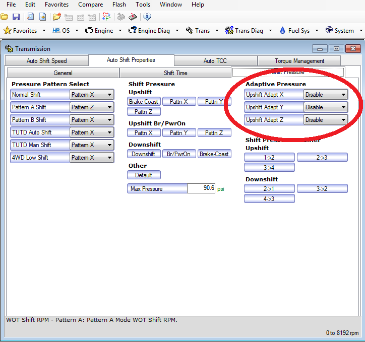

How did you disable your adaptive pressure? I did try to 100/90 but it just seemed so aggressive. Do you still run lockout in 3rd then? How many miles have you put on your transmission running this setup if you don't mind me asking?

How to disable adaptive at the bottom of the page. I run 100/90 in 4th only. 3rd is way too damn jumpy. I have the enable speed set to a lower speed in 4th gear than the 3-4 shift. Lockup is completely disabled in 3rd gear now. I've been this way for... what? Like 40,000 miles?
