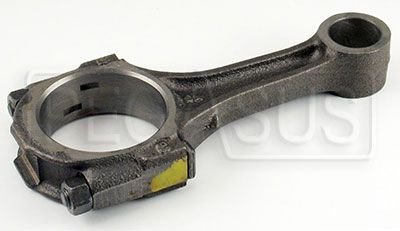

Originally Posted by klotzy_550
For note; forged rods will always have a forge line on them, its a 1/16 - 3/16" line that runs around the middle perimeter of the rod, powder metal rods will not. Forged rods have much better grain structures than powder metal and since they are formed from a bar stock, less porosity when compared to powder metal.
One of us may be backwards here, but my understanding is forgings typically have a wider flashing line then cast. Where forged rods clearly have grinding marks from the cleanup process.
See this rod is forged, with a wide line. I would say more on the lines of 3/16-1/2" for forge lines. Does this make sense?
Where a cast steel rod line is barely perceptable in this image:
It really depends on how they are forged and cast. The guy you were quoting was comparing forged to powdered metal sintered. If you are just sintering, then you wouldn't have a line, but I believe the sintered rods are also forged. There may be a small line depending on how they forge it.

The 2 processes are extremely different and the cleaning process after casting during machining can remove the casting lines. Here's a rod being forged.
