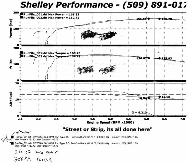

Here we go. Jerryg's dyno graph

am I missing sumtin cuz i see 160 and than u wrote in 211, care to explain?

Nice at a 15% loss your hp is at about 191.08 and tq is at 189.15. not bad for a ecu flash and a couple bolt on items. Are you still under 1000$ spent?
That 211 was an estimated at the fly i am assuming. most places that i have been to that dyno will give you a guess as to what the fly wheel numbers are at, hence the hand written.
Do the math for me on that----161X1.15 is what I do. Am I missing something?
That's not right. That's 115% of 161. That's adding 15% to 161 in other words. If you want to calculate a loss, you have to go by the simple algebra:
161 = (1 - loss) x 211
161/211 = 1 - loss
loss = .237
loss = 23.7%
That's what I calculate. So I don't know where people are getting 15% loss for 211 at the fly. That would look something like:
161 = .85 x HP
161/.85 = HP
189.4 = HP
Which is closer to what Rashnu said.

why is there a whole bunch of **** scribbled on it?
damn you lost me! I suck at math. But if you say 189hp flyweel and oithers agree--I'll accept that!

i scribbled cause i accidentaly wrote 4th gear and 3rd gear. and the top is hp and the bottom torque. i wrote 211 cause the guy at the dyno told me that it was a 30 percent power loss and that was the numbers that he calculated. and yes im still under 1000 dollars.
Yeah 23% loss to the wheels will give you 211 at the fly.
