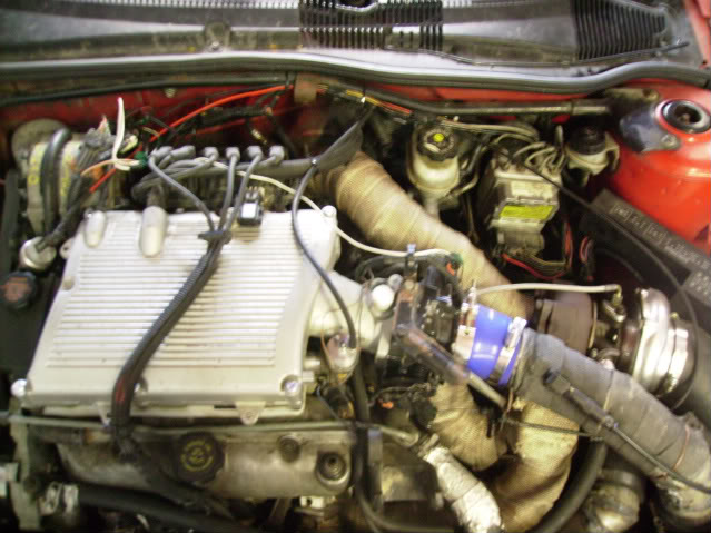

Here's a swap my buddy did in his Cavi. But used the 3.1. Built the entire turbo kit including the headers. Made 320whp,320wtq on a junk yard motor and low boost haha

i think i've come up with two solutions first is i can use the stock 3800 ecu tune it and use a tranny controller but i still have to pay $950 or i can use a 3400 ecu which can control the tranny but can it be tuned to use it with the 3800? if so then that would be the ticket and everything would be working like stock
what tranny did he use
ah, my old monte carlo motor i hated that motor so ******* much!!!!!
320whp though, thats over twice what the base stock power is, not bad at all!
