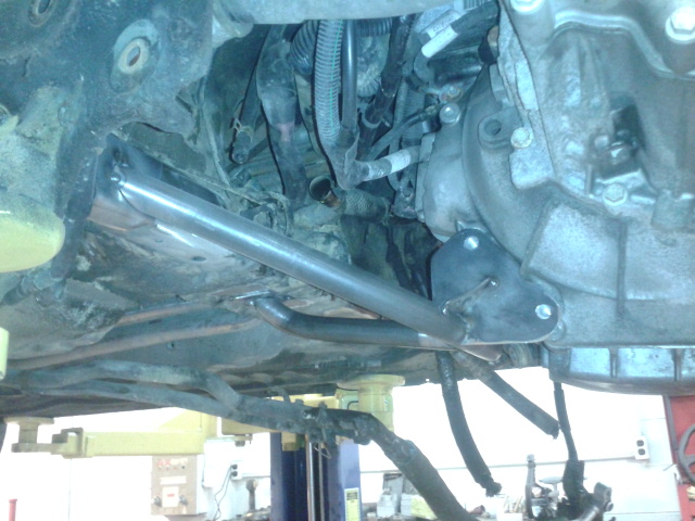

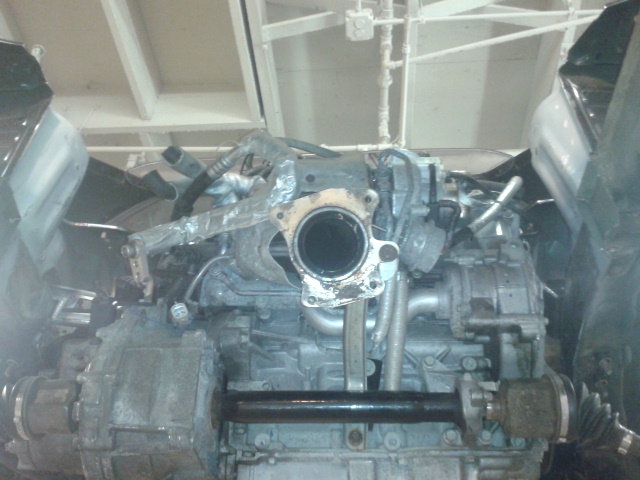

Posts: 36
From: South Jersey
Mo' pics
Lower front trans mount
Same mount/bracket without the motor in there
All kinds of room. We will be adding a few more chromoly pieces in there to tie in the suspension brackets and lower rear trans mount

underside of the motor
plenty of room for the custom exhaust setup to go in
