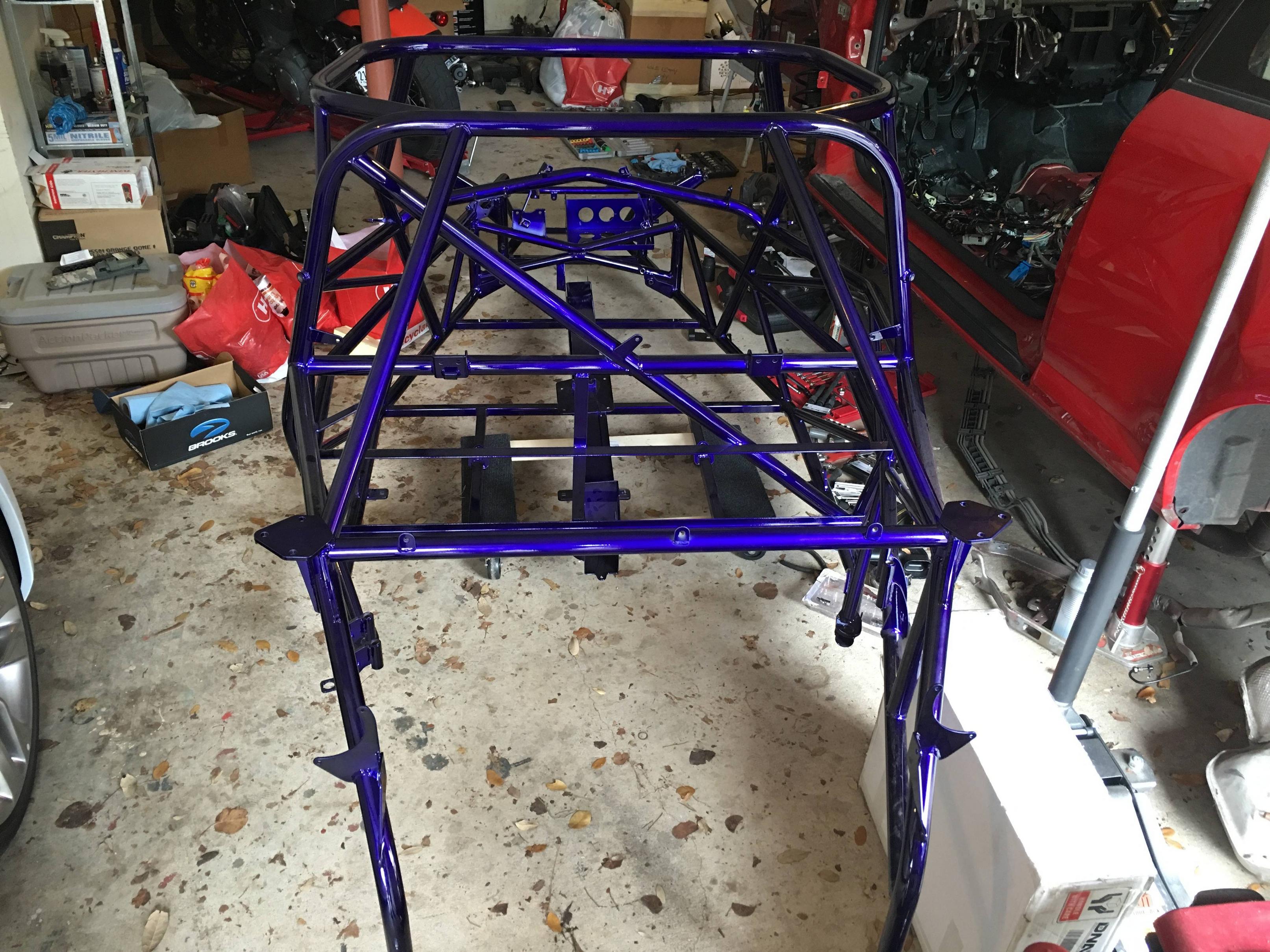

July 20th. 2016

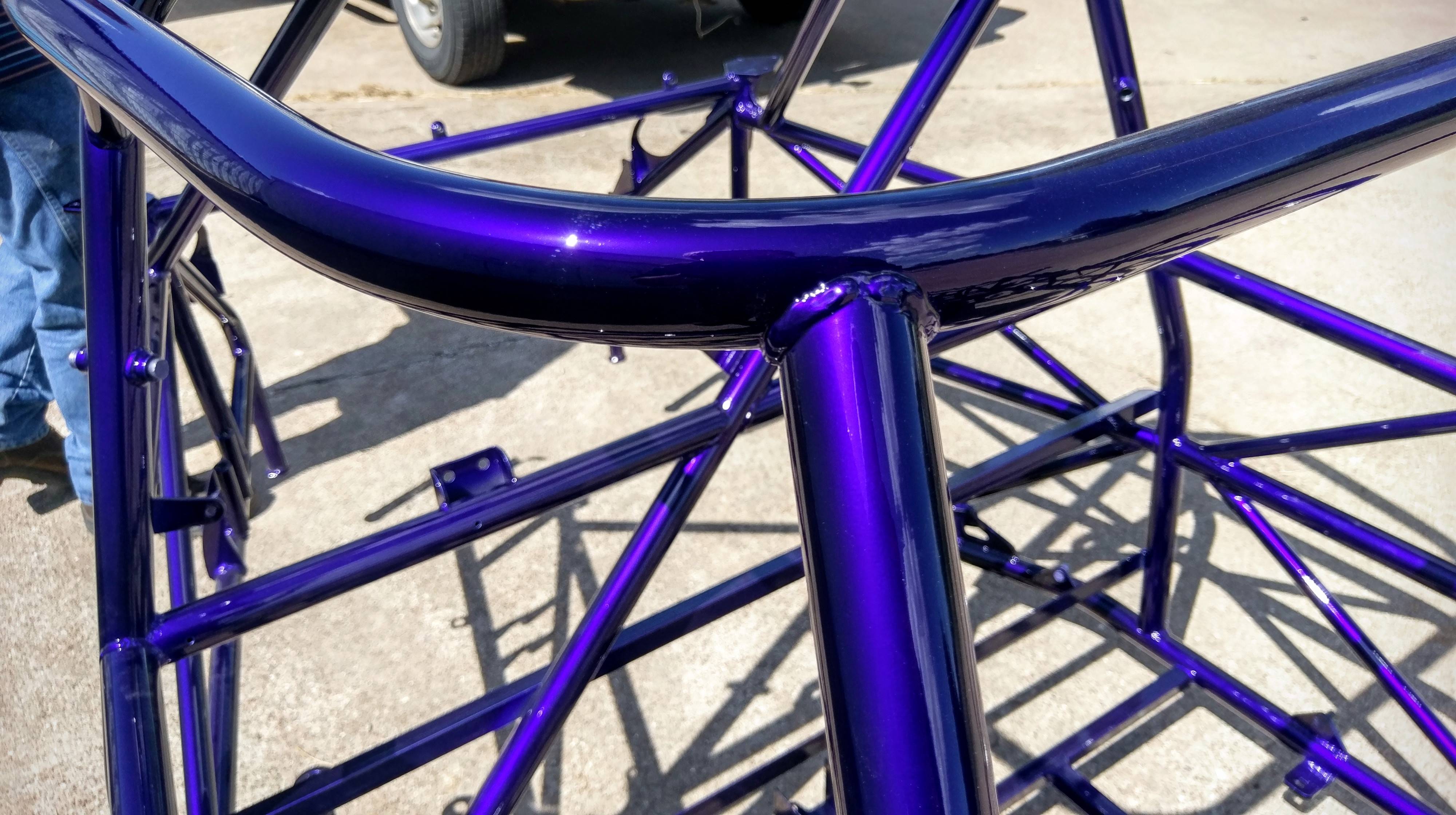

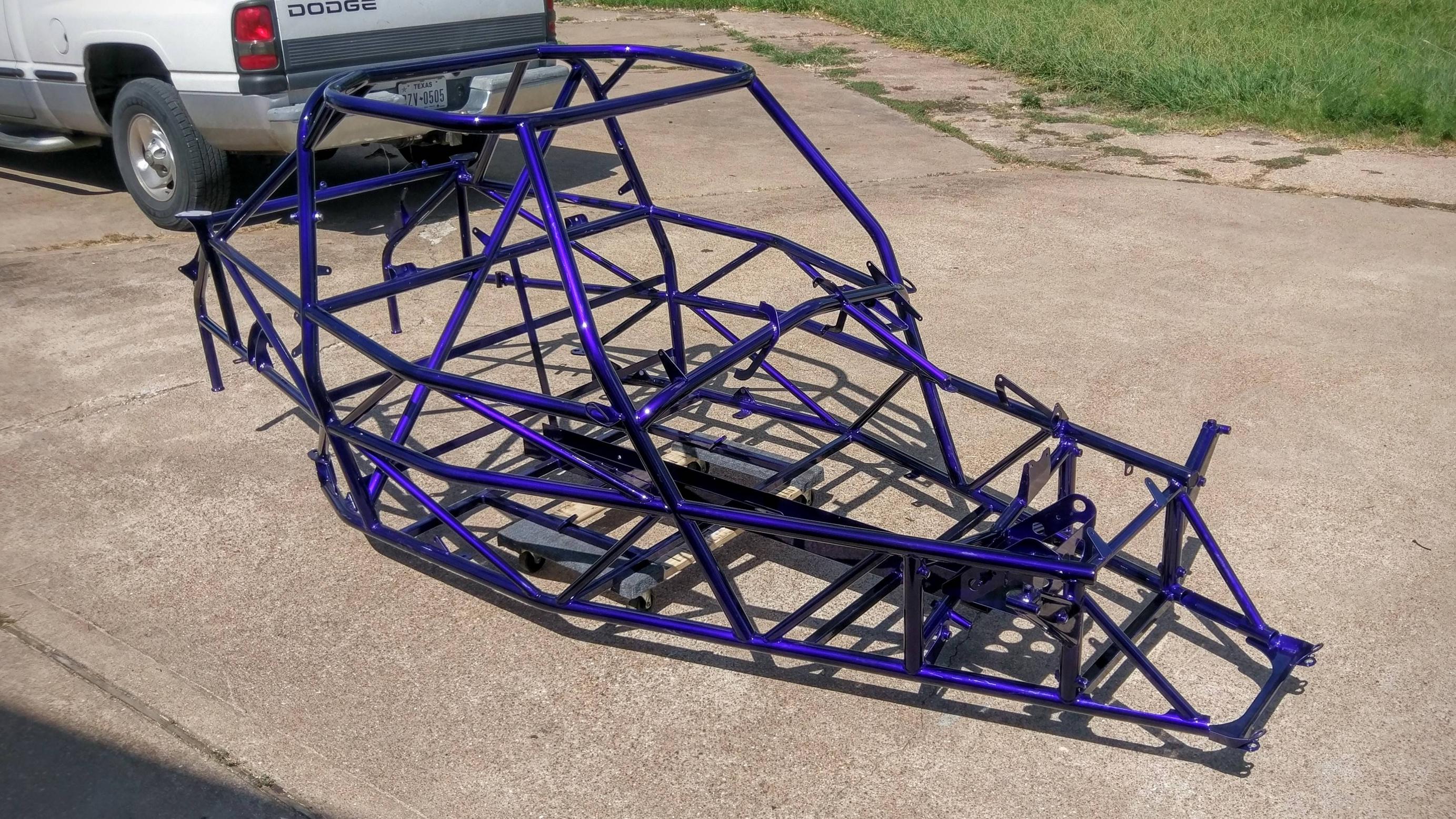

My frame for my car just got built up. I took some screencaps from the webcam that they have set up and also had Adam send me some pictures. Also decided on Illusion Blue for the powder coat!
Pictures of Illusion Blue powdercoat finish

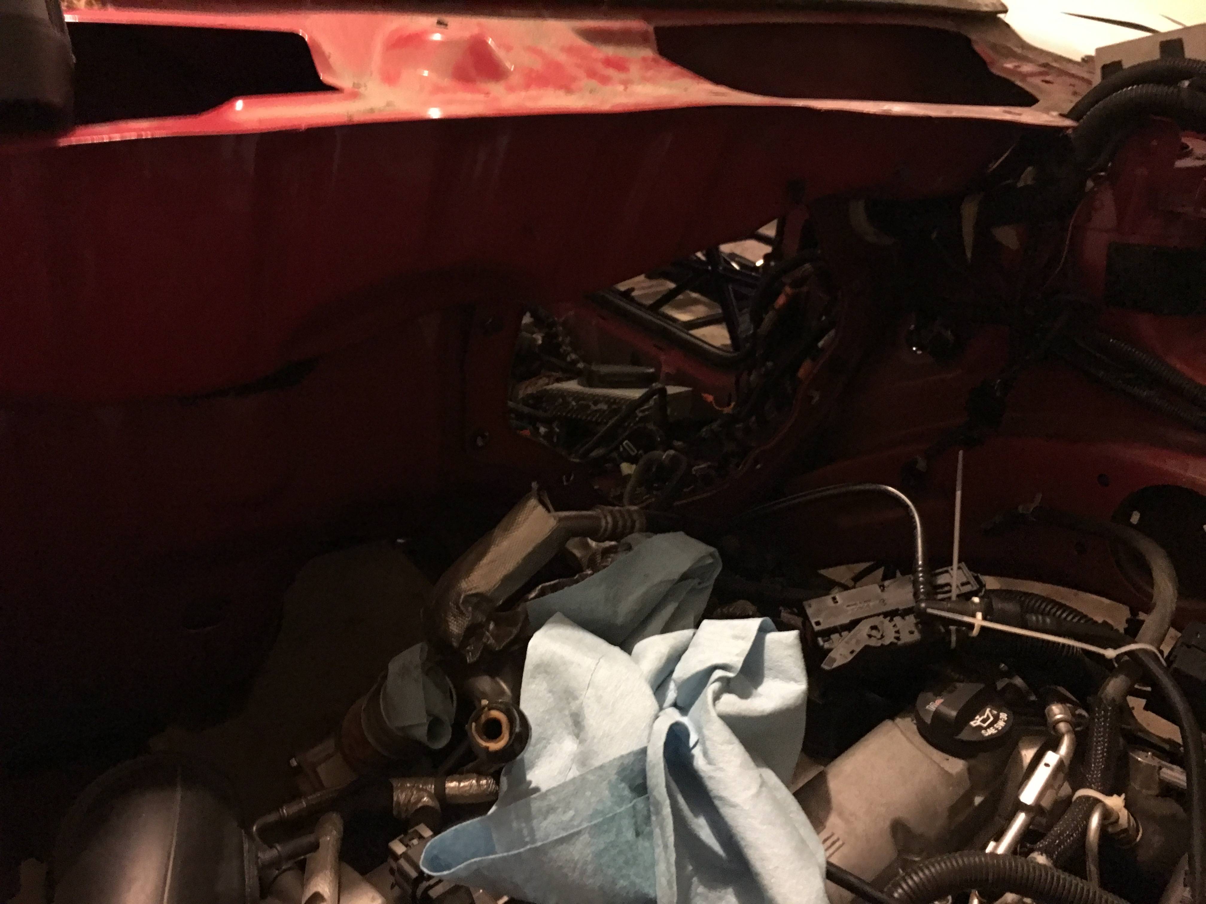

July 23rd 2016
And building on that, I kicked my tail into high gear to finish stripping my donor. Ended working till 4am on Saturday morning dropping the motor and removing any remaining hoses, tank, etc. All that remains at this point is dash assembly to release the rest of the wiring harness.
Also to note, removed the engine and subframe by lowering the car onto two small furniture dollies, and then lifting the car away. I was then able to roll the assembly away from the car. Almost time to dump the chassis!

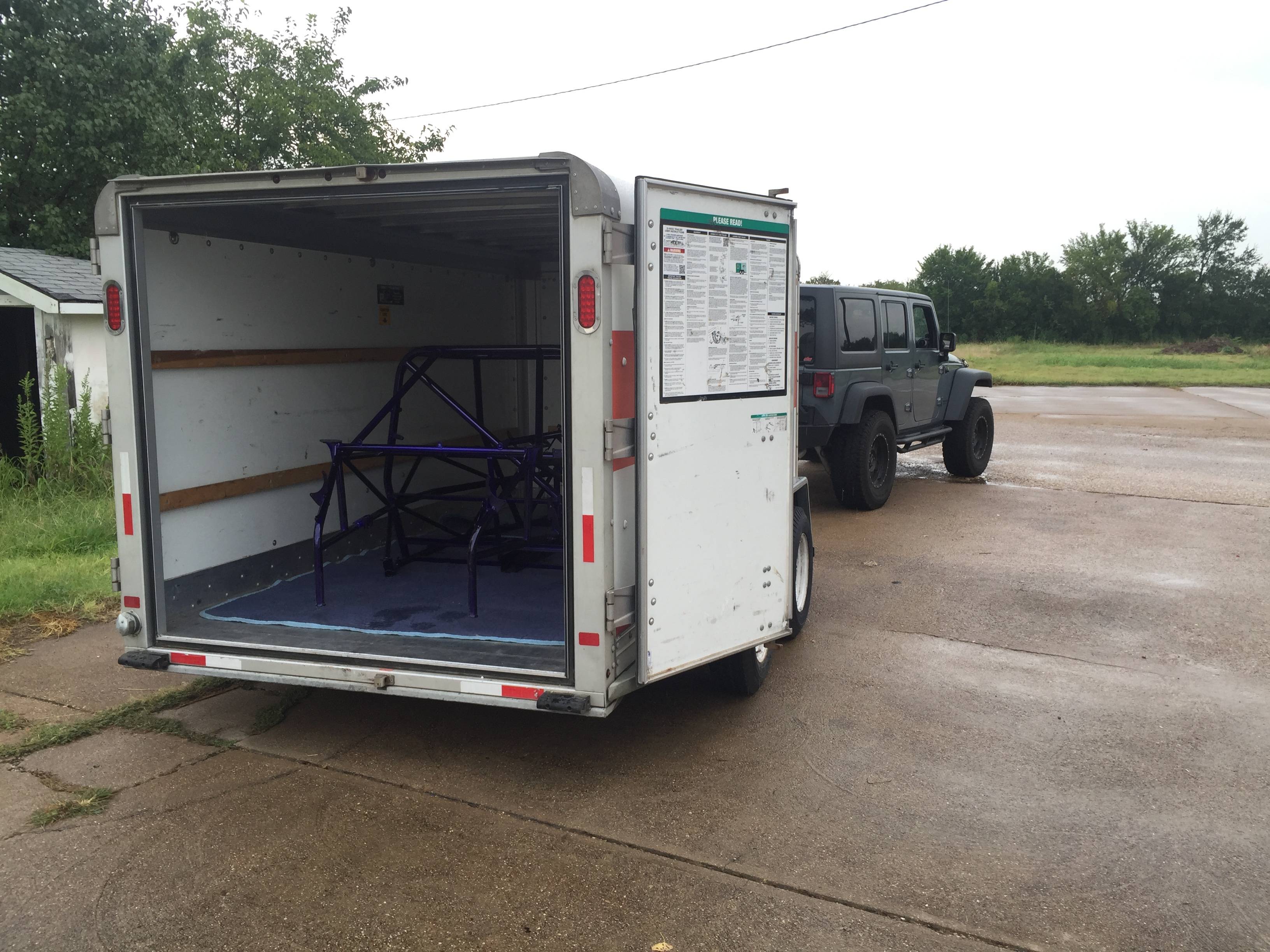

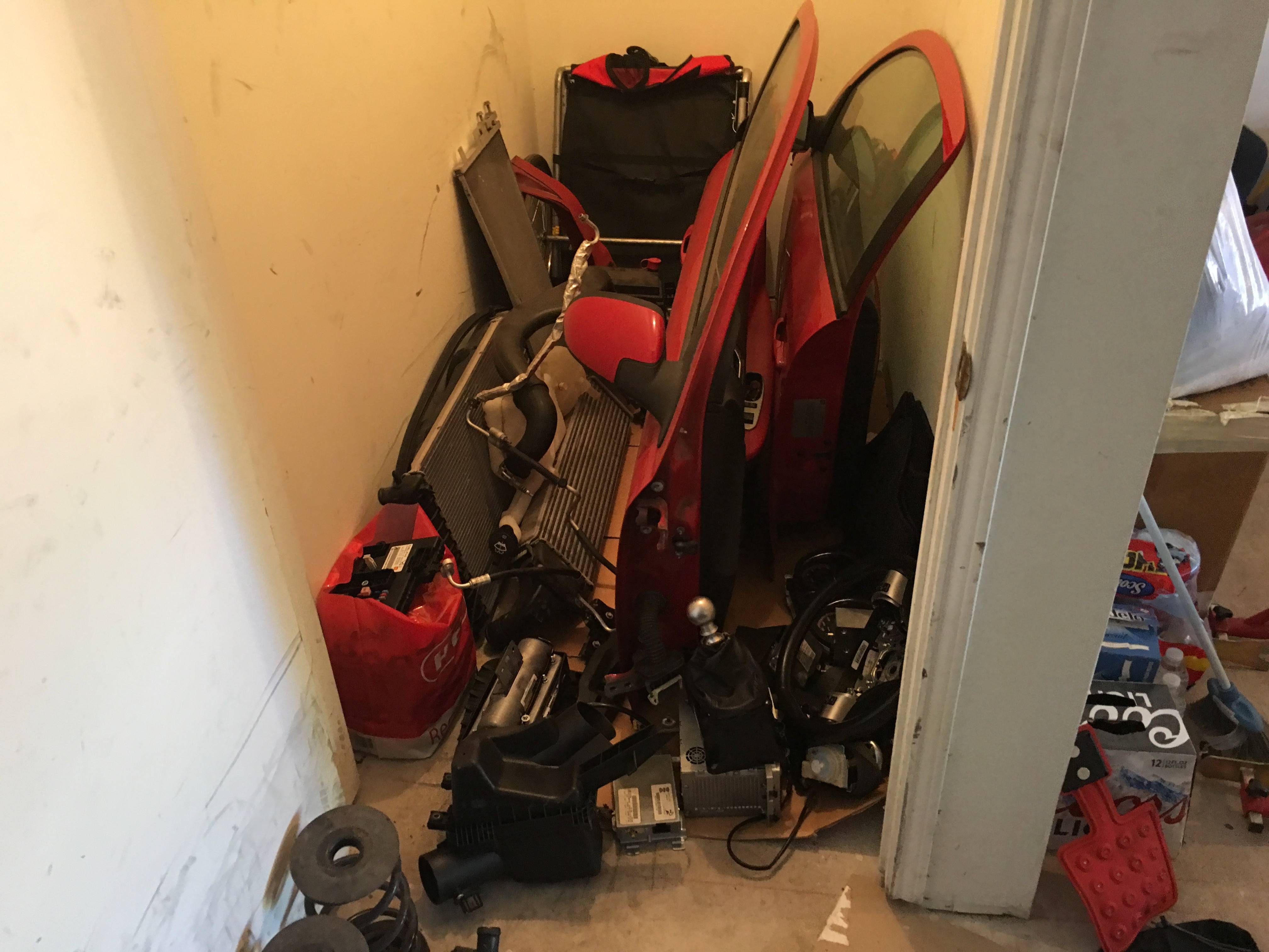

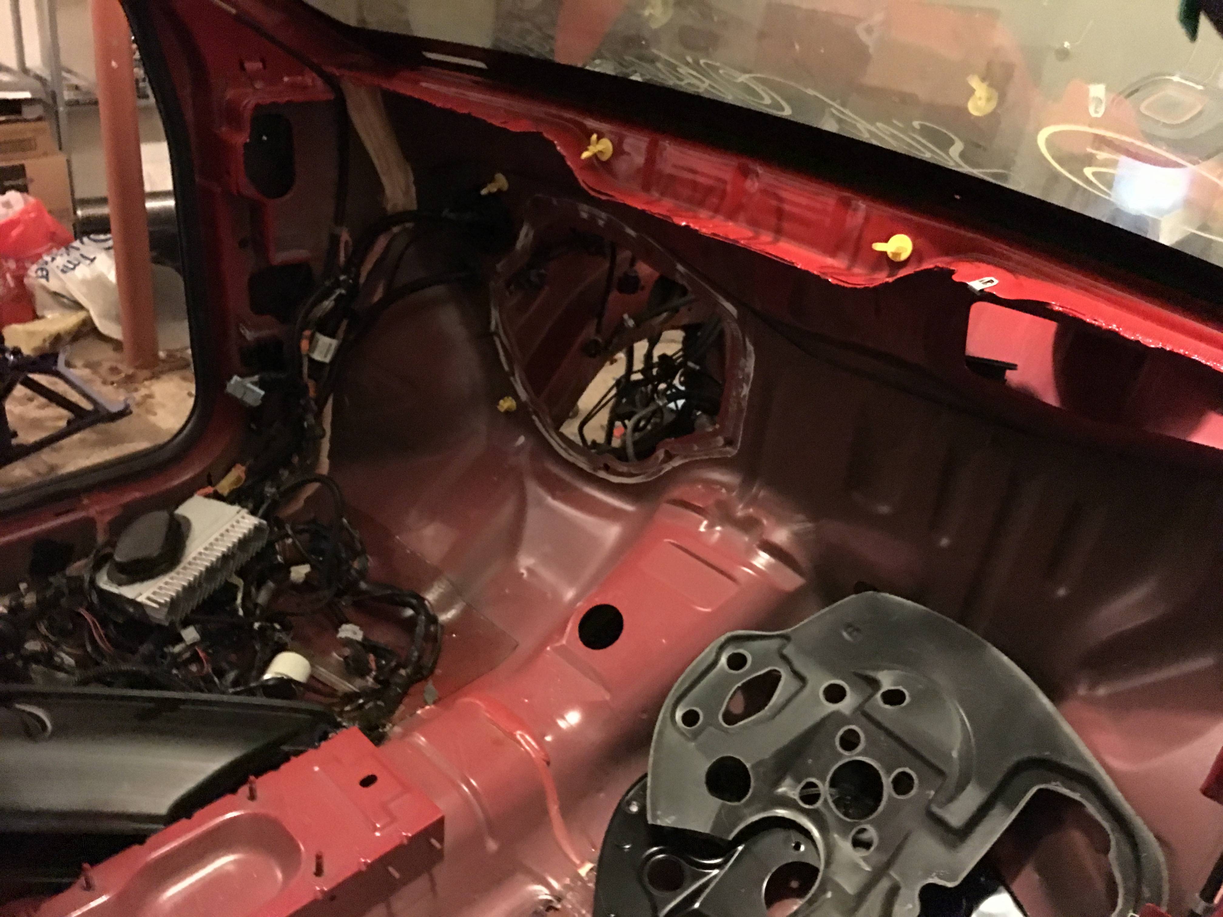

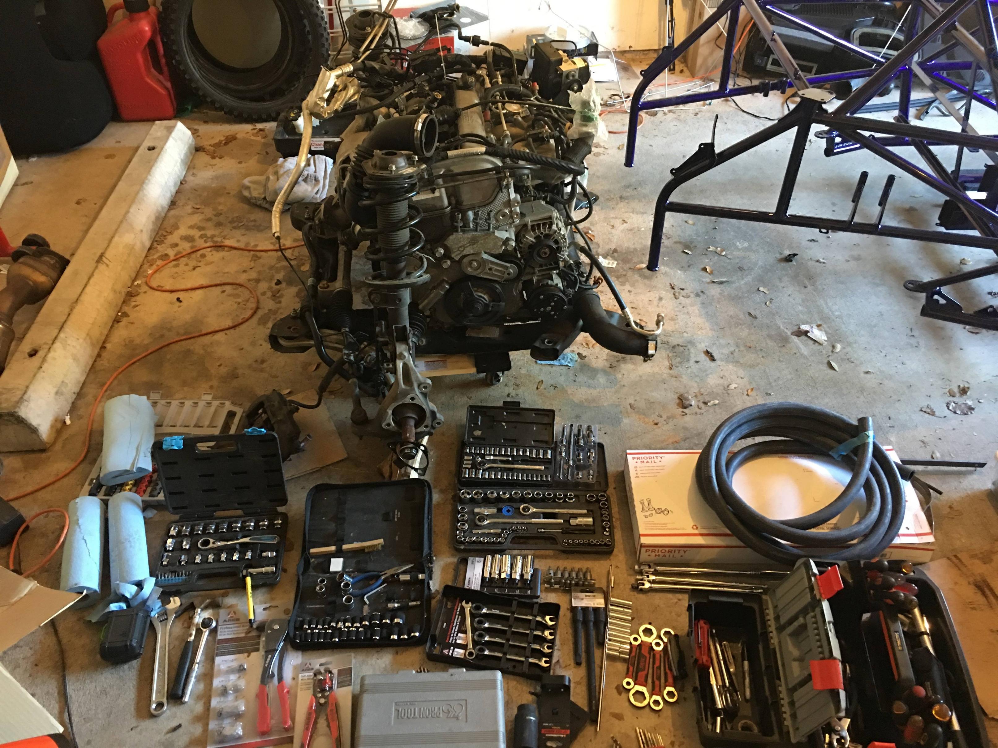

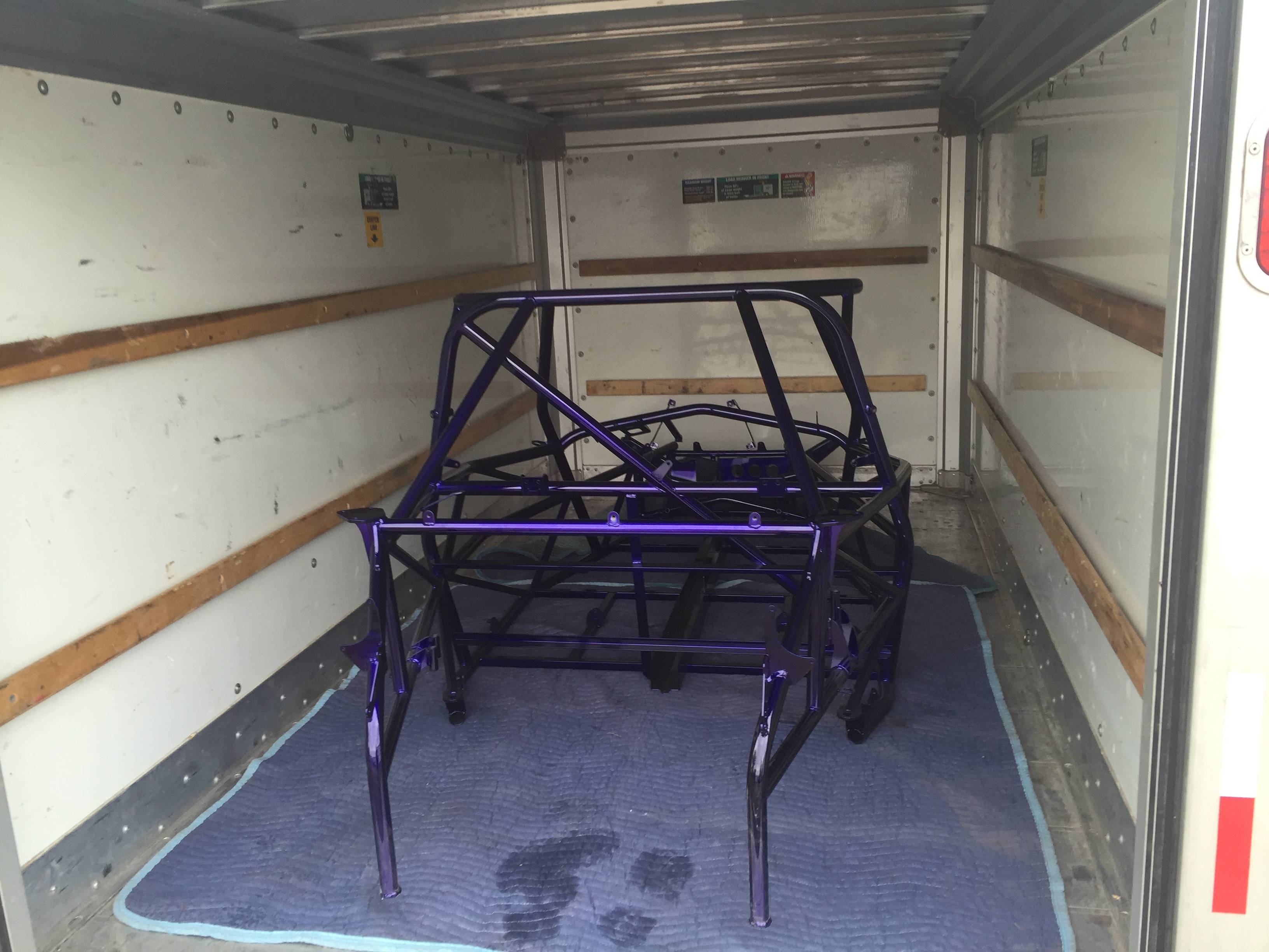

Time for an update! I picked up my frame from Adam about 2 months about and it looks awesome. Started a new job so I haven't had much time to work on it, but finally finished taking out the dash from the donor. The scarp body is ready to be hauled away finally!!

Love that color

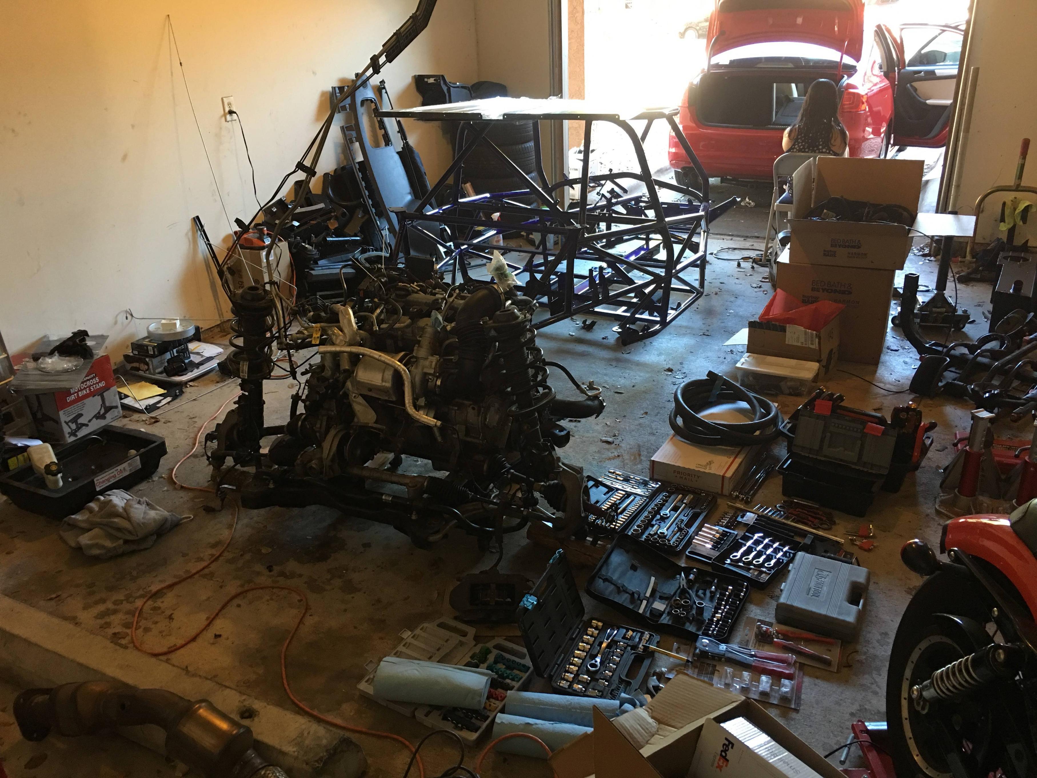

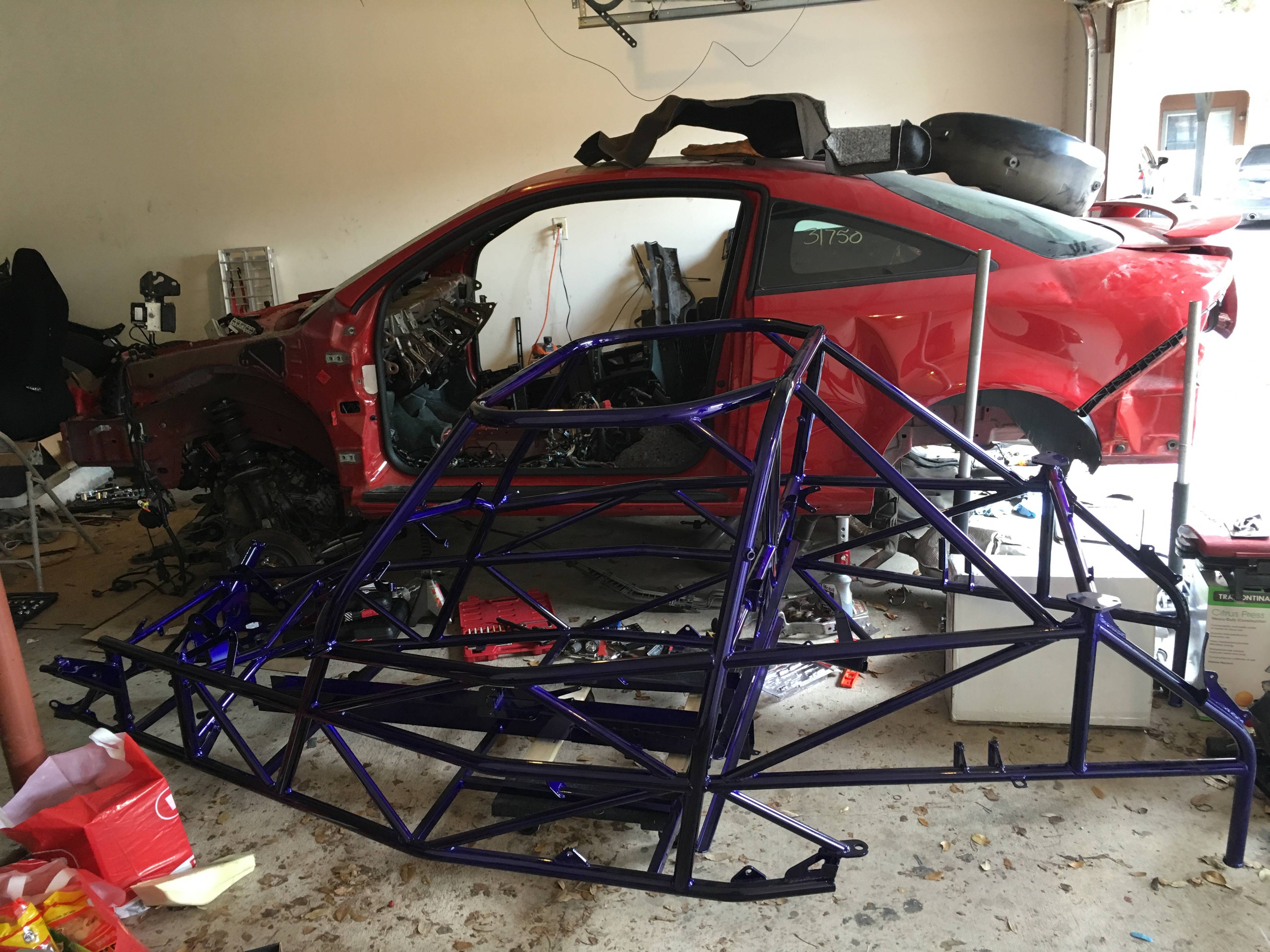

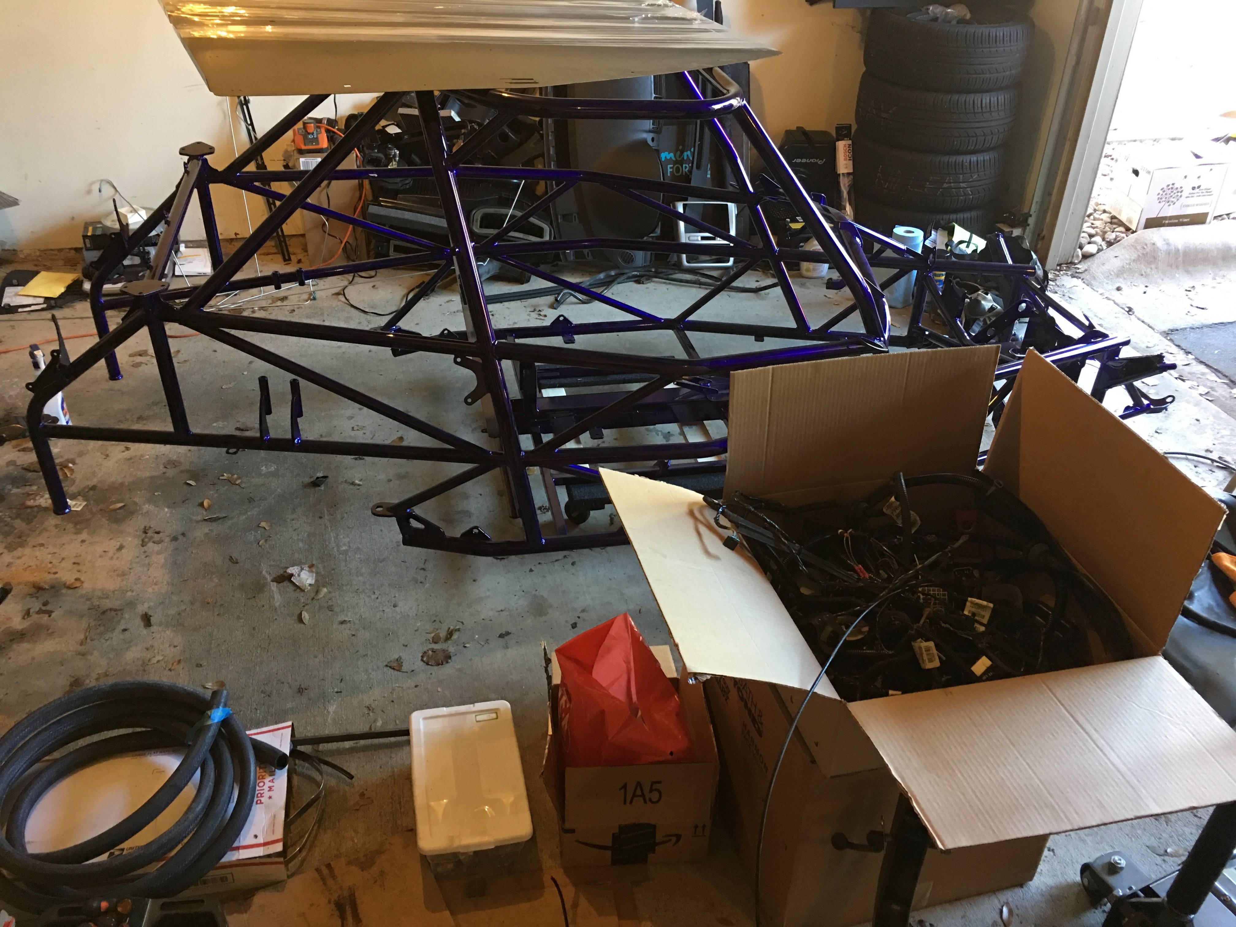

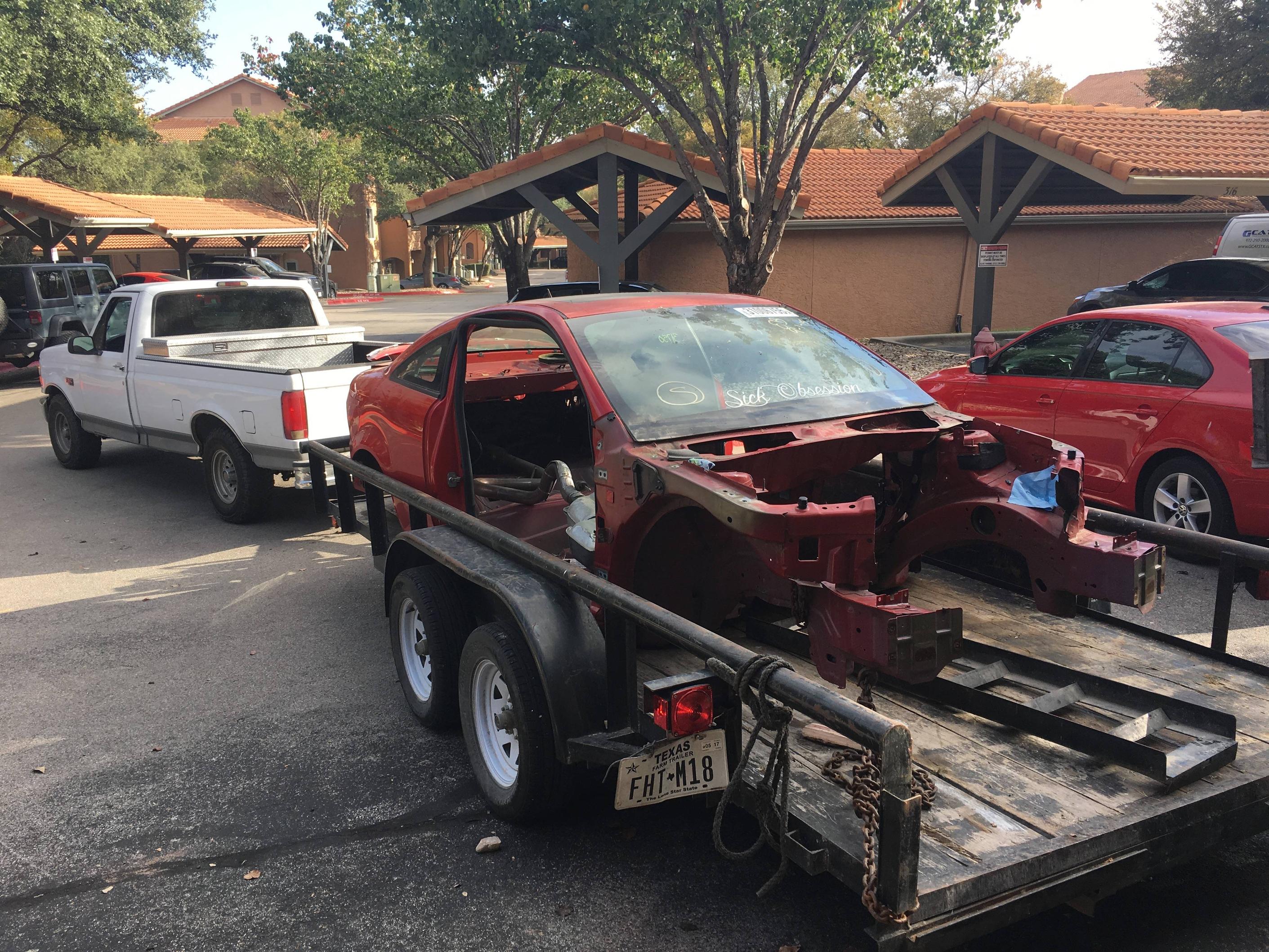

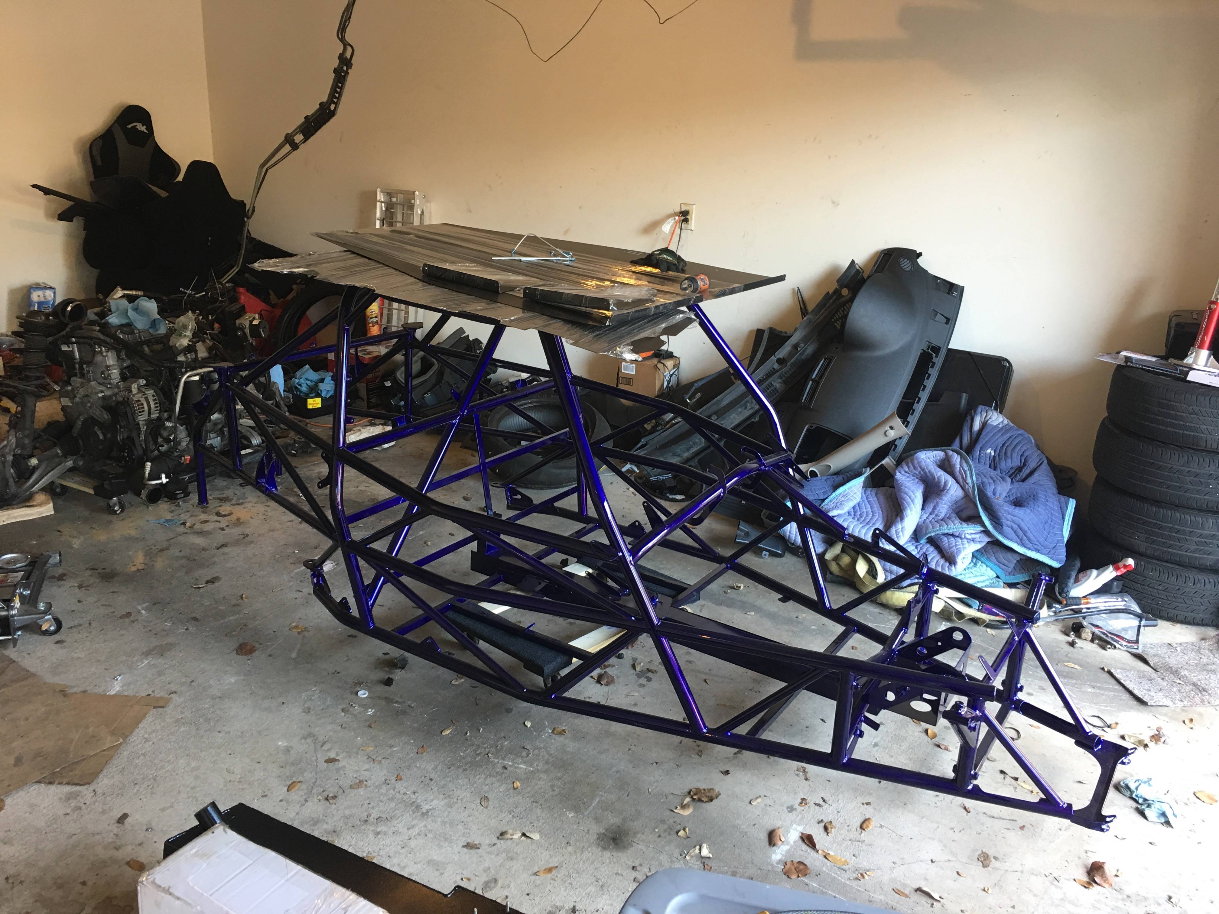

Finally got rid of the donor chassis. Tried out Facebook classifieds after not having luck on Craigslist and it was gone in a matter of days, at no cost to me. Did some much needed garage cleaning and reorganizing of my tools. Started test fitting the brake lines and riveted the front bulkhead.

Haha yup, my wife is happy that the donor is gone too.
