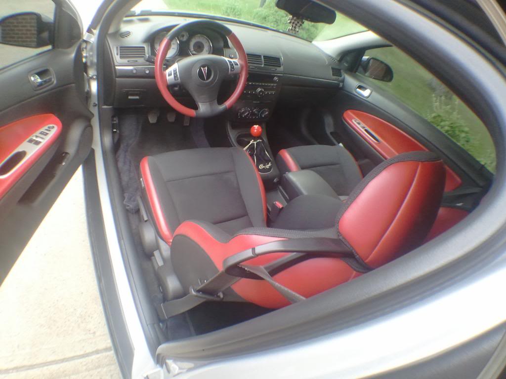

I am wondering if anyone here has installed an aftermarket shifter ball, in ivory, black, or red;
If so, I'd like to see some pictures;
I am thinking of getting a red ball shifter handle, and don't know if it might be too much in my all "ebony" interior.

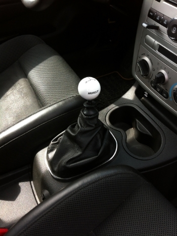

I figured I might update this with my results.
To recap, I wanted to change the look of my shifter;
I contemplated aftermarket shifters, but even the "best" out there appear (in their shape) to change geometry;
I didn't like any of the available knobs - I wanted a plain old simple Hurst style knob.
Then I read for every brand shifter there are people here citing shifting problems which I would be inclined to attribute to revised shifter geometry - so I set out to modify the stock shifter.
I had a local machinist turn down the shank, then threaded the top;
I modified the top of the reverse lock out (which slides inside of our stock shifter knob);
I am quite happy with it, I don't know how to explain it, but it feels better - the knob is set as low as I dare - the lockout will just barely eek by when pulled up fully.
Here's the final results:

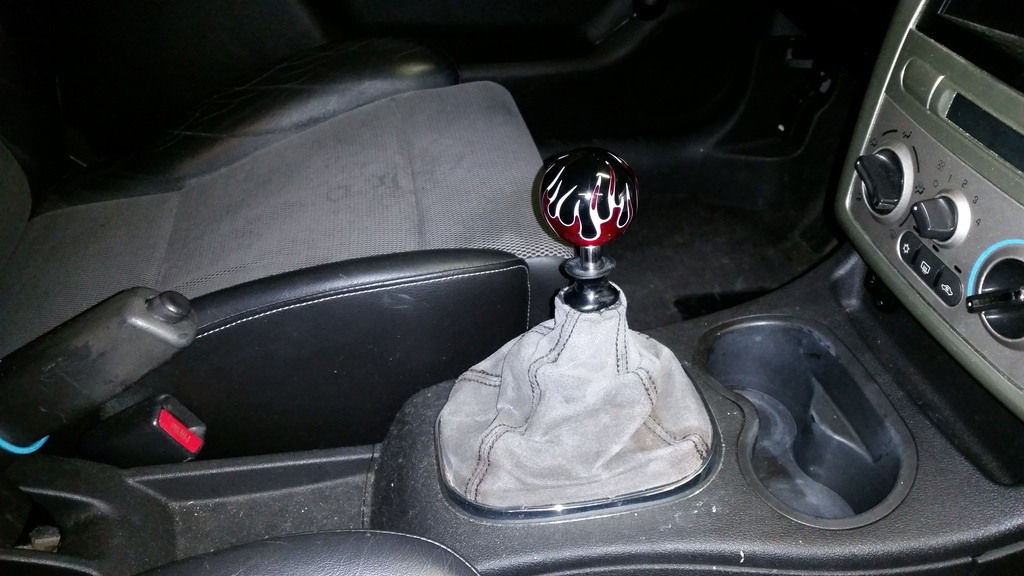

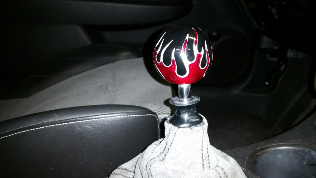

Today I kinda copied soundjunky and decided to try and install my own shift knob. I had a light up flame ball from my previous car that my wife got me for Xmas a couple years ago and didn't want it to just sit on the shelf anymore.
I cut 1/2 an inch from the factory stick and then threaded it 1/2-20 to match the ball and then shaved down the reverse lockout piece. The elastic in the factory shift boot keeps the rl mechanism pulled down so no spring is needed. I also pulled all the leather bits away from the cloth since it was falling apart pretty much. Shifter boot is next item on my list. I went ahead and polished the factory shifter stem so it wouldn't look so dull.
Another view;
Another view;

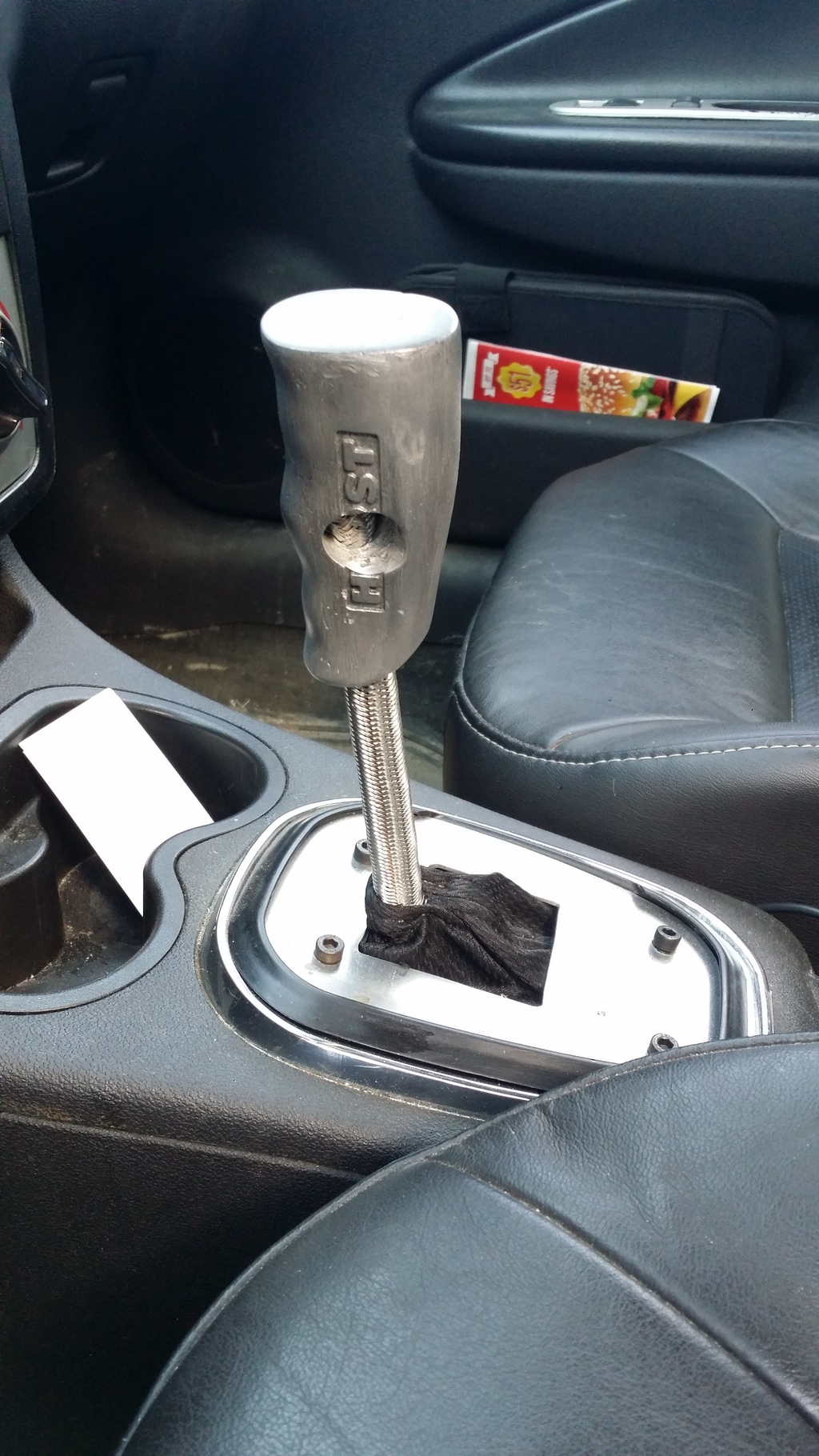

I found an old Hurts T-handle shift knob that my dad used back in the 70's. At one point he had threaded the side to change it to a pistol grip. I found it in his tool shed last weekend. Just sanded it down quick and slapped it on to see how it fit. Looks a little retarded ATM, But I have some work to do to it still, and it fits good.
