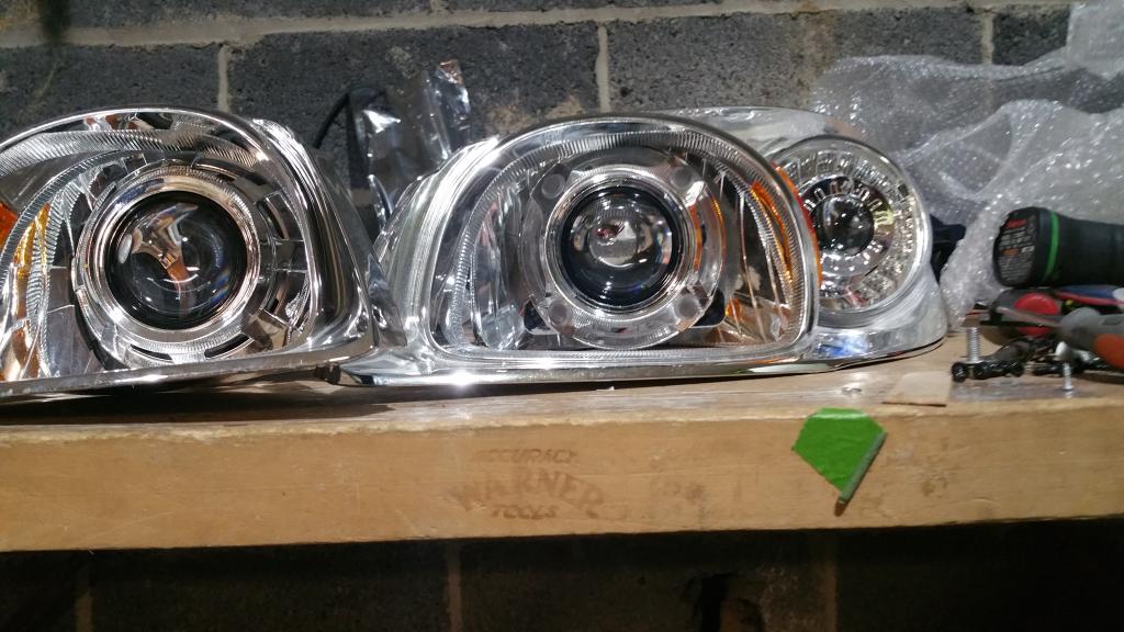

Hey gang. Pretty rare for me to be making a thread nowadays. Decided to finally make a build thread. Not a car build thread but instead for my lights. Multitude of requests have been submitted and well i decided to finally show a glimpse. Not just because of the requests. I also gave my word to Justin over at D51 i would show a sneak peak. Not for nothing i see TODAY a "quad" setup teaser pic and all i can do is face palm . 1 projector looking at you and the other looking at the car over next to you........................enough of that. Onward laddy
So lets begin. My car has seen way too many retrofits in its lifetime. Ive owned it for almost 3 years now. ok maybe 2. Started to get deep into retrofits at the end of 2012. I could never hold onto to a set because in my mind. Everything has a price. To an extent of everything of course. One day i sat down and thought to myself. What do i got to show on my car to define me and my dedication to the car.( It already has a built motor and turbo swapped. 07 lsj btw with 32k miles on the body at the moment.) I decided to make a unique set of retrofits. TADA. That will be it. I went back and looked thru almost 3k+ photos. Man did i do a crapton of retros. i counted almost 45 cobalt retros. A few oddballs here and there. Alas i looked thru and NOTHING tickled my fancy. Then 1 day i decided hey i wanna use my car during winter to get it retuned. It sat in the driveway with no headlights. So.........instead of me using a stock pair of lights to drive the car, i made a quick retro.

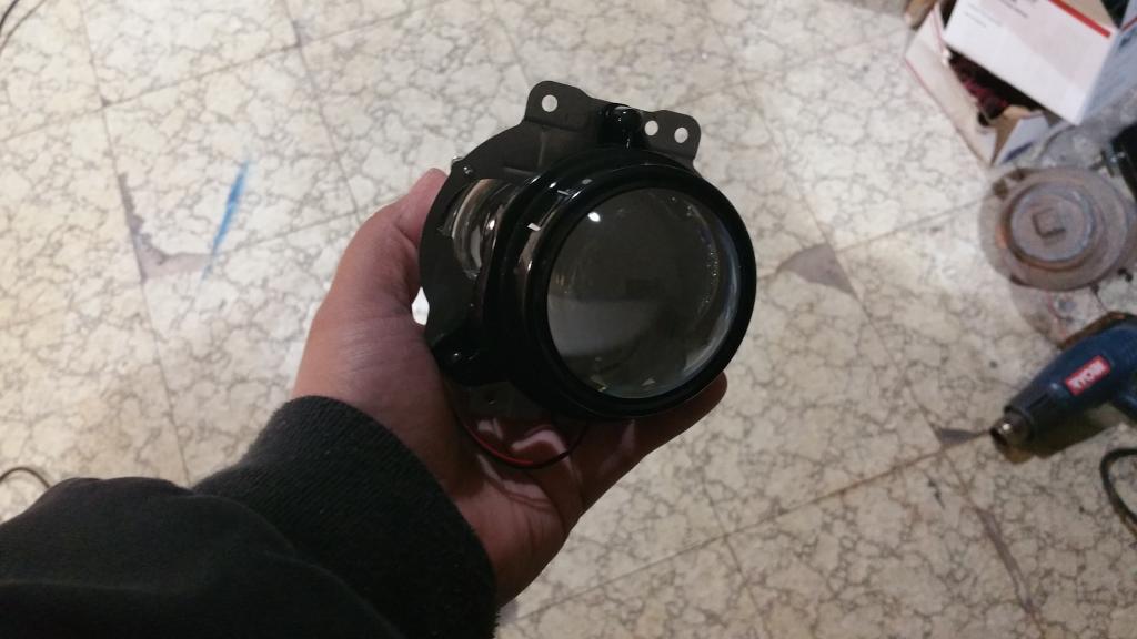

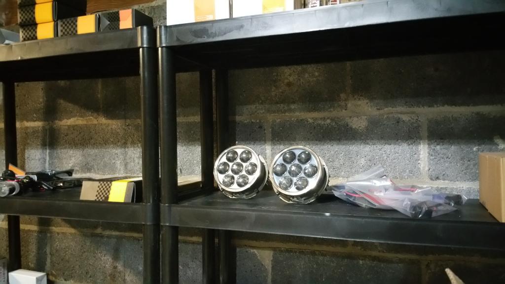

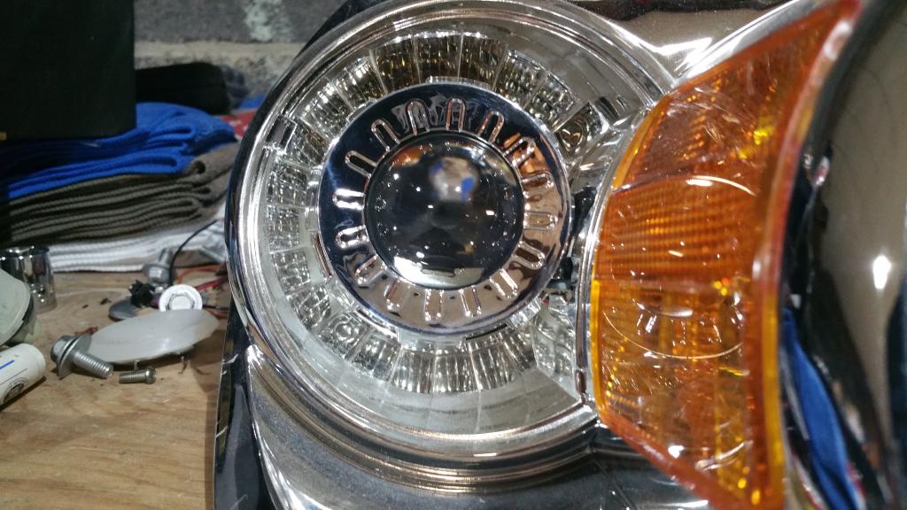

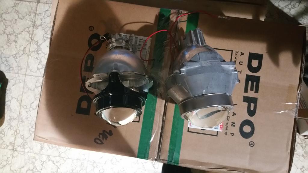

You guys probably know them as i already had them for sale after i got the car tuned. Just your simple mini d2s setup with a nice SS etching in it Blue halos and cool white demon eyes. I did test paints with it . Blue flakes on white. lol. Just ok in my eyes. wasn't for me. However. these have been on the car for almost a month. Record breaking actually.
After the retune. I began to work on what i wanted. I thought about what to make while doing a 3rd gear pull getting data logged. only 21 psi since its cold so don't worry. Not going fast.

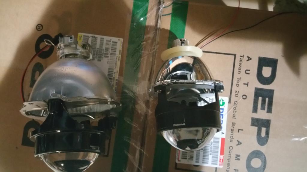

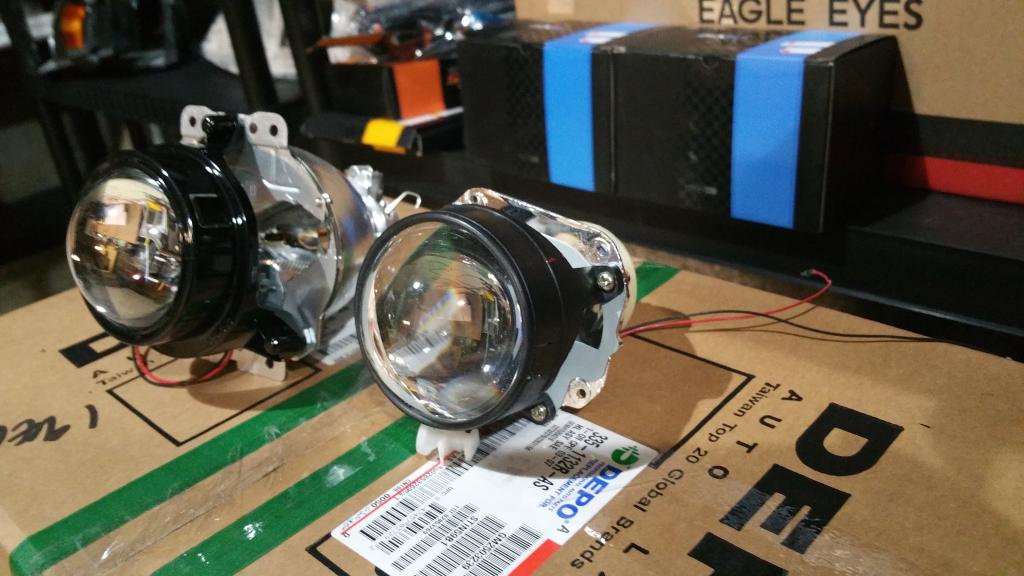

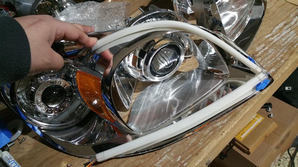

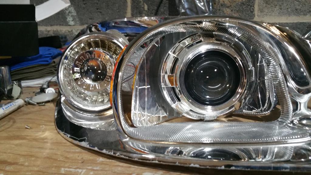

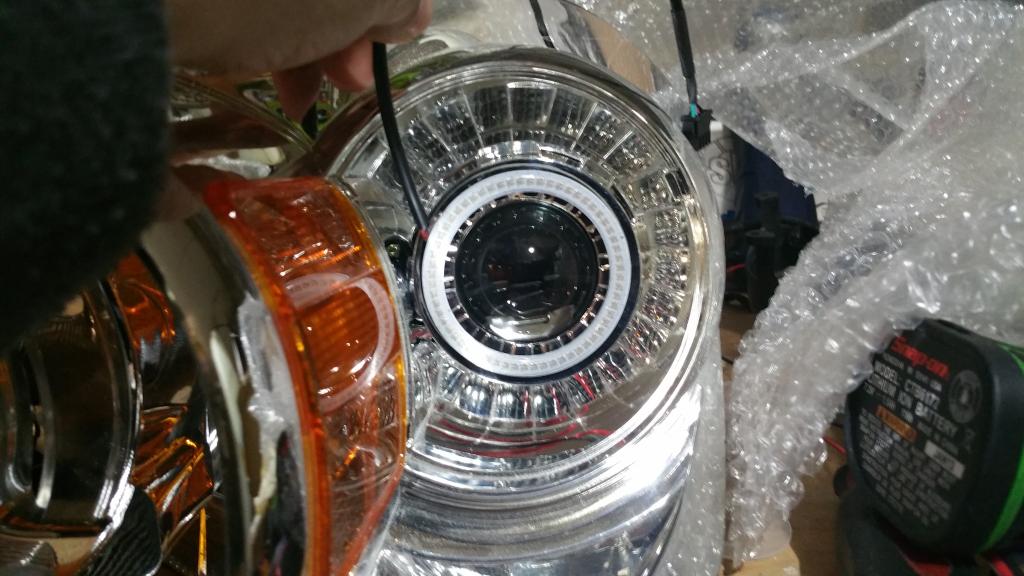

I decided to make a QUAD setup and not just for looks. More for FUNCTIONAL purposes. I bought a few things i aint have like the 2nd set of projectors. At first i was going to do a simple setup using a custom projector but I'm going all out. Why not? I take pride in my ride =]

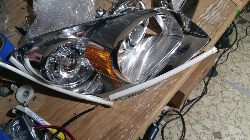

I took the guts out of an OEM set of lights. Began to test fit stuff prior to cutting. Hit a brick wall. Thought of how to come around it. Found out how. Morimoto Matchbox 2.0.

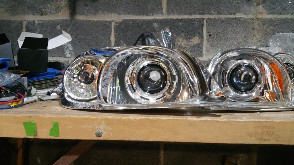

Even with this tiny projector. There was A LOT of cutting involved. took a few hours to get it where i wanted it. Pics show what i wanted. I then knew this was a GO. I took out my TUNED Maxima OEM projector with Black series lenses . i also got it converted to BI XENON. To do so it cost the price of a mini h1. So i sacrificed it to the retro gods. BOOM. bixenon tuned maxima projector. I tested the light output and well FXR and got NOTHING on these. The light output pics are for a later date :3
Size:  82.1 KBName:  20150128_185033_zps3t22lchm.jpg
Size:  57.4 KBName:  20150128_185103_zpsktp4d5c2.jpg

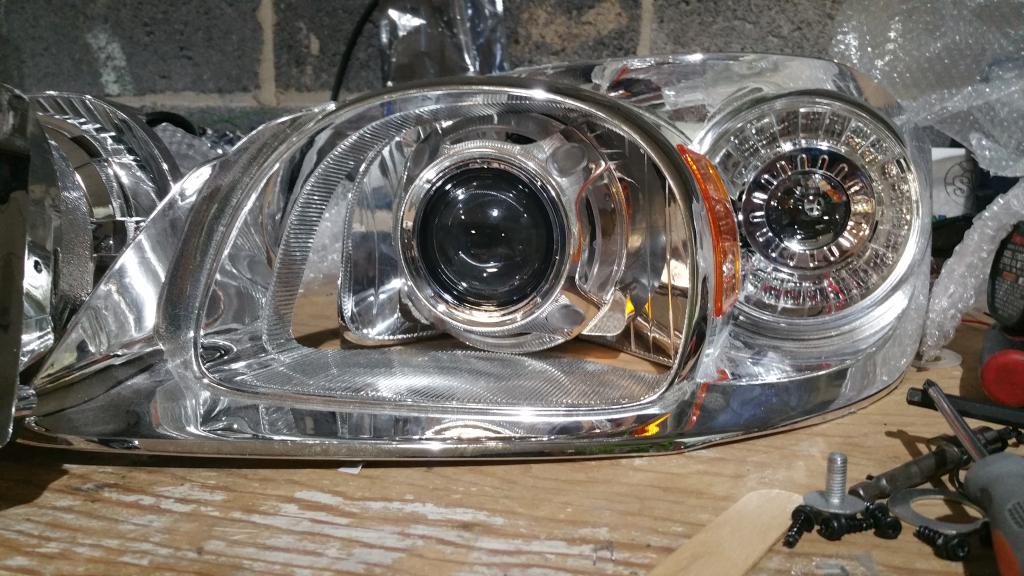

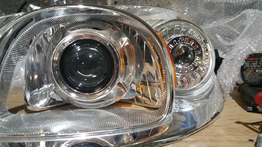

Started the process. Got stuff cut up. Fell into a pickle. Could not decide between shrouds. Of course i couldn't decide. They look so cool. I started to go thru my collection and found 2 candidates. Apollo v3 and the famous Panamera. I was leaning towards Apollo but panamera may be on the car in near future.

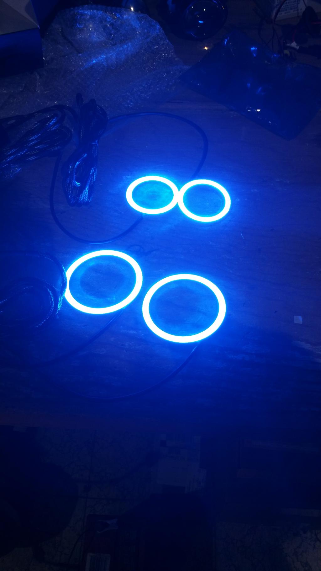

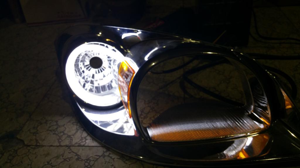

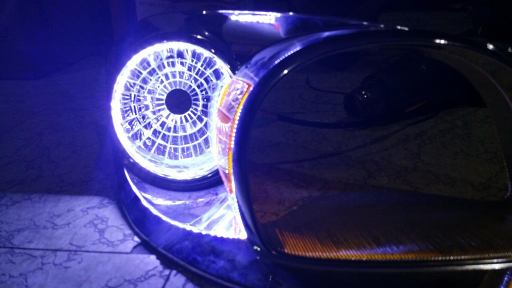

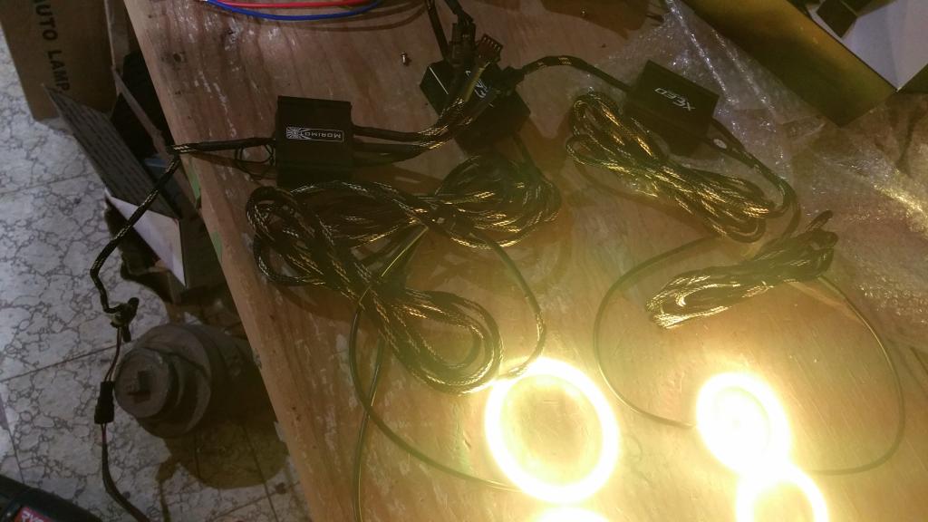

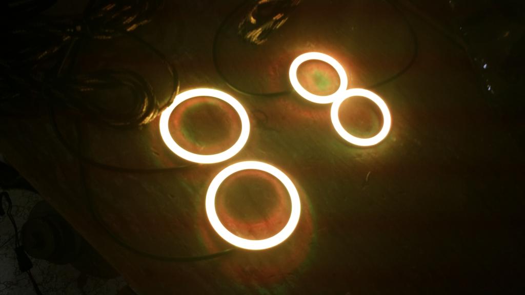

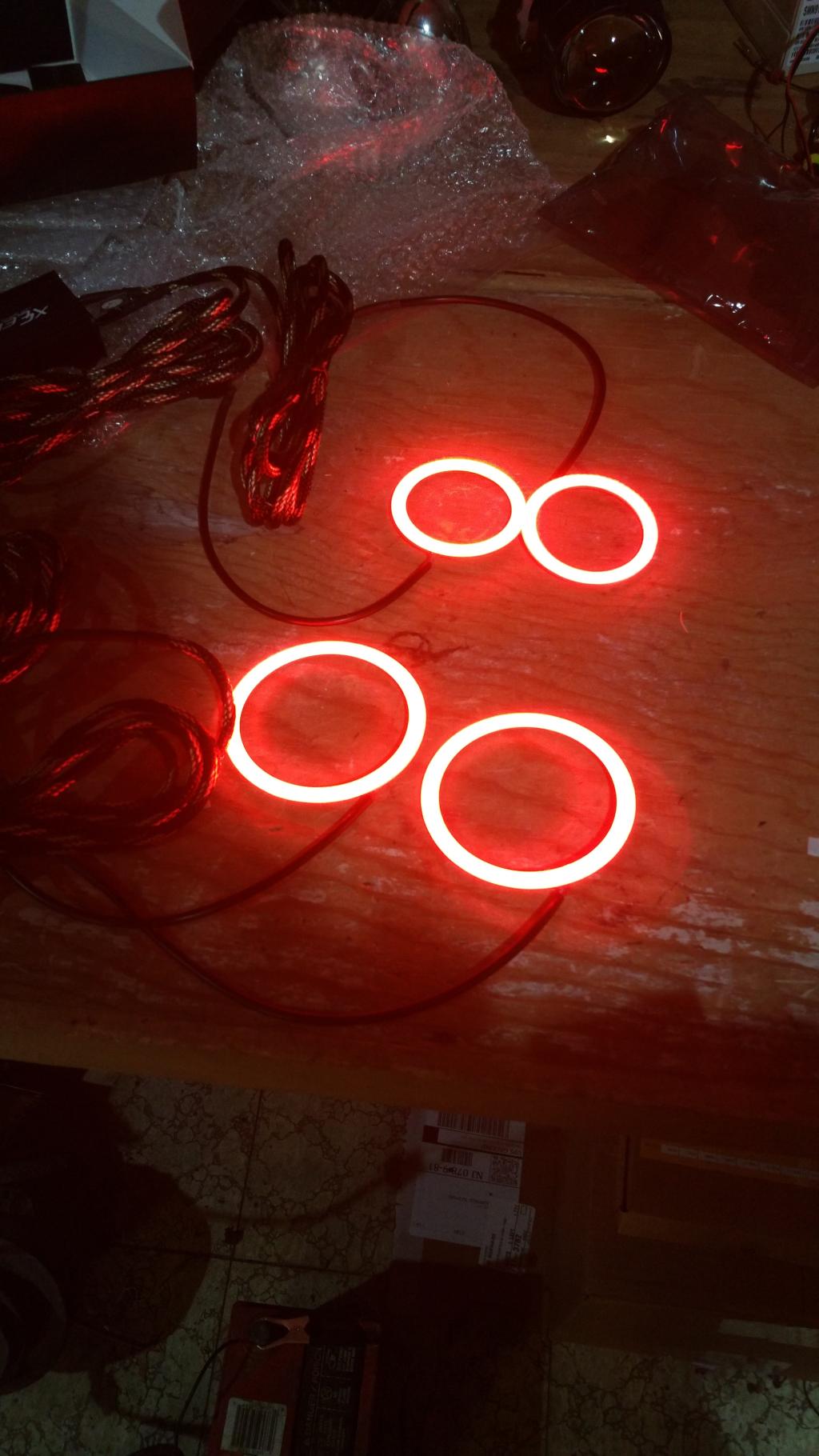

Now the fun part....HALOS!!!!!!!!!!

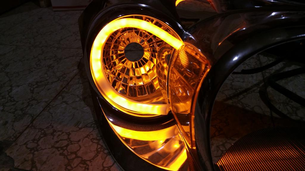

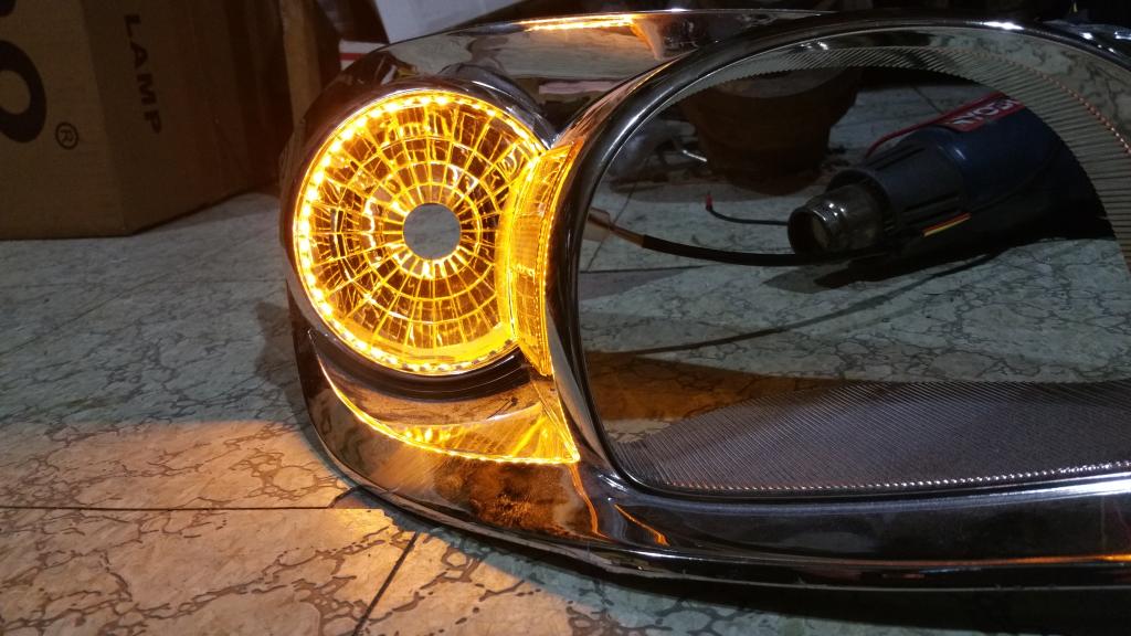

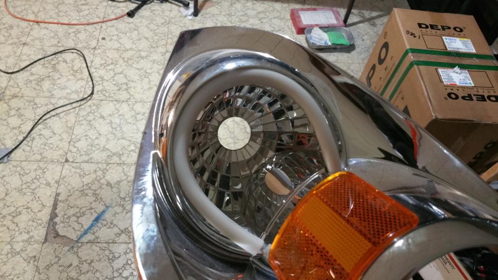

Ok I'm down to the last few things and 1 MAJOR item missing. My turn signal. I attempted to relocate my turn signal however i felt comfy with. This was not happening so easy. I was going to use double led for switchback but too small. I even bought the cheap silicone tubes on ebay. Def bad decision but i needed the ideas. I positioned them in diff locations. i still can't decide which imma use. The final product being used will be from Diode Dynamiks. Decided to go naked on this 1.

Amber totally sucks.
It will do though just because i know DD will be way brighter and way better quality.

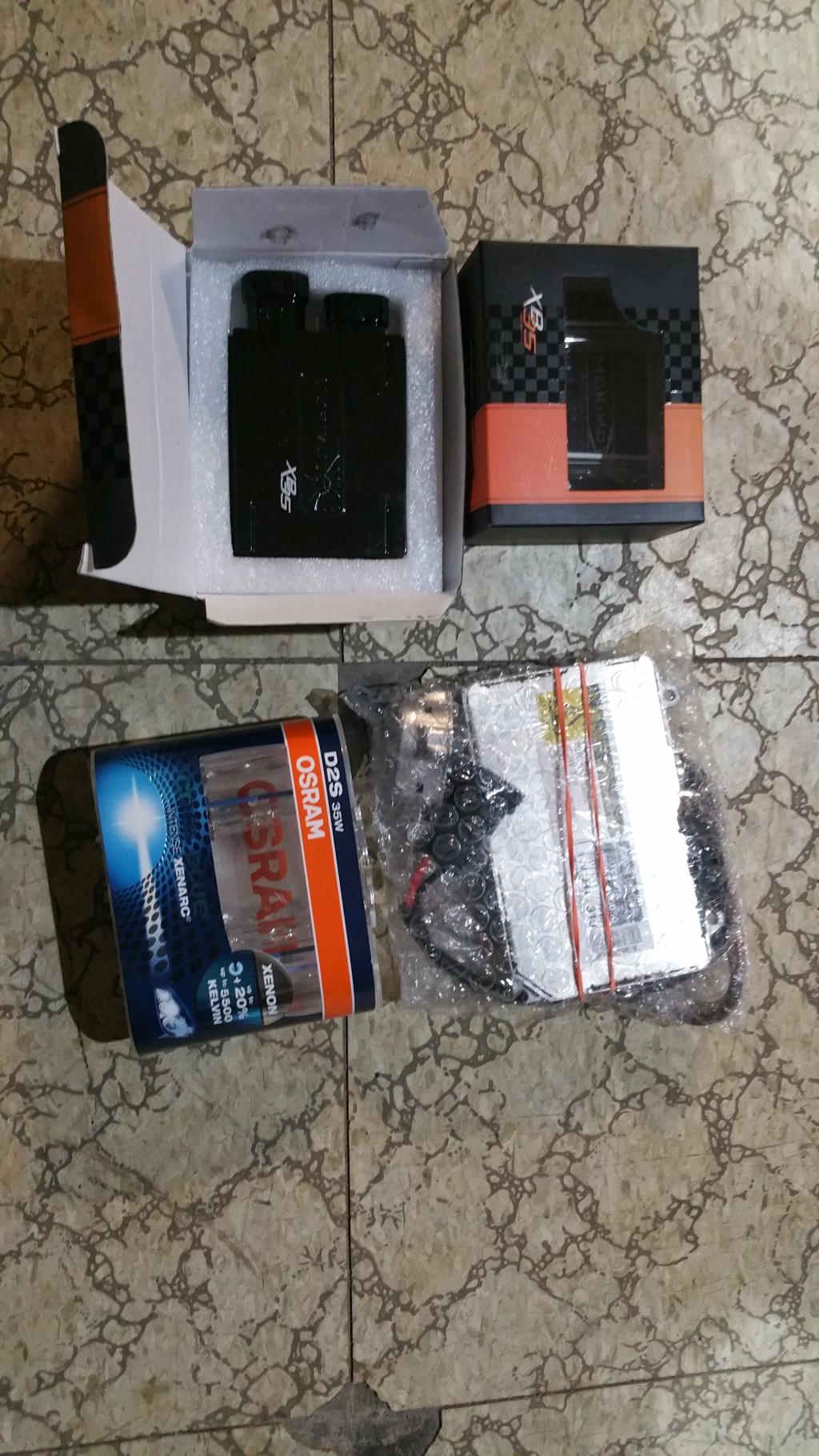

to power on the matchbox i will be using XBh1 bulbs and to power on the maxima i will be using Potted Denso ballasts with CBI bulbs. All brand new.

another random pic......i play with these a lot actually.
see how bad the amber is? totally blows

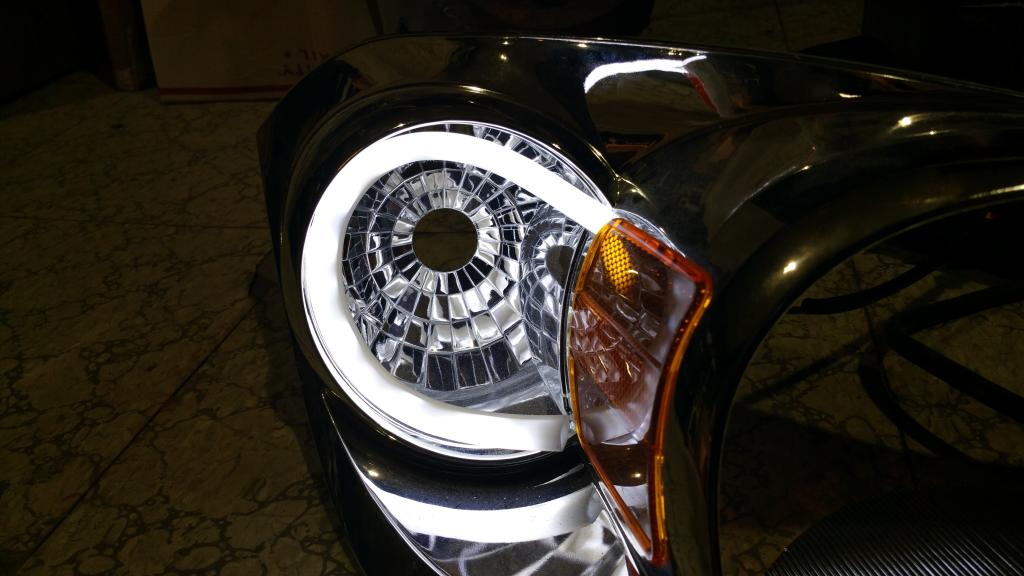

Man i really like the way the turn signal is going to light up like in the last pic

same here. You gotta keep in mind this is on Chrome. Once I'm done coloring. It will be a lil dull. So switching it out for a better led strip should compensate. As i hop. lol.
