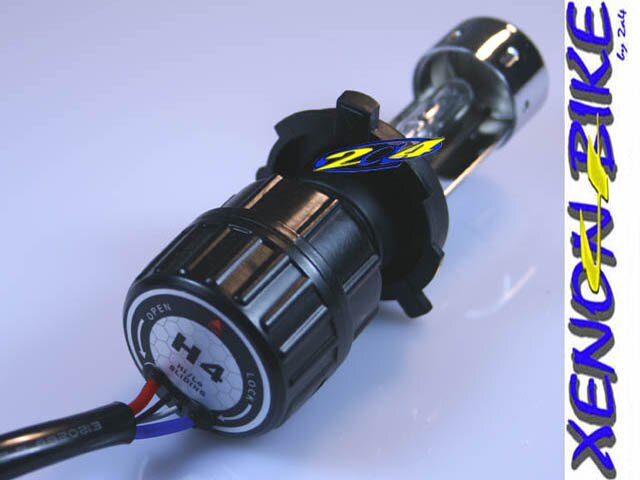

Yes, it moves to adjust the beam.
There should be a second set of wires coming from the bulb that controls this.
As you can see on this image, there is are a set of thicker red and blue wires...they are the supply from the ballast...
The black and white, smaller wires control the beam.
