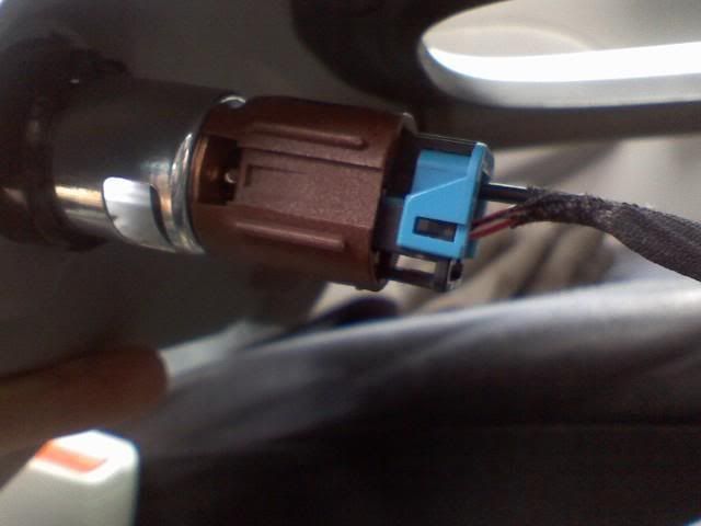

HOW Do i Unplug this ? ? *pics
its the 12v plug under the center console.....
Old Jan 2, 2009 | 03:59 PM
Herndon_High_SS's Avatar
Joined: 12-15-06
Posts: 4,003
From: Herndon, Virginia
Well first you gotta pull out that blue tab. After that, I believe you just tug until it pops off.

oh so u just gotta really yank that clip off after the blue tab,. okay i'll try , it just seems like its raelly tight

No dont yank on it. It is held by the black section by a little tab. You can clearly see it in the picture a little bit to the right of the center of the picture.

Ummmm, No , There Is A Push Plug On The Bottom.dont Pull Off Any Blue Tab And Ref On It Till It Comes Off. Press On The Bottom Side That You Cant See And It Will Just Un-clip

Blue tab off black tip.

If You Pull The Blue Tab Off The Plug You Will Damage Or Pull The Wires Right Out Of The Socket. Press Up On The Bottom And It Will Come Out

push the black tab on the bottom of the picture then it slides out
EXACTLY !

no dont remove the blue clip. that releases the wires outta the plug. hold on im makin a picture for what to do.

Originally Posted by bboyfreeflow
blue tab off black tip,,, then push bottom of black piece to pull the black clip out right?
DO NOT TAKE THE BLUE TAB OFF ! JUST PRESS THE BLACK TAB ON THE BOTTOM UP .
DO NOT REMOVE THE BLUE TAB !!!

my fingers are numb, maybe cuz its like zero degress outside,, but yea i cudnt ****** unclip it, idk what the ****. i tried pressing on the bottom and nothing budges

lol is right, i just went outside and unplugged it no problem, i think yesterday my finger tips were just numb as **** right wen i stepped outside so yeah
