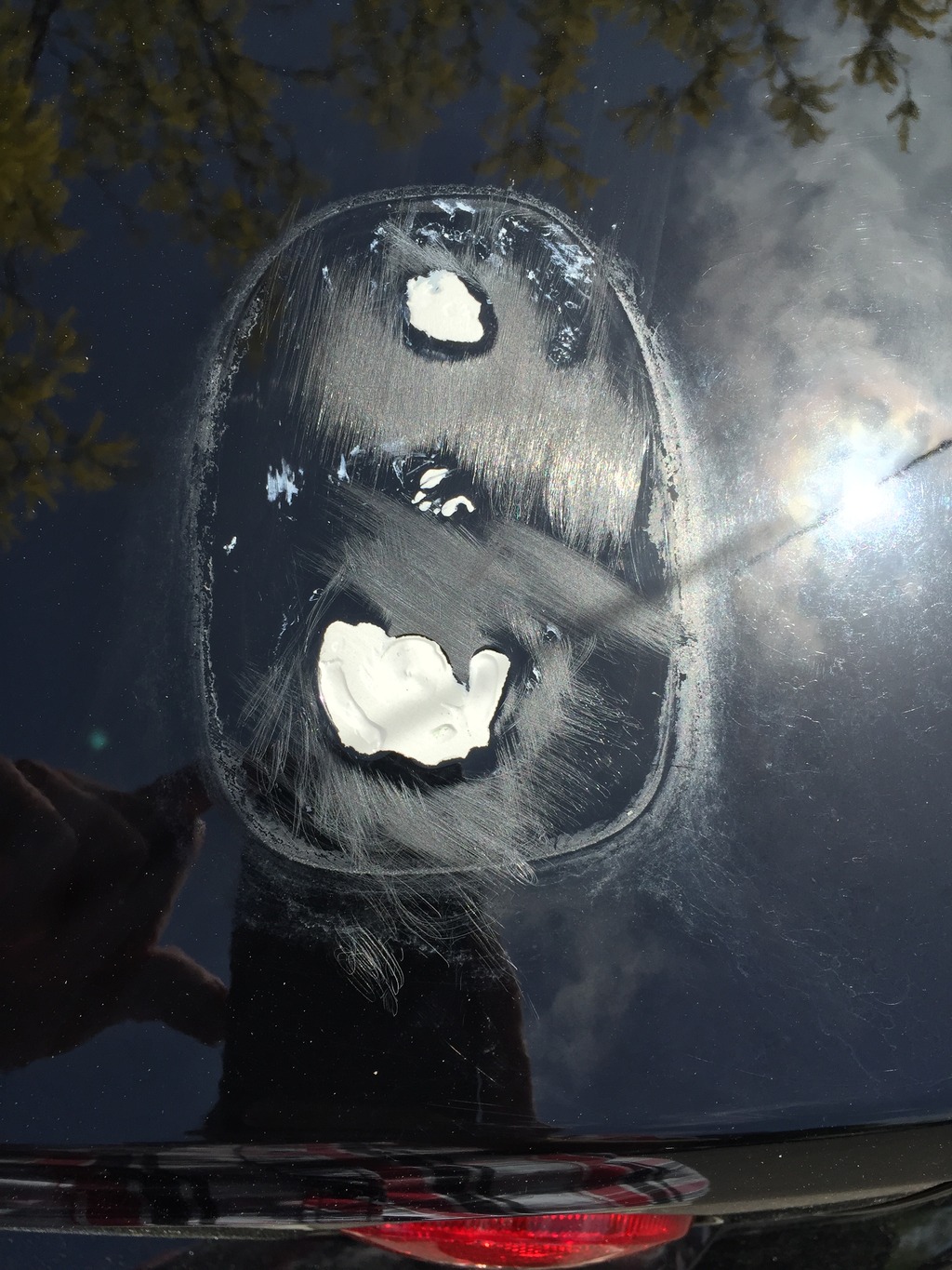

Originally Posted by random_letters
Pics?
Old May 4, 2015 | 03:41 PM
random_letters's Avatar
Joined: 06-25-14
Posts: 95
From: Mississauga
looks like you should still be ok. *edit... is that bare metal next to the top hole or just the reflection from the sun?*
sand down just the bondo now (800 grit)... nothing else until it is just under the height of the stock paint.
stick some short hair bondo on the underside of the current bondo.
mask off the scratched section.
wash the masked area with dish soap
clay bar it
spray a few coats of gloss black and clear in the masked area
unmask the trunk
wet sand the entire trunk lid with 2000 grit wet sandpaper.
polish
should turn out ok.
or...
make everything nice and straight
spray the entire trunk satin black.
clay bar it
unmask the trunk
polish
should turn out ok.
or...
The latter sounds soooooo much easier haha. So 800 Grit on the affected section then cover the trunk so that only the scratched area is bare and wash it then clay bar it and spray it? Could I use the Touch Up Paint? Then Wet Sand?
Old May 4, 2015 | 03:58 PM
exninja's Avatar
Joined: 02-20-09
Posts: 6,268
Likes: 419
From: UT
I don't think it matters if it's touch up or not, it's just going to be a lot of touch up paint.
If you do the masking method it'll probably end up looking ok except I don't see a way to possibly do it without some noticeable lines where you masked. The only way to prevent that is to paint the whole trunk lid. And if you go the whole lid route then be sure to surface prep properly or your paint will look awful in a matter of months.

Why should I sand down the entire trunk with 2000 grit?
Old May 4, 2015 | 04:48 PM
WVU_SS's Avatar
Joined: 04-14-10
Posts: 1,272
Likes: 9
From: Columbus
Because sanding it with anything less than that will give you scratches. Sanding the entire trunk will allow everything to blend and transition from the fresh section to the old section.

I THINK it's the reflection of the sun. It should be. I didn't sand that hard at all.
Just bought some 800 and 2000 Grit paper, Meguiar's Rubbing Compound, some Polishing/Waxing rags and my Touch Up paint. My last questions.....how do I not rip the clear coat off on the 2000 grit trunk sanding?
Old May 4, 2015 | 06:52 PM
Joined: 06-25-14
Posts: 95
From: Mississauga
If you do it right you should have a 2 foot or better trunk.
The idea is to take the top layer of clear off.
Wet sand until the paint is a light haze. It doesnt take much.
Go over the entire lid. Wipe it dry, go over any areas still glossy.
Do not push on the sandpaper, just use the weight of your hand.
Old May 4, 2015 | 07:00 PM
