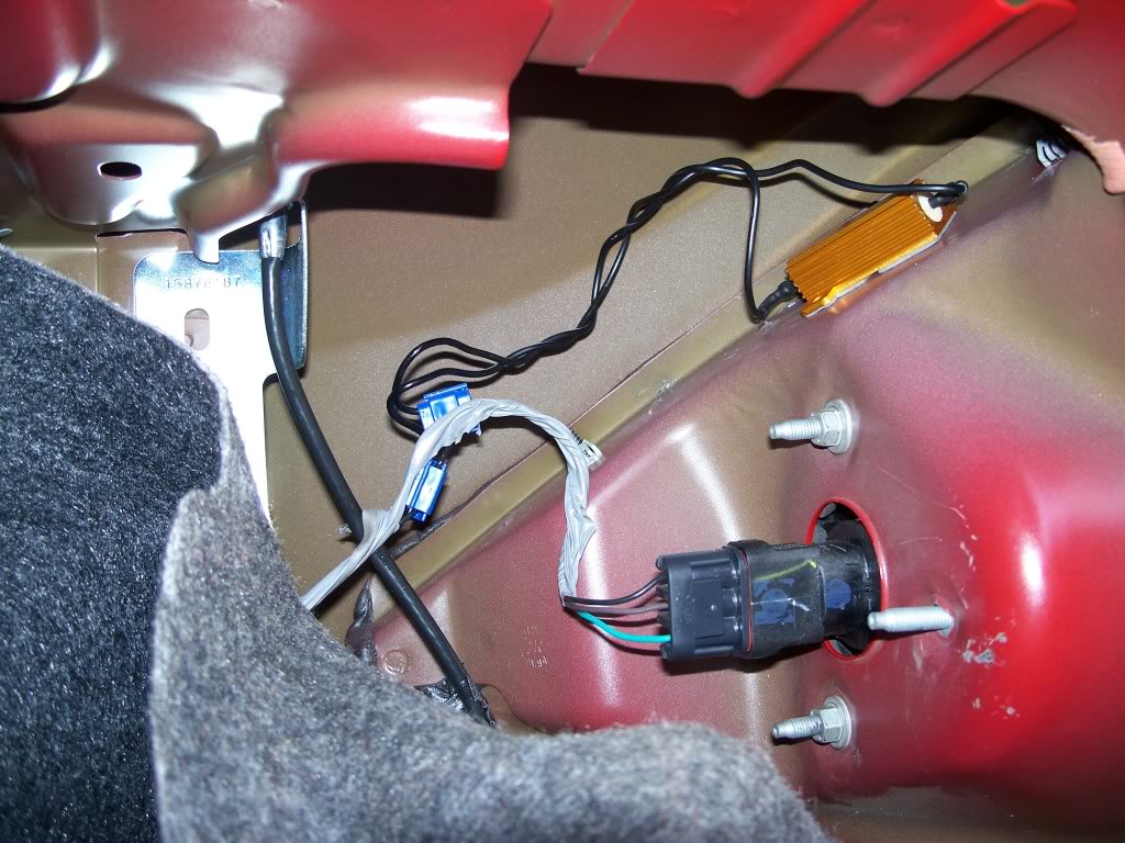

I got mine from Superbrightleds.com
Mounted them behind the carpet piece on the inside of the quarter panel. They get warm but not hot. Radio shack also has resistors.
Mounted them with double face tape. Tucked out of site and work great.

My resistors get hot as hell. Use 3M tape and mount them where the guy did in the picture.

I had originally tried to secure my resistors with double sided tape but sometime within the first week they got so hot they melted the tape and then proceeded to melt a hole through my carpet lining on both sides, i was super pissed. After that i screwed them in to the metal with a self tapping screw and that did the trick. Speaking of these tail lights though, i had to go back to stock today unfortunately because the plastic clips that hold the reverse lights in place broke off (probly from hitting a hard bump or rail road tracks or something). I had them for about 1.5 years.
