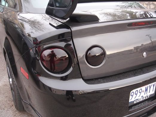

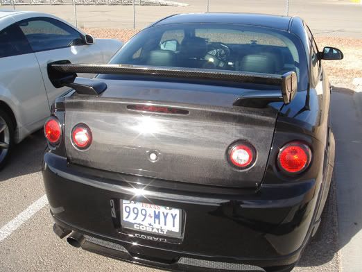

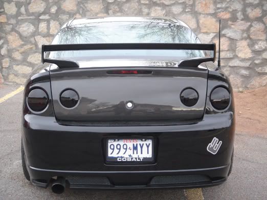

Well i just nightshaded my tail lights and i must say that im pretty happy with the results... heres some pics
Before:

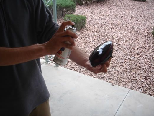

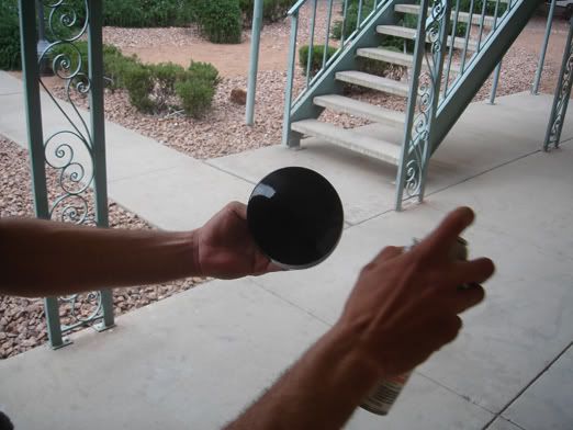

During:
applying clear coat

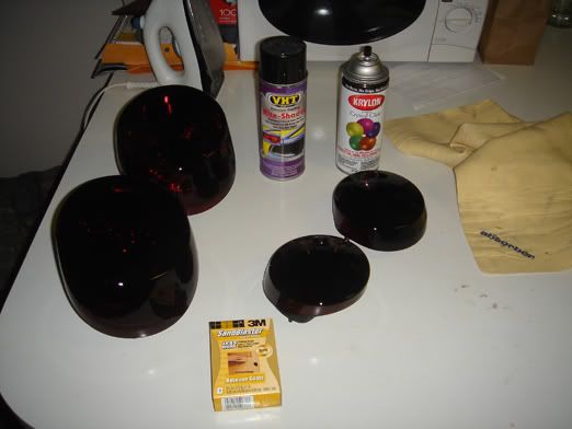

Everything needed and the completed product:
VHT Nightshade
Krylon (doesnt have to be but i used it) crystal clear
Fiberless rag (i used the absorber
Fine grade sandpaper (i used the 3M 350 grit sandsponge)
and a dumb room mate willing to hold and spray
And after sanding the tail lights, applying 4 coats of nightshade, then 5 coats of clear coat, sanding imperfections, and reapplying 3 more coats of clear coat, this was my final result:
damn its sexy

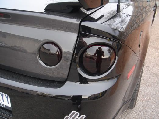

in the closer pics you can see that arent TOO dark. i didnt go crazy, just enough to look nice and black from a distance. now i just need my windows tinted and my blackout is complete oh and the cop thing, well luckily my neighbor here at the apartments is a friend of mine.. and a local cop
here are more pics as requested

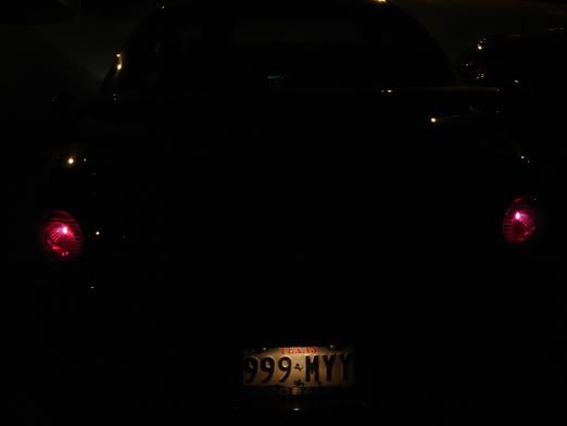

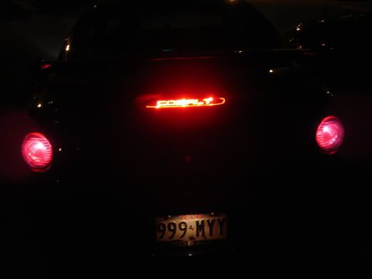

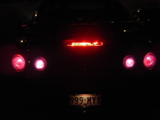

and as requested, night time pics
regular
with break lights
reverse lights
corner lamp
yeah it pretty much makes the reverse lights useless, but i dont use them anyway.
and the tail lights are a bit brighter than what you see. guess it doesnt come out well on camera
