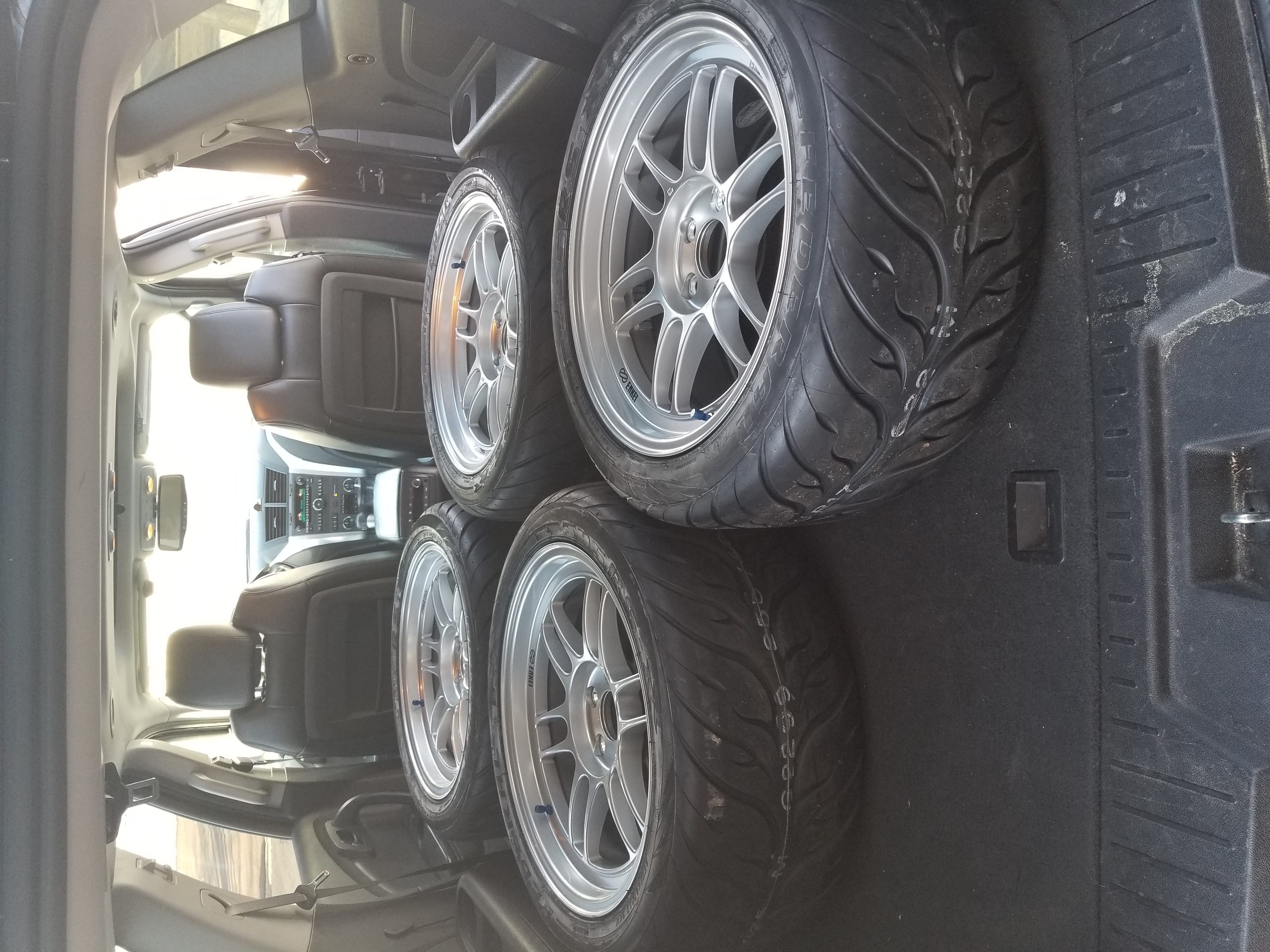

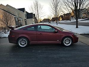

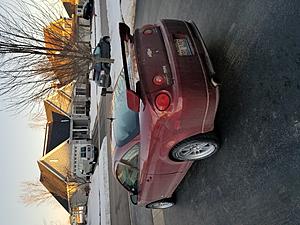

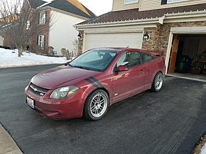

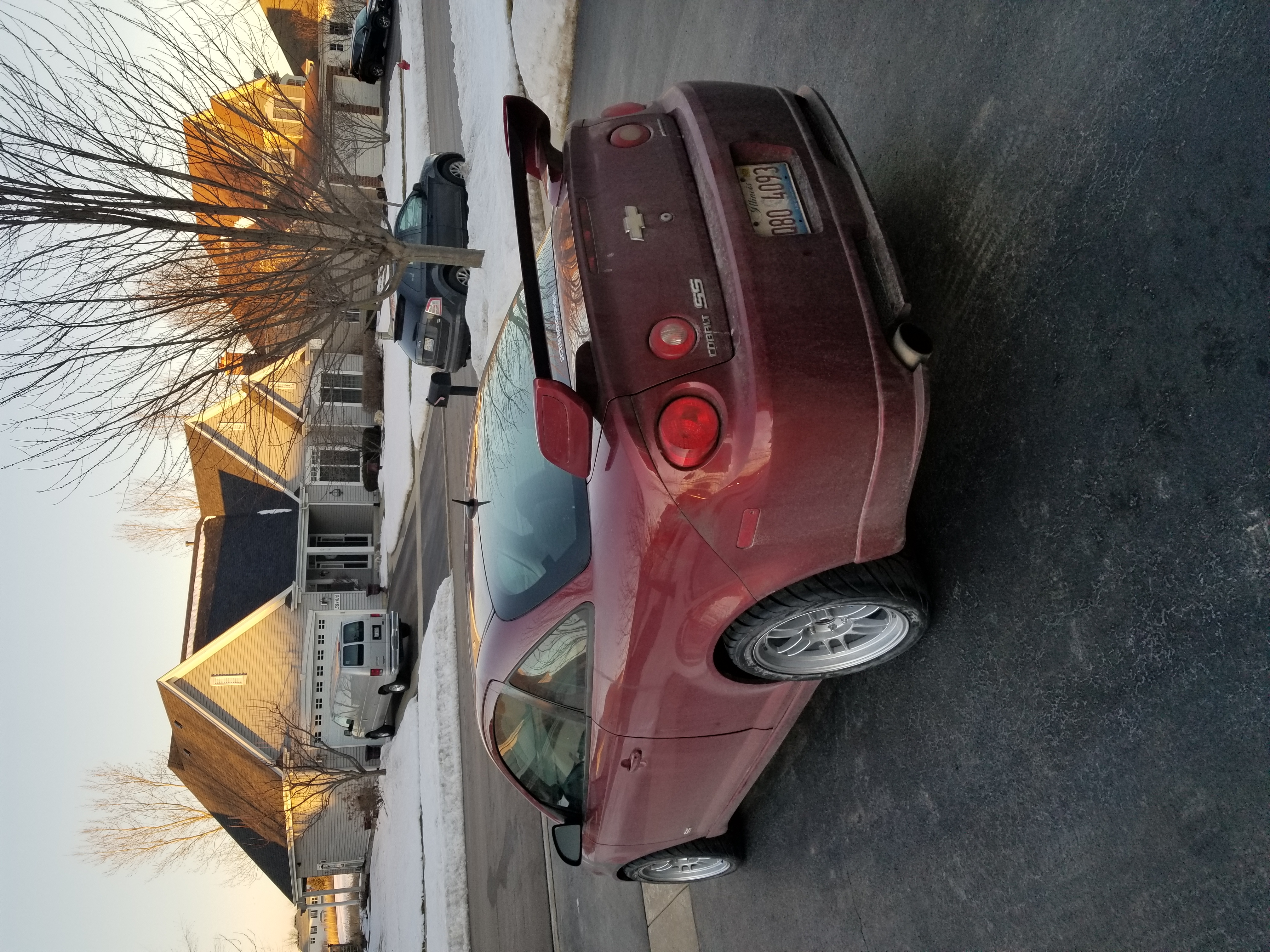

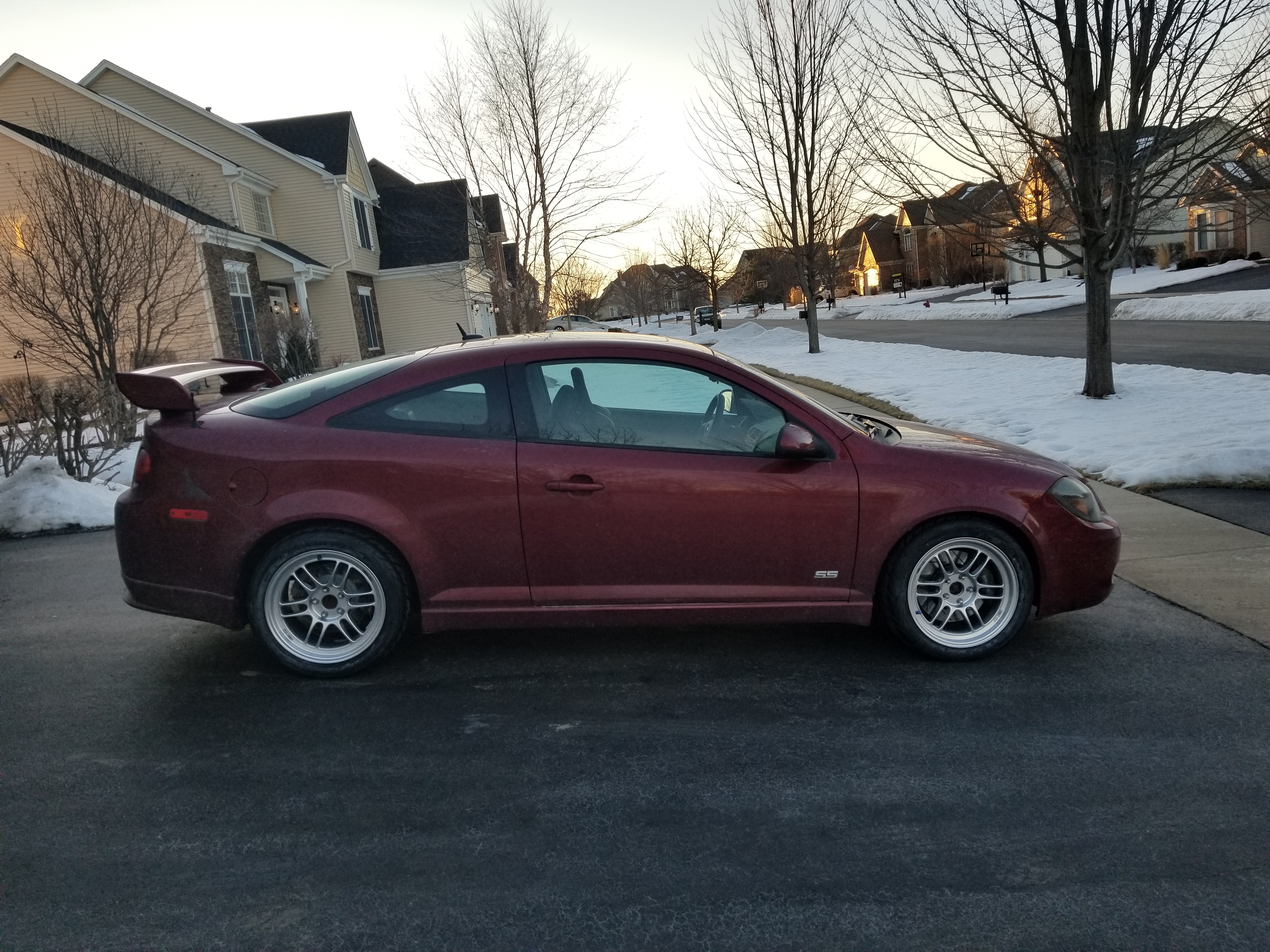

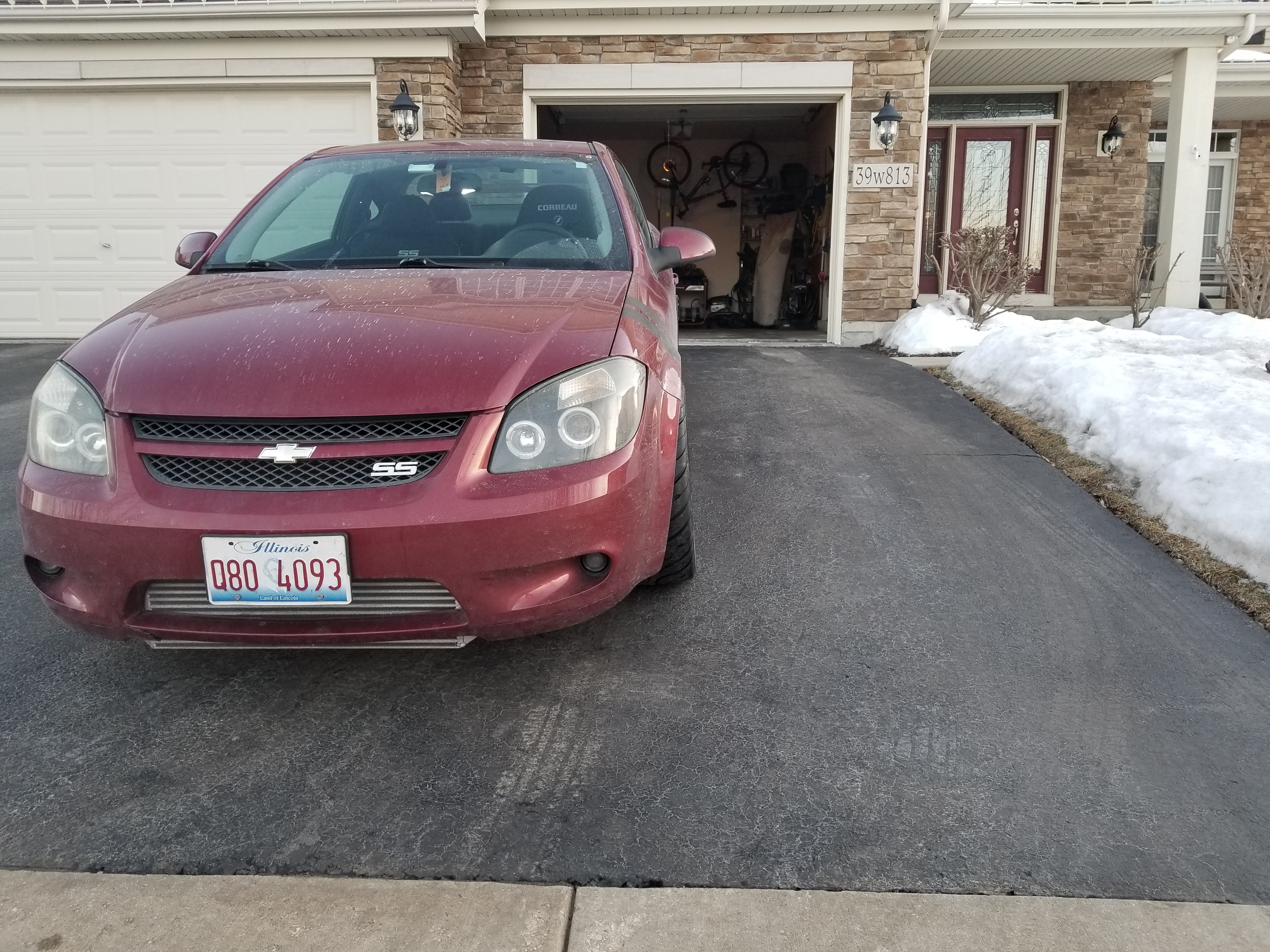

Just mounted my new wheels and tires for the upcoming autocross season. 17x9 +35 rpf1 that were orginally 5x112. Filled and redrilled by a machine shop so they are now 5x110. Tires are 255 40 17. I use the car for STX, thought some people might be interested in seeing this.

Bore match the oem sized hub?

Nah, but they're 73.1 so I just use hub rings

Nice job getting 255's to fit. Looks good

Keep a eye on your rear tires rubbing on fenders on some harsh bumps on road my 255's nitto nt05 get into it in those harsh areas

Awesome man. What camber are you running up front? If -2 degrees or more what did you use to get there?

I've got -3.2 degrees on both sides. I'm just using eibach camber bolts

Think those are any different from the Ingells camber bolts on turbotechracing.com?

I'm sure it's the same kinda design but I don't know if you'd be able to get the same amount of camber out of those. I think the eibach ones say you can only get -2 but I have over 3 and I'm not even maxed out. I bet I could get -7 if I had coilovers lol.
