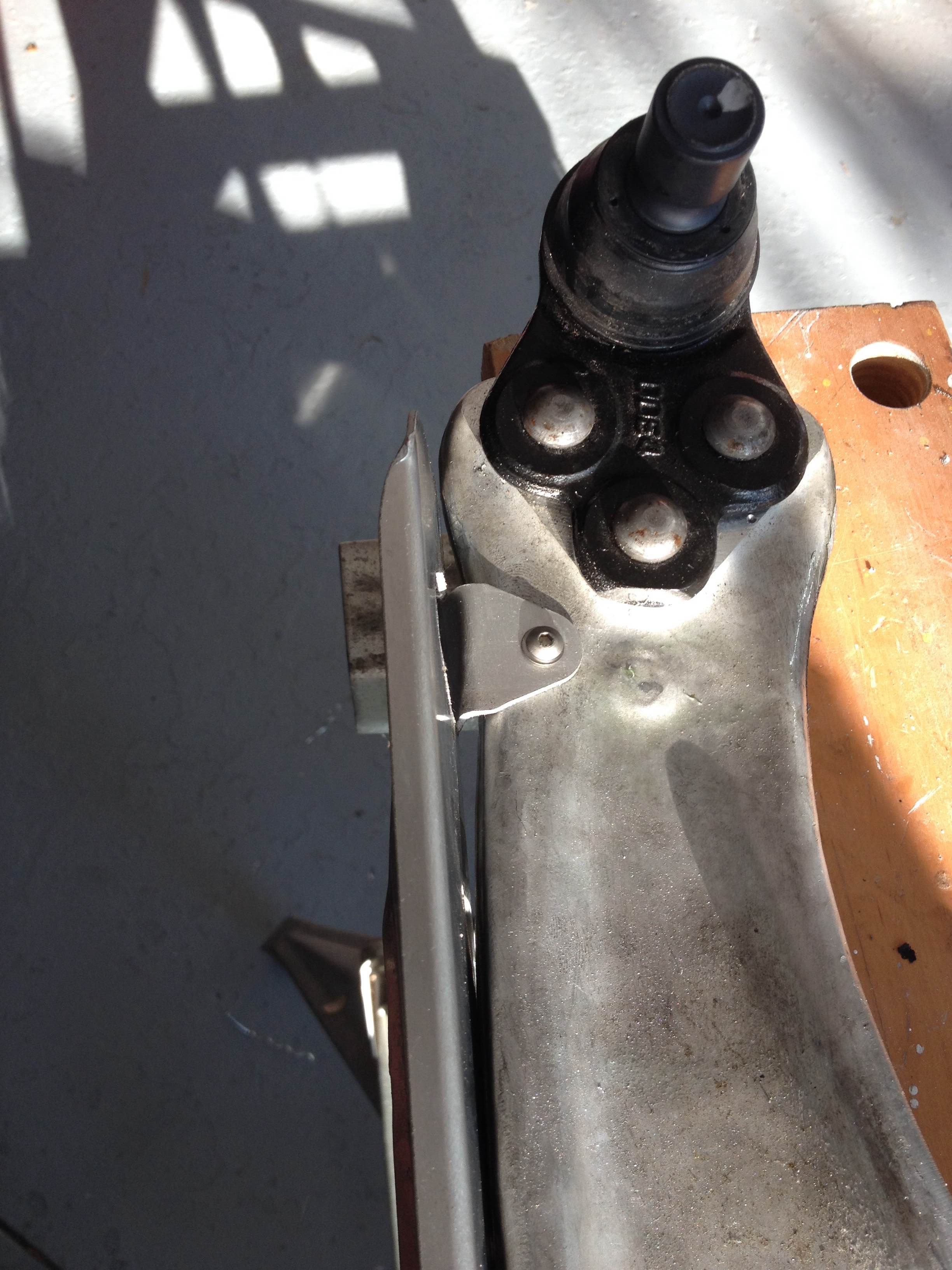

Since this thread was all that came up when I searched for brake ducts, thought I'd post the pic of Powell's brake ducts kit for future generations

Brake Ducts
where do those mount?

On the control arms. I'm putting mine on today and will post pics. Here's a pic from Powell:

Old Sep 5, 2015 | 05:52 PM
LNFTX's Avatar
Joined: 03-12-11
Posts: 1,796
From: TEXAS
Brake Ducts
That is sweet
Its so simple

I have these air deflectors from John Powell and they work fine!
