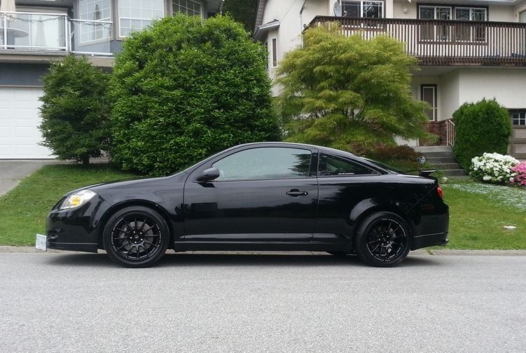

Here's a quick pic of the car, just mounted some cheap rs3's because cheap and wide 255/40. They poke hard in the back.. but barelllllly rub just a lil on v3's.

RS3's may be the cheapest tire in the extreme performance category, but they are one of the best. As a bonus, they are one of the longest lasting as well.
That looks great. After some testing by tape my Direzza's rub even with only me in the car. I will doing an extremely minor fender roll in the upcoming week or two.
