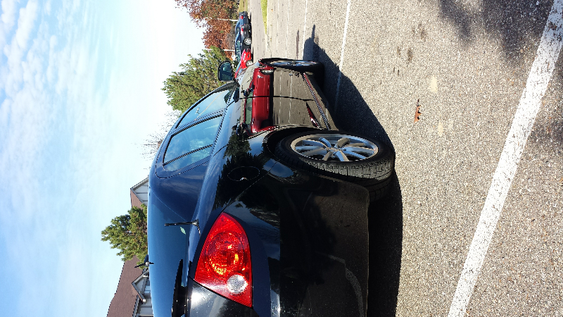

I have owned this car for couple months, it runs and drives fine but with no boost at all. It needs a Re tune, it's throwing p0101 and low boost codes or(under boost) it really is a pain in my butt I thought I could fix it and I couldn't. I don't feel like getting the car tuned so im offering to someone else a low mile Lnf that needs some love. Doesn't have a front lip has scratches and blemishes. No sunroof heard that it is rare to not have one in a sedan... I'm looking to get 11k but definitely negotiable. If you have any questions feel free to Hmu 8104171305.
