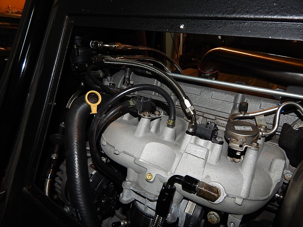

Switched over to a Powell V3 separator, thanks to John for all his help.
Old Feb 3, 2016 | 09:35 PM

Very nice. Do I see an air to water cooler?
Yup a Precision P500

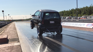

Update ran a 10.91 @127mph
