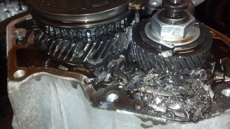

Update:
PM's and E-mails sent to Powell and FMSR, I got the trans tore apart, possibly I will attache a pic here, and it turns out I can't find individual replacement parts anywhere, gm list 5th gear as "un-servicable"

holy ****. how did you manage that?
Old Jan 3, 2014 | 05:34 PM
Yeah, how'd you break 5th?
Old Jan 4, 2014 | 11:52 AM
DualSpoolinSS's's Avatar
Joined: 09-11-11
Posts: 68
From: North Carolina
no idea really I was on the interstate just normal driving and all of the sudden I heard a small pop and looked down and it was coming off of red line. I had been driving for a little over an hr in 5th so idk if there was some kind of oiling or cooling problem?

lol I dont know what it is with 5th gear both saab and cobalt are breaking them suddenly. Must be the polar vortex. dual spoolin' you emailed me right?
I wonder looking if the peened nut broke a tab off and dropped into the mesh ? The saab one I know of was rebuilt, but asted 150 miles. its hard to get the fifth gears on sometimes and if you hammer on them they get cracked.
gonzo later
and 10 -4 5th gear is not serviced. its retarded. new second gears are 700 bux. etc. its a hard life.

Yes, I emailed you, I assumed the nut damage was due to the gear break not the other way around, I will have the old trans in hand this weekend and can take a better look at it, or send you the box and let you take a look at it.

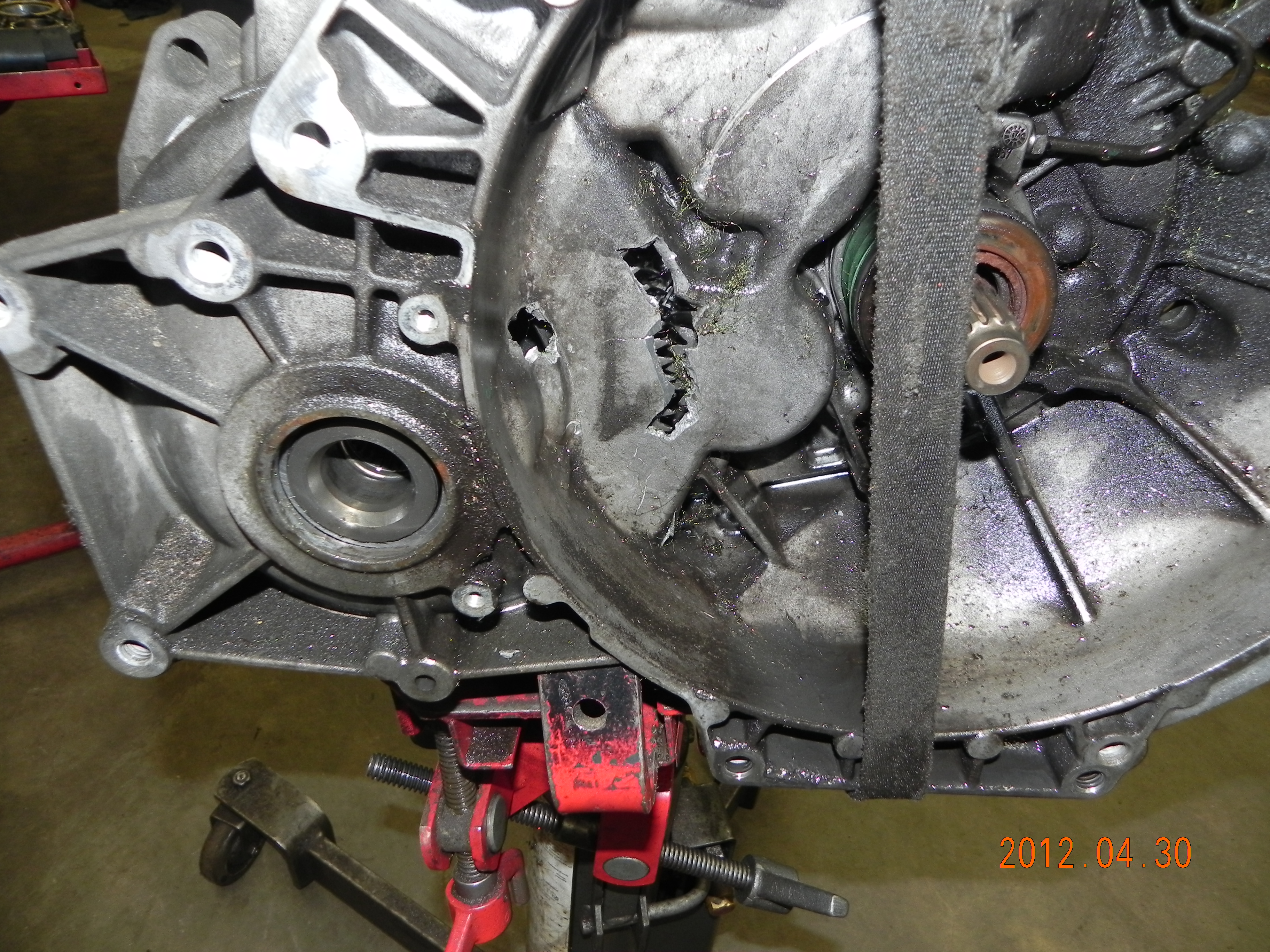

No it was completely OEM. 37K miles. Looked like this:

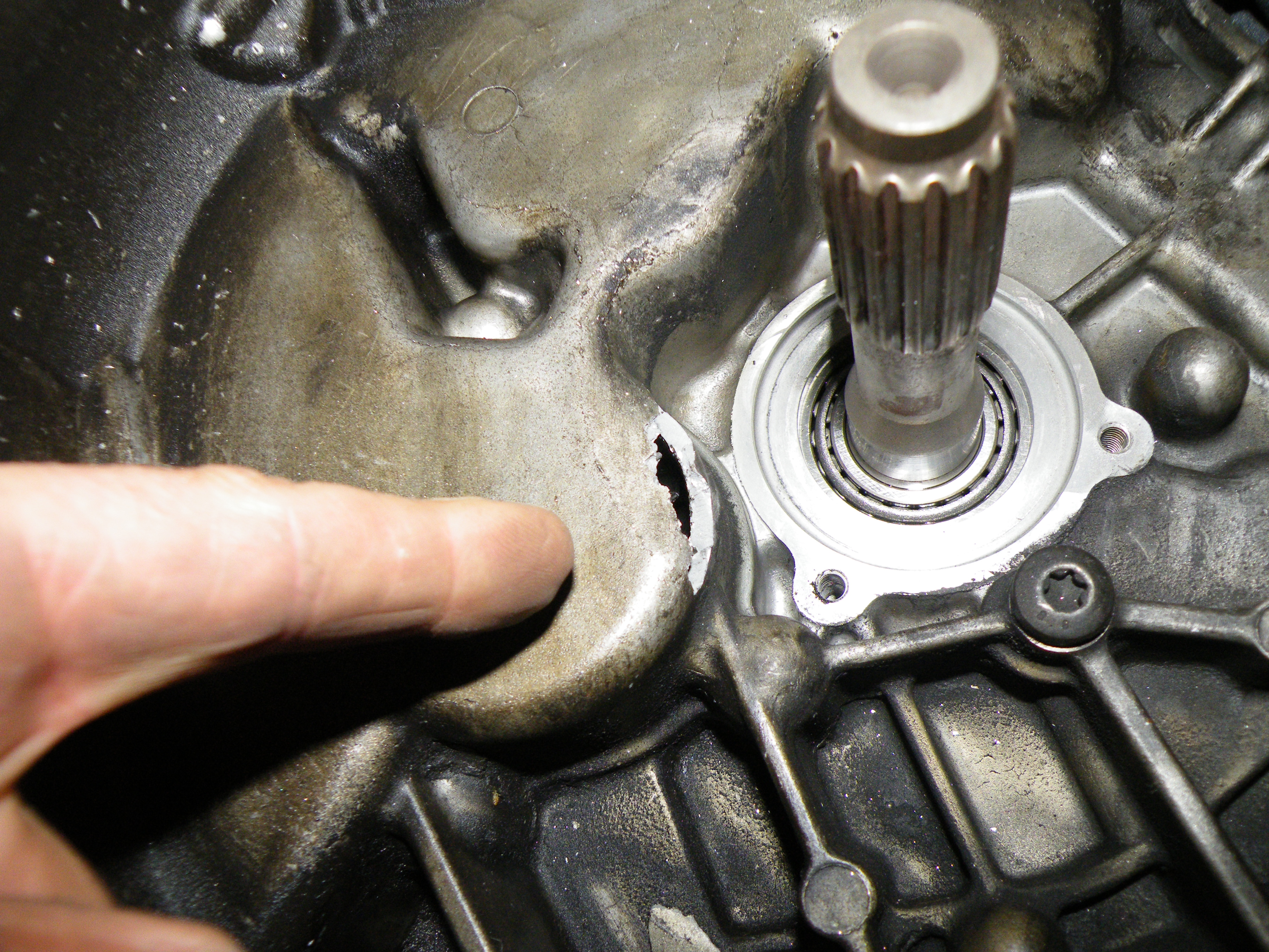

not like this?
or this
