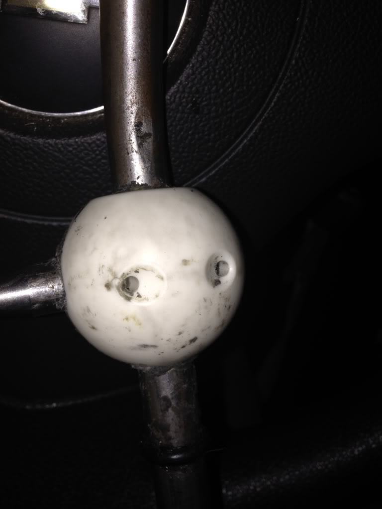

ok so here we go, because the new shifter does not have these holes....
it now, does this...

Old Nov 2, 2013 | 10:22 AM
AHelm3's Avatar
Joined: 10-26-12
Posts: 1,157
Likes: 15
From: Pittsburgh, PA
Took my boot off and investigated a little. Without completely tearing mine apart, the only thing I can think of is maybe that grey plastic sleeve/bushing/whatever it is may be worn. Maybe pop that out and have a look at it

Old Nov 2, 2013 | 11:14 AM
qwank's Avatar
Joined: 10-19-12
Posts: 420
From: Southern NH
all those holes are for is if your are having the car towed, you push the U clip into them to keep the car in neutral
my stock Cavalier shifter did the same thing, I think you're missing an o ring or something between the top of the pivot ball and the retainer ring

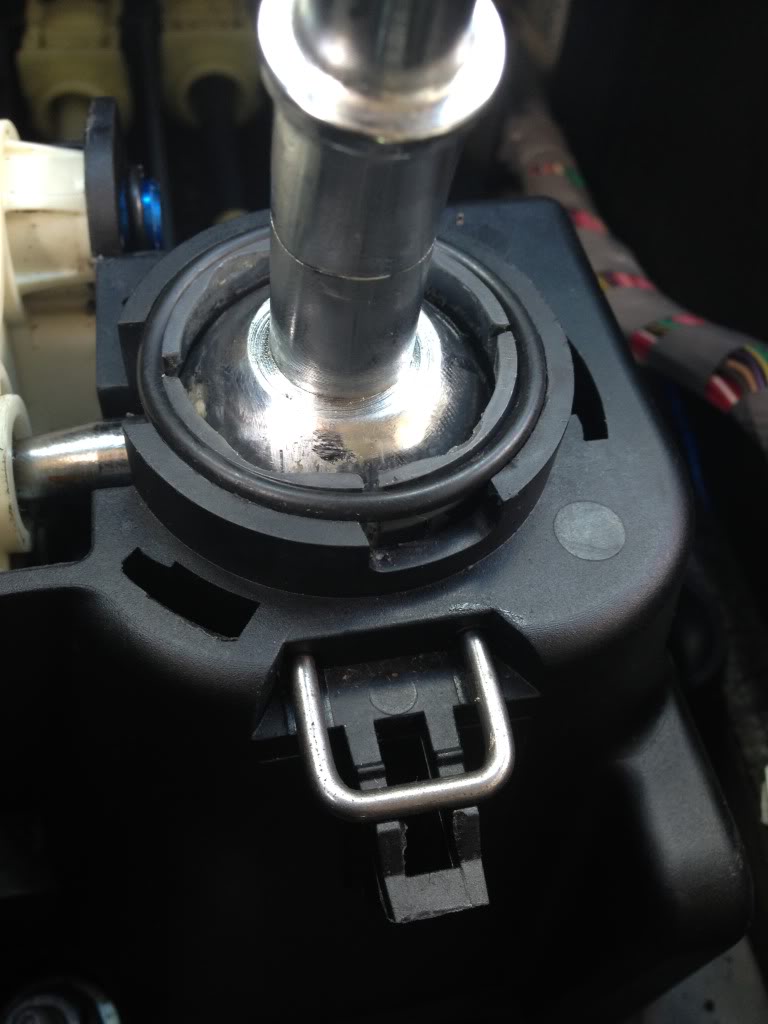

also, could you give me a link to the j-body forums? not quite sure what you're referring to. lol

Old Nov 2, 2013 | 03:44 PM
AHelm3's Avatar
Joined: 10-26-12
Posts: 1,157
Likes: 15
Ralco Rz Short Shifter - Interior Forum - j-body.org - The J-Body Organization
